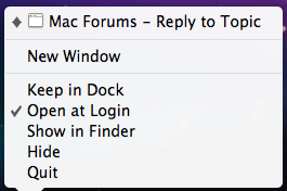

After launching Safari and having it appear in the Dock, albeit temporarily, click and hold down on its Dock icon until it shows the context menu where you can select "Keep in Dock." Then drag Safari to the desired position in the Dock.
