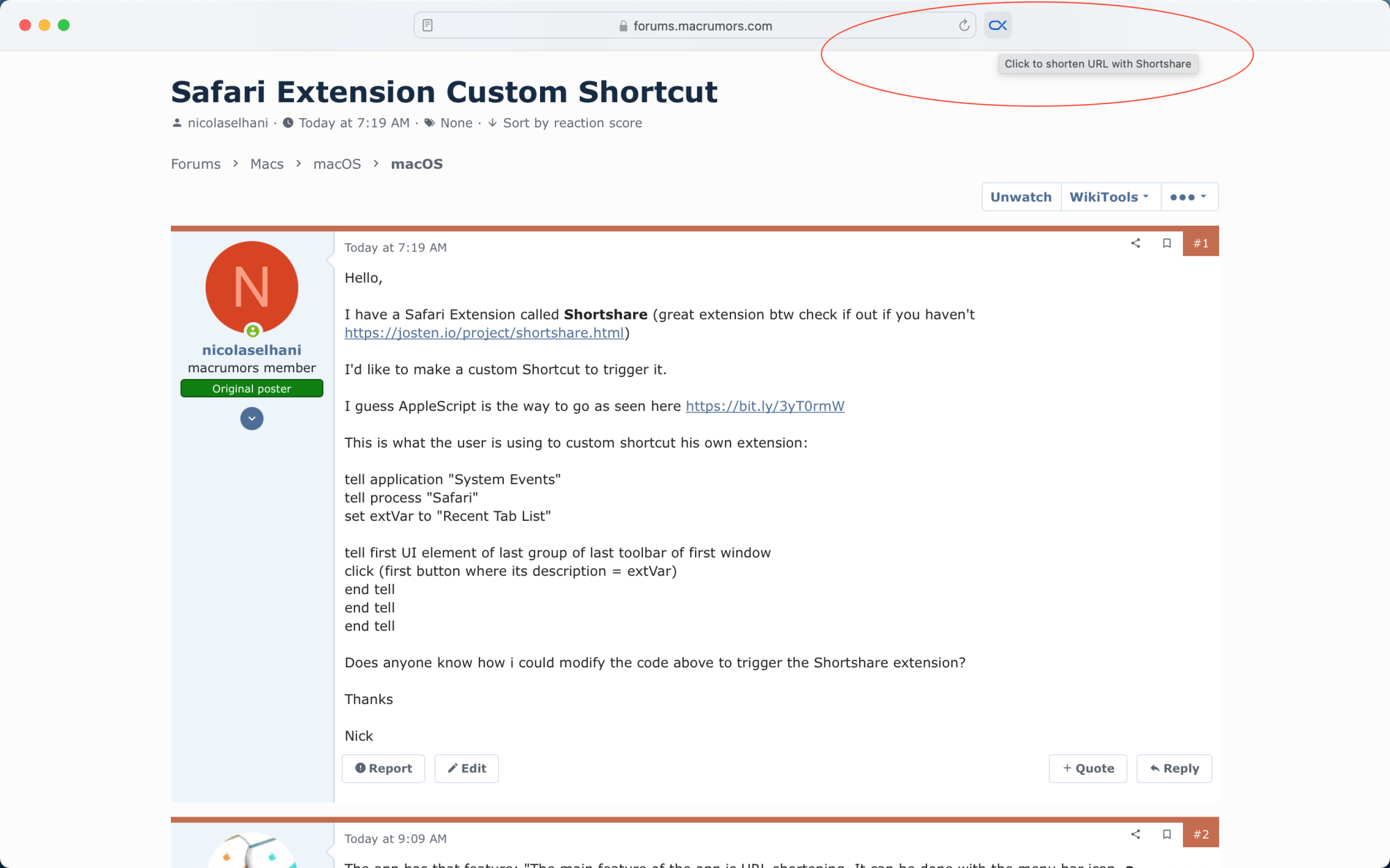

Hello,
I have a Safari Extension called Shortshare (great extension btw check if out if you haven't https://josten.io/project/shortshare.html)
I'd like to make a custom Shortcut to trigger it.
I guess AppleScript is the way to go as seen here https://bit.ly/3yT0rmW
This is what the user is using to custom shortcut his own extension:
tell application "System Events"
tell process "Safari"
set extVar to "Recent Tab List"
tell first UI element of last group of last toolbar of first window
click (first button where its description = extVar)
end tell
end tell
end tell
Does anyone know how i could modify the code above to trigger the Shortshare extension?
Thanks
Nick

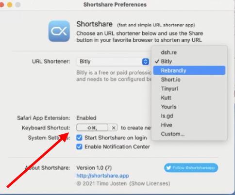

The app has that feature: "The main feature of the app is URL shortening. It can be done with the menu bar icon, a keyboard shortcut,"
Thanks @bogdanw for your reply.
Unfortunately this shortcut button:
1. needs to have the main app (not the extension) open in the background
2. it opens an on-screen box with the prefilled URL that you have to manually copy and then you have to manually click on "Shorten Link" so it's 4 total steps vs. 1 for the potential shortcut I'm looking for in AppleScript
I reached out to the developer to ask if he can integrate a shortcut that mimicks just that one-click button in the toolbar, but in the meantime if anyone knows how to AppleScript it or have hints that would be great!
Thanks again
