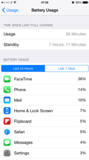

Since couple of days ago my battery seems to drain bit faster compared to last week. I notice that safari usage is high on battery usage statistics. on the 24hrs tab it shows 30% and I didn't use it that much. To be honest I used flipboard, facetime & tapatalk most of the time and I probably have used safari for not more than 5 minutes during the last 24hrs. I haven't opened tabs on safari either and it's not running in the background. Has this happened to anyone before?

I think I found what's causing it. It's the iCloud safari sync. I turned it off and after few hours it went straight to 5% 😀

I haven't taken a screen shot of it but there is a clear difference having it turned off. Day Yesterday over night it drained 15% battery after a full charge and this morning I noticed that the battery is at 99% over night.
