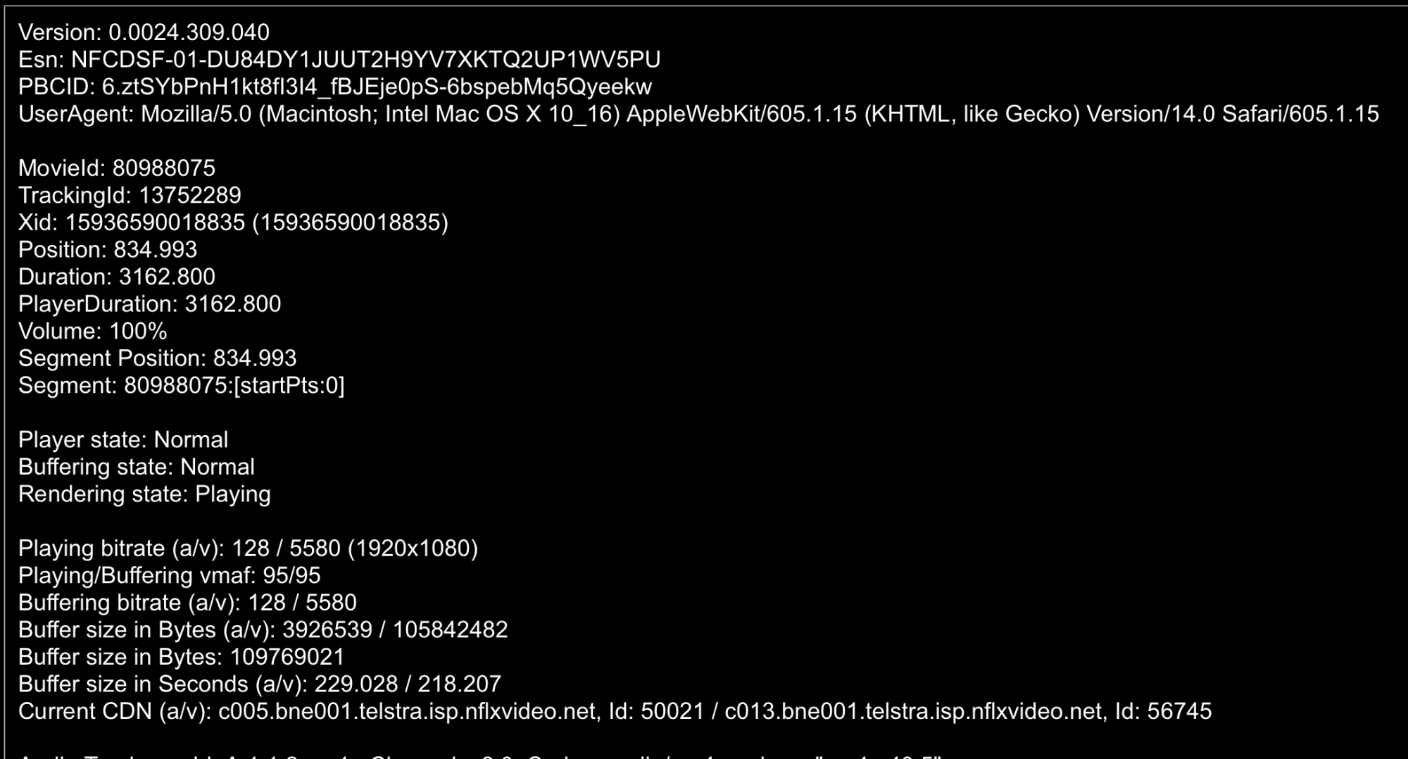

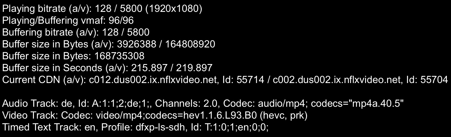

Curiosity got the best of me so I decided to upgrade to UHD Netflix plan to test if it would work on my rMBP 2017 (also test some HDR videos on my iPhone Xs) even though I didn't think it would. So as I expected, I only get up to 1080p streams but apparently I can receive 8-bit HEVC 1080p streams (Dark S01E09) with bitrate of 5800 now. I didn't test if I could get a HEVC 1080p stream using my Standart Netflix plan so this might not be a new addition. However, this still feels like a welcome addition compared to AVCHIGH streams thanks to additional compression efficiency even though max bitrate seems to be around the same ~5800 kbps.
