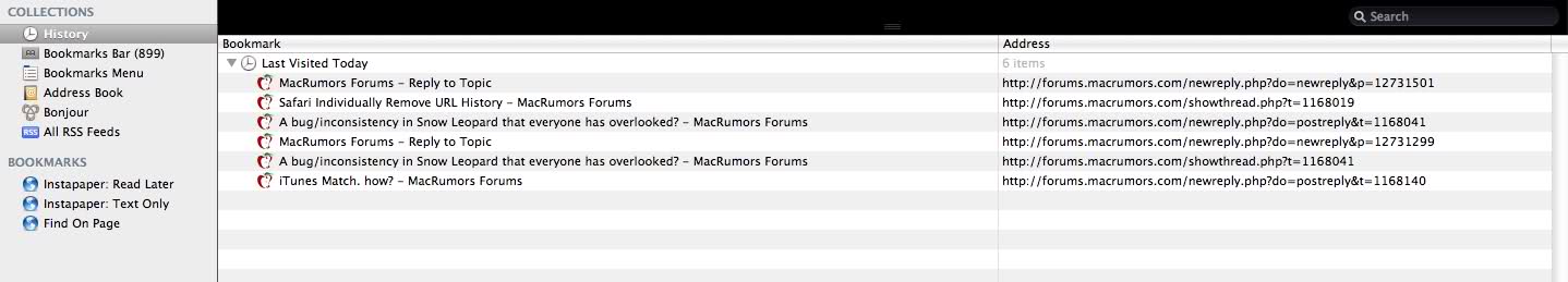

Hmmm. Works for me, on 10.7. Be sure that you're editing your history on a screen that looks like this:

If you, like me, had full window coverflow, try dragging up from the little innocuous handle on the bottom.
Then you should see the table view, and be able to delete your history item.
