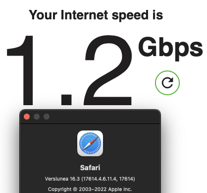

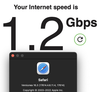

For me it was the Private Relay. When "off", testing fast.com on Safari went up to 500Mbps. Thanks for all the people that helped in this thread.
