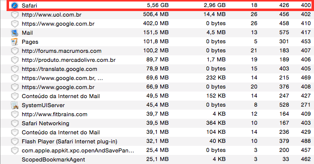

The problem is that the memory amount is allocated to "Safari". If you add up the memory of the tabs, the allocated memory value is much lower.
Hi @megalaser
That really looks like Safari's causing the RAM issue. There's gotta be a memory leak somewhere. Do all your tabs auto reopen? If they do then keep pressing Cmd+W until all windows are closed, then Cmd+Q to close Safari. Then restart the computer & open Safari again.
Also is Safari up-to-date?
If the above steps do nothing, it may be best to briefly try a different Internet browser to at least confirm if it's doing it on the other ones. If it is then it could possibly be a frequently visited site that has some horrible scripts runnning ... how many tabs do you normally run?
Yes, my tabs auto reopen. But when this happens, the allocated memory is low.

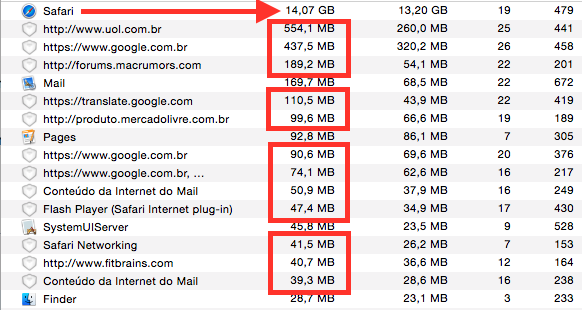

5 or 7 tabs. But it is strange that the memory allocated to each site (tab) is low, compared with what appears related to the "Safari"
I've Firefox and Chrome, but I prefer Safari. This problem doesn't happen with other browsers.
Okay, we've at least identified that the problem is isolated to Safari. So a few quick questions about your computer:

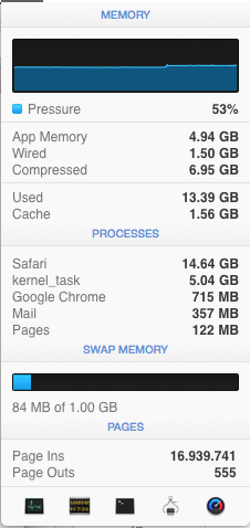

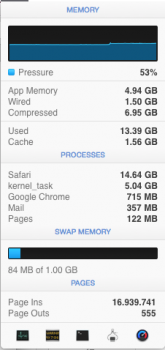

uncheck preload top hits as you can see on istat i use 1.2 gig n free 6.79 ii hade the same problem try it

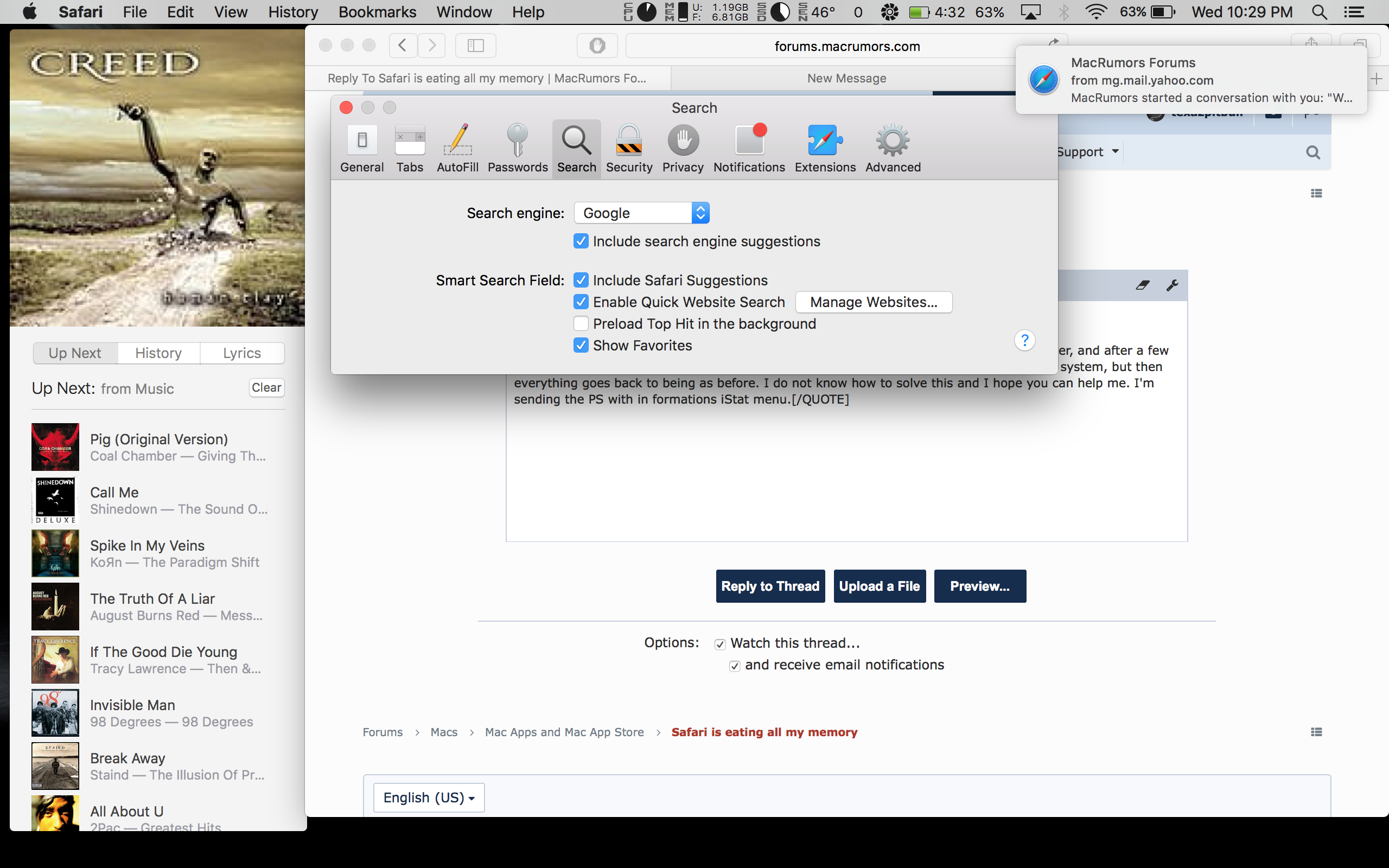

all you have to do uncheck preload top hit pages

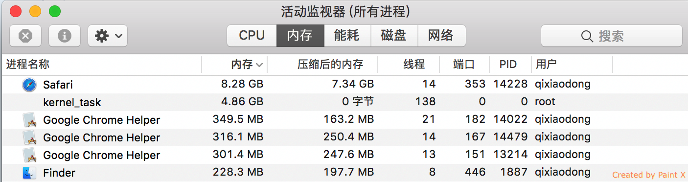

I just sign up this forum to talk on this issue. I had the same problem and the memory Safari occupy more than 10 G some times. After uncheck preload top hit pages inside Safari configuration, at beginning the memory of Safari occupy around 100M, and then it grows constantly, 1G, 2G, ..., so uncheck preload top hit pages does not work with my iMac and Safari.

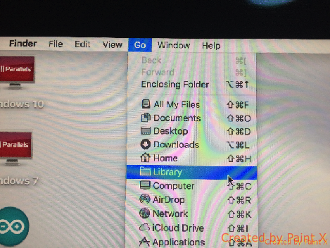

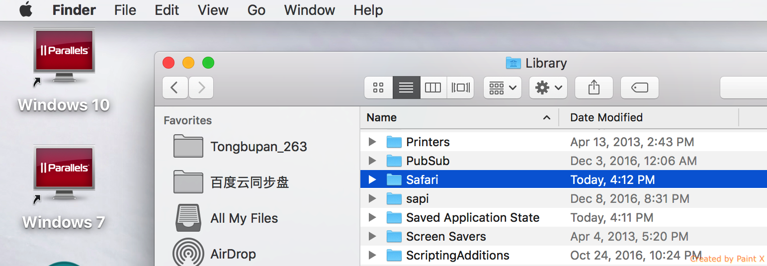

[doublepost=1482655711][/doublepost]I called to the apple service and finally solved this issue. Their way is to delete the old Safari and install a new one. Here is how :
(1) Open the "Finder"
(2) While pressing "Option" key, click "go" inside the Finder menu, then one item called "Library" will appear
(3) Click the "Library"
(4) Then a lot of folders will appear, find the folder named "Safari" and drop it into Rubbish bin. (Delete the Safari APP)
(5) Click "Safari" on the dock bar to run Safari.
This really solved the "Safari eat to much memory, some times 8G memory" problem.
But all the configuration along with the old Safari, like your bookmark, etc. will also be deleted. After the steps above, you will get a totally new Safari. So if you need to keep some thing useful, firstly do some records and backup, then follow the steps above.
