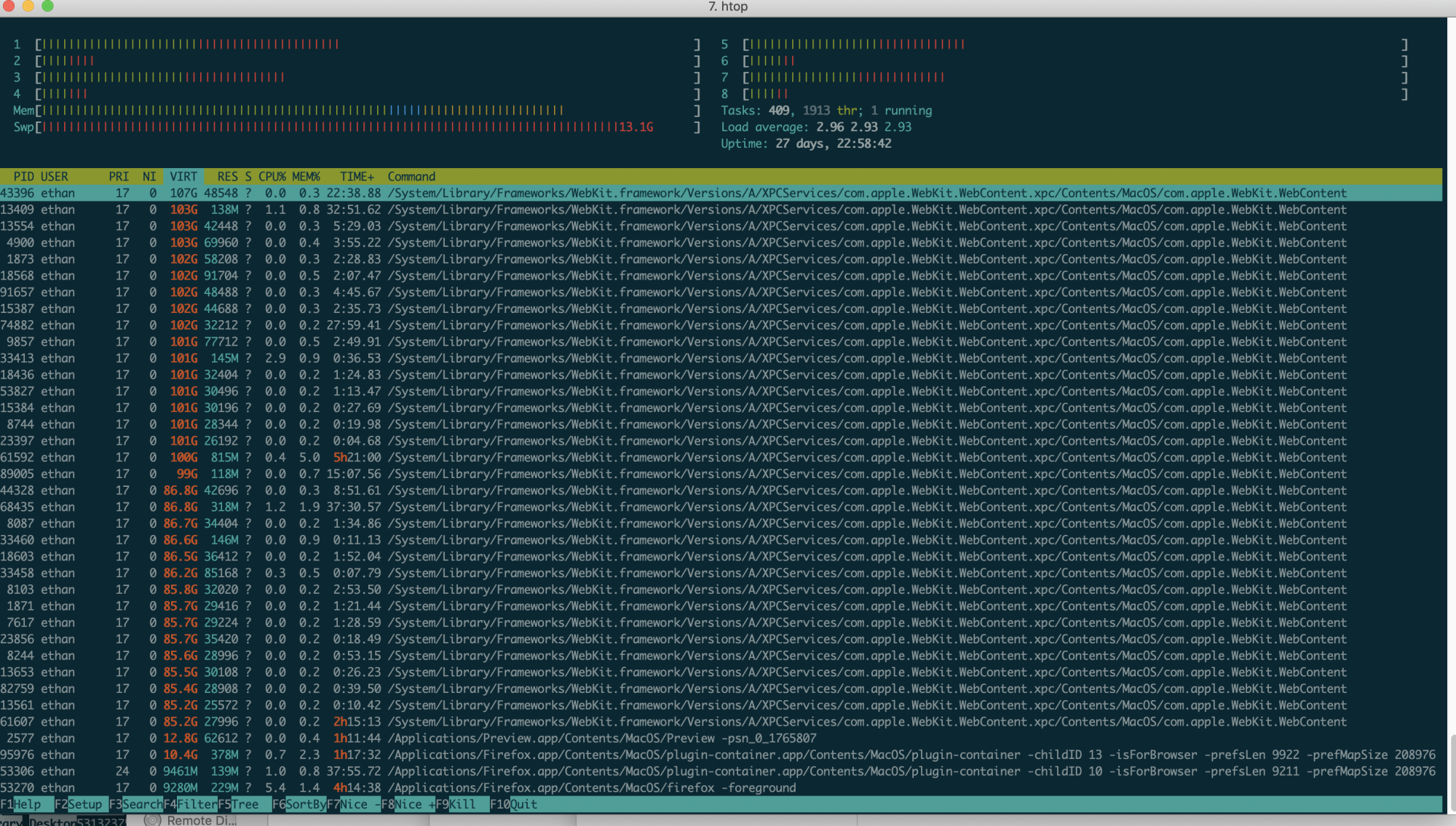

I have a 2017 macbook pro running 10.14. I realized recently that kernal-task is writing terabytes into my hardrive every week. I just found out from htop (see screenshot) that the culprit seems to be safari, which is taking 100G of virtual memory per window. It's terrible and has been killing my hardrive silently for, probably, almost a year since I installed Mojave, which I suppose amount to 50-100Tb total writes. This cannot actually be normal, right? The fact that terabytes of VM is possible for the OS to allow without any warning is just outrageous. If it is there fault, is there any way to hold Apple accountable for it since it might have siginificantly shortened the lifespan of my harddrive (btw there is a bit of AppleCare+ left)? Thanks!

If I understand right, VIRT is memory accessible, etc. RES is what you want to check to see what's actually being used.
Reactions: mick2
VIRT shows everything that is memory mapped by the process in question. That's the app, its referenced libs, its data, the process heap etc etc. It's not actual memory consumed. And its definitely not swap space used, which seems to be what you're concerned about.
According to your screengrab, you were using 13.1Gb of swap space when it was taken.
Running top with the -m switch will display USED instead of VIRT memory, which may be closer to what you're looking for.
So the VIRT used by Safari is indeed normal? I don't see any other process using that much.
In any case, I calculated now that the computer is writing on average 200G a day over the past month. I opened say around 30 total safari tabs and is otherwise not doing much myself to the disk, is that really normal? If so I might need to stop opening so many tabs...
No idea what's 'normal' for Safari - guess it depends on what you're running in those 30 tabs!

MacOS likes to allocate memory it isn't using, and Safari is a Mac program with a reputation for hogging memory, so I'm not too surprised.
What's you daily write calculation based on?
I see in activity monitor, disk usage, of around 5Tb write, and according to htop it has been on for 27 days. I am not exactly a power user, other than keeping quite a few tabs open (but they are mostly just rather mainstream everyday website, nothing crazy). Maybe the usage is normal considering I am using 13G swap (which still sounds like a lot but okay)
