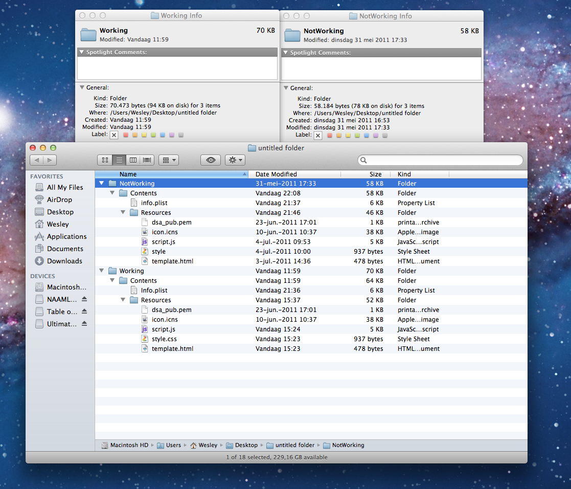

Can anyone tell me how this is possible? The files in these two folders are exactly the same, but the file size reported for the folders is different. Any ideas?

You're right, here's an updated picture with hidden files shown, I'll now check xattr on all files to see if there's anything else:
http://i44.tinypic.com/218ttu.png
(Note after I set to show hidden files the DSstore was created for the other folder too)
