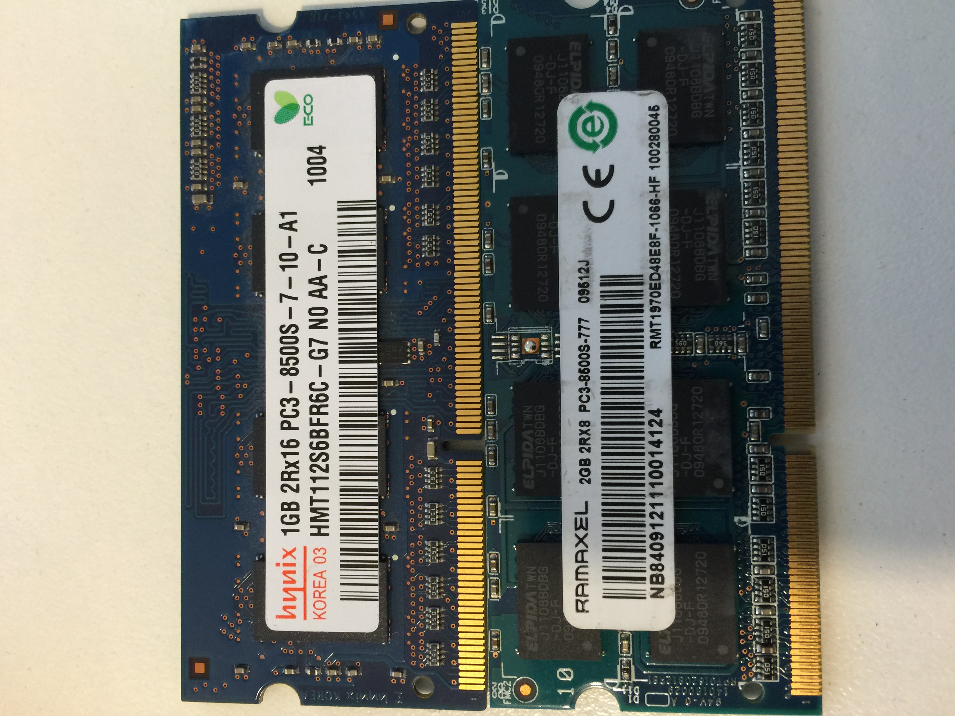

I purchased 2 sticks of RAM from eBay, but they're not working on my '09 MacBook....
The top stick is one of two of my original 1GB. The bottom stick is one of two of the purchased 2GB RAM.
Are they the same?
When I insert the purchased RAM, the MB beeps once every 3-5 seconds. I've tried various combinations with originals and purchased sticks. I've tried one at a time. I've resetted the PRAM. I don't know what else to do.
I've tried talking to the seller, but he's refusing to accept the return cause he had a no return policy on these sticks. So I've escalated this to eBay to make a decision.
So I'm asking here if the sticks that I purchased the same as my original.
Thanks!!

Huh, this is odd. Looking at the stickers they are both the same type of RAM, 1067MHz (PC3-8500S). Your MacBook should be able to handle that size. All I can think of is that something is damaged, the new RAM is bad, the connection is dirty, or the RAM slots are damaged.
Check if there is any dust in the slots. Also you can try cleaning the pins of the new RAM with a cotton swab and some rubbing alcohol or similar.
Have you tried putting in the original RAM? If it does not work then you probably damaged your RAM slots. If it does then something is wrong with the new RAM.

Yeah, sorry. I forgot to mention that the slots are not damaged cause the original RAM still works.
Then its probably bad modules. Admittedly the picture is pretty bad on my phone, but i cant see anything wrong with it specs wise.

I don't see why. The RAM is the exact same type as the original. It should work.
The pins on the new RAM look a little dirty, while the old one is clean. You should clean it, and then maybe it would work.

You could try testing it on another laptop. Late '09 Macbooks like 1067/CL7 RAM. There are high-latency RAM like the Kingston KVR series (cheaper and laggier) which will make your logic board beeps.

I don't know what more you weren't aware, but some Macs prefer low-latency modules. Kingston used to have the KVR (Value) Series and the KTR (better specs). A 2009 Macbook or Mini don't like these KVR modules from what I know, but KTR (or KTA, don't remember) ones will work.

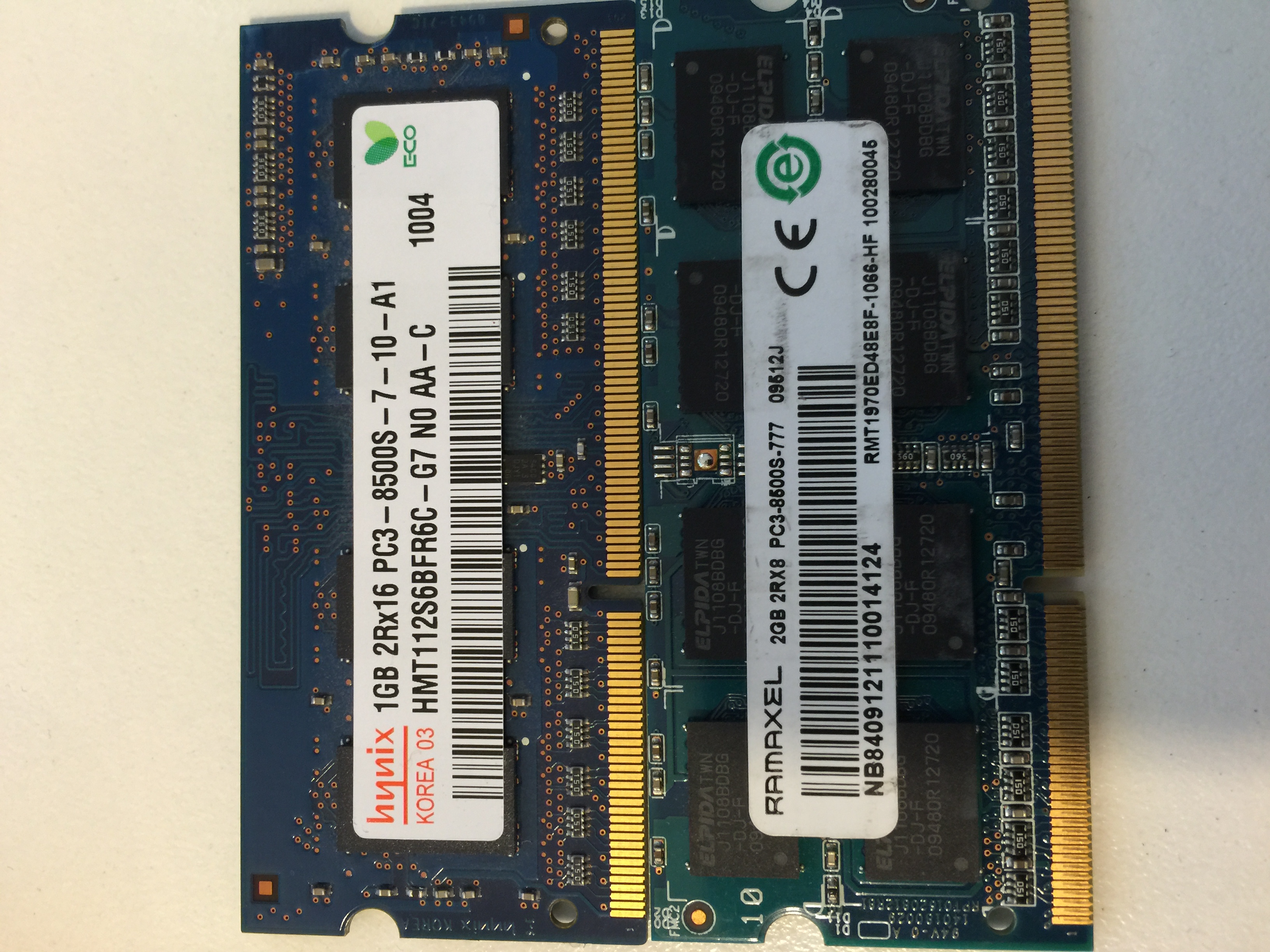

Are they the same?
Thanks!!
