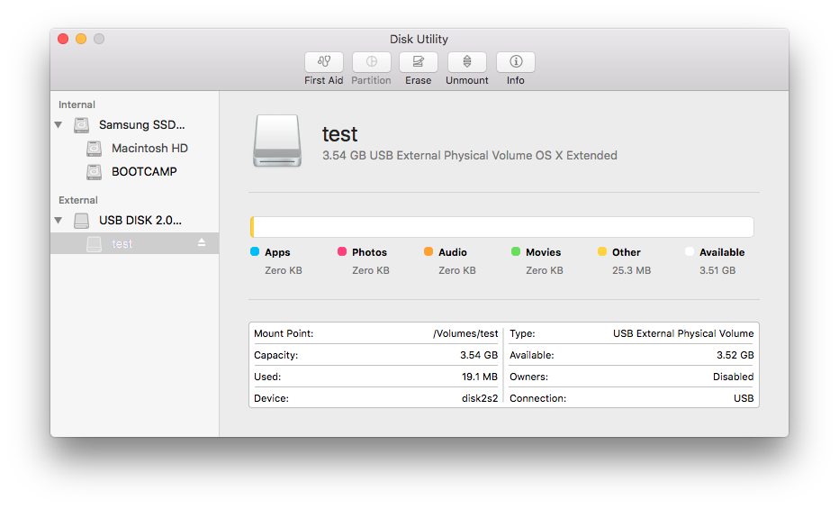

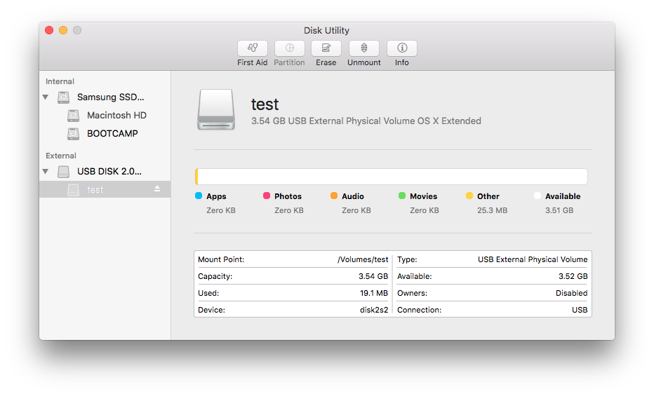

1) Plug in a USB stick
2) Format the USB stick through Disk Utility. Doesn't matter what format -- FAT32, Mac Extended, whatever.

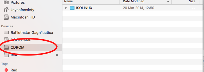

3) Double-click the Samsung EVO Firmware ISO file to mount it.

4) On my example, I formatted my USB stick with the name 'Test'. Single-click your formatted volume on your USB stick (the lower option, often indented) to highlight it.

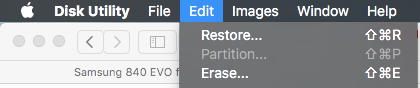

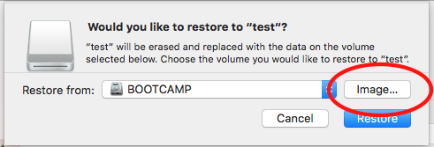

5) Then click Edit>Restore.

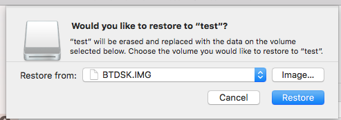

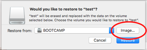

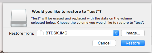

6) Select the option 'Image' for Restore from.

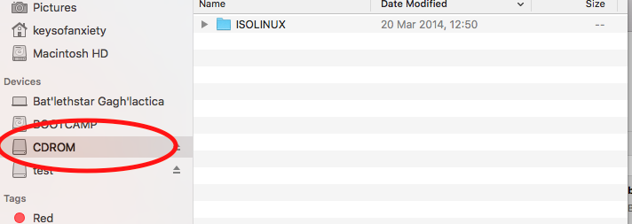

7) Along the left-hand side of Finder, you should see the mounted ISO file for the 840 Firmware. Mine was called CDROM (I just downloaded it a minute ago). Yours should be called the same thing 🙂

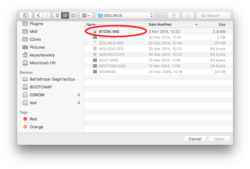

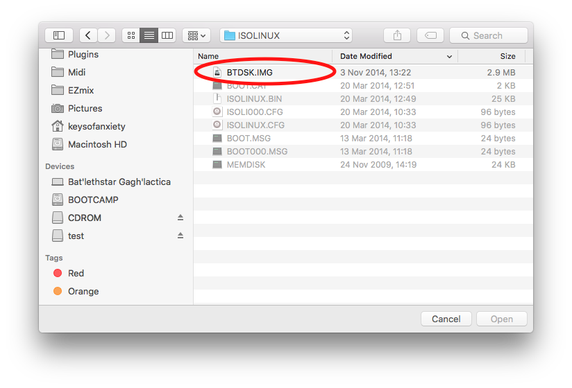

8) Double-click the ISOLINUX folder and then select BTDSK.IMG
9) Click Restore
9) Click Restore
