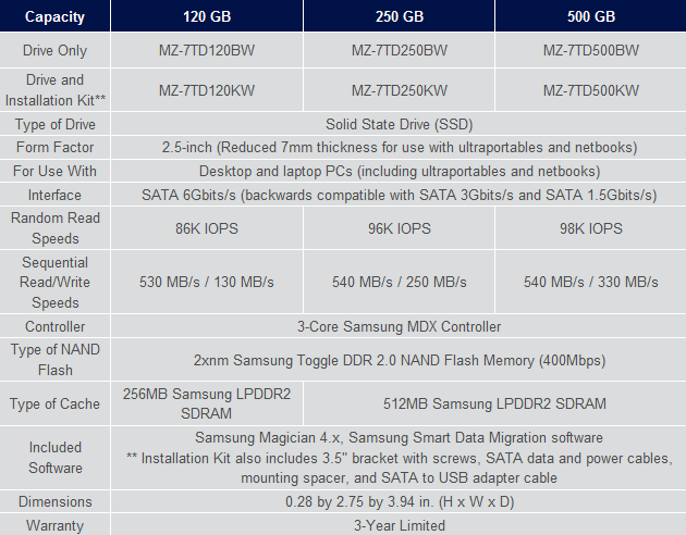

What capacity does it have? If it is the 120 GB version, then that speed is to be accepted:
Yes, you are right - it is the 120GB version. I'm just surprised that the Write speed should be as low as 130MBps.
I guess it is within spec after all.

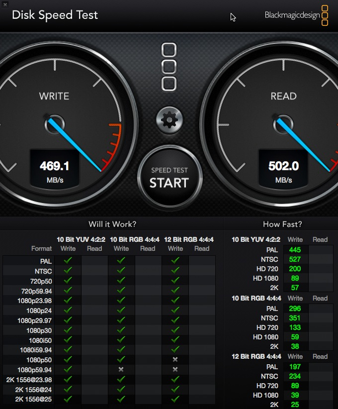

I just completed upgrading my Mac Mini 6,2 with dual Samsung 840 Pro's 256GB. Wow, compared to the stock 5400rpm drives, it is like a totally new feeling. I followed the instruction on OWC's website and it was accurate except for the part about removing the wi-fi/bluetooth antenna. There is a double layer black sticky cover over the connector. Other than that, everything else was spot on. I installed ML and all of my apps. Ran Black Magic and getting read speeds of 469MB/s and write speeds of 502MB/s.
This upgrade was definitely worth it. I bought the drives at Fry's for $240 each.

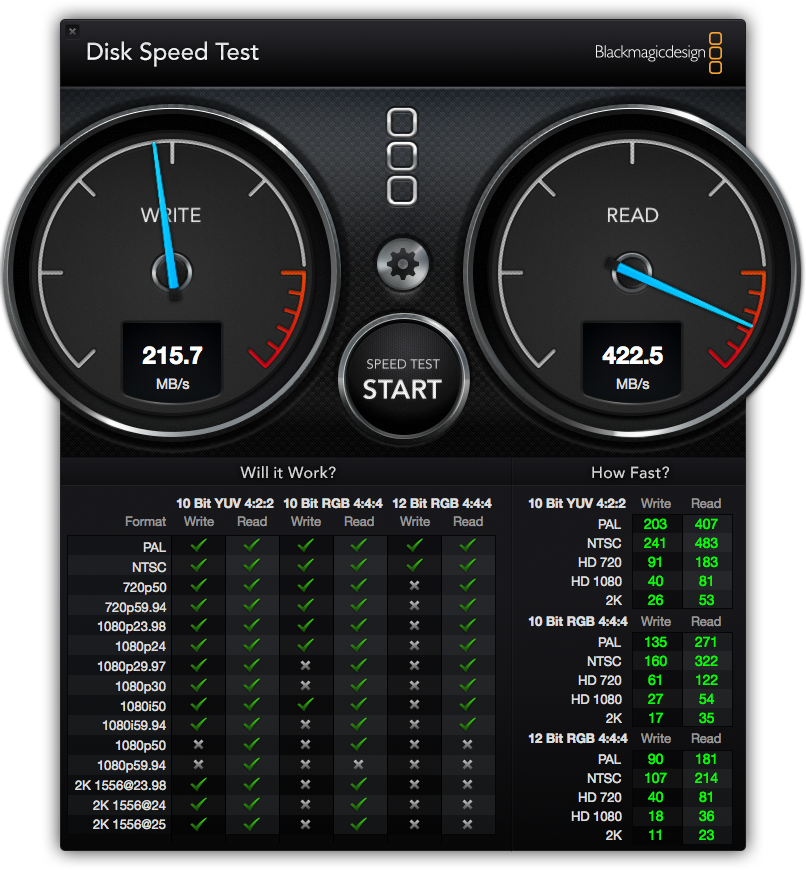

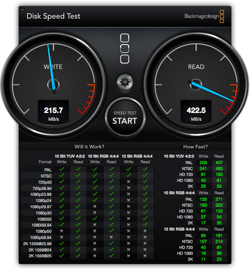

Here's the BlackMagic DiskSpeedTest result I got a few weeks ago with the 240 GB Intel 330 SSD drive inside. Anyone have a screen shot for a 128 GB Samsung 830 in a 2012 Mac Mini? Thanks!
