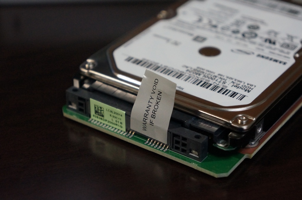

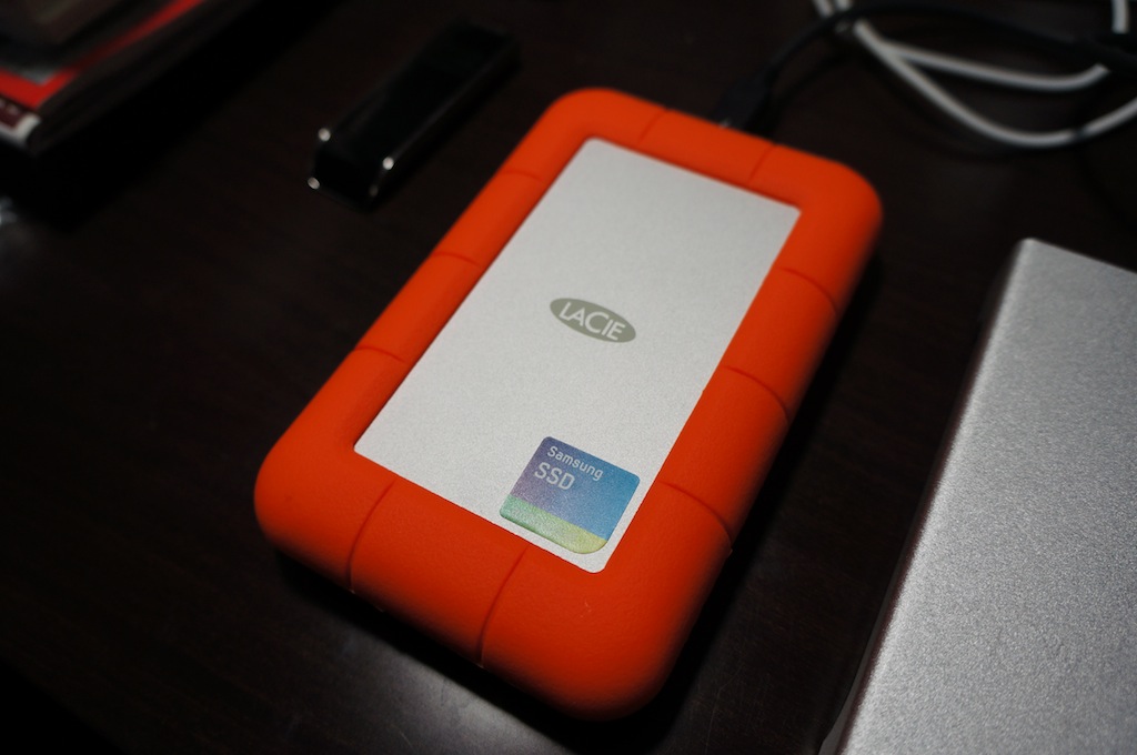

I ordered the 2012 iMac, after some seriously consideration, I've decided to go for external SSD instead of Fusion Drive or self-installed blade SSD. As I posted in another thread, I thought the Thunderbolt interface will throttle the overall performance of the SSD. Now my expectation is confirmed.

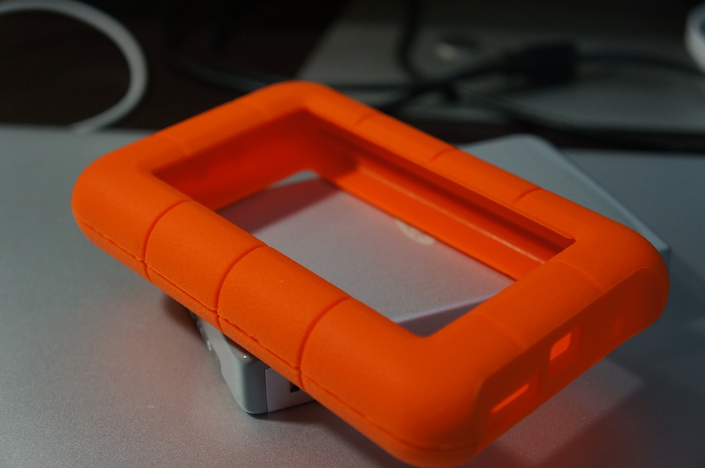

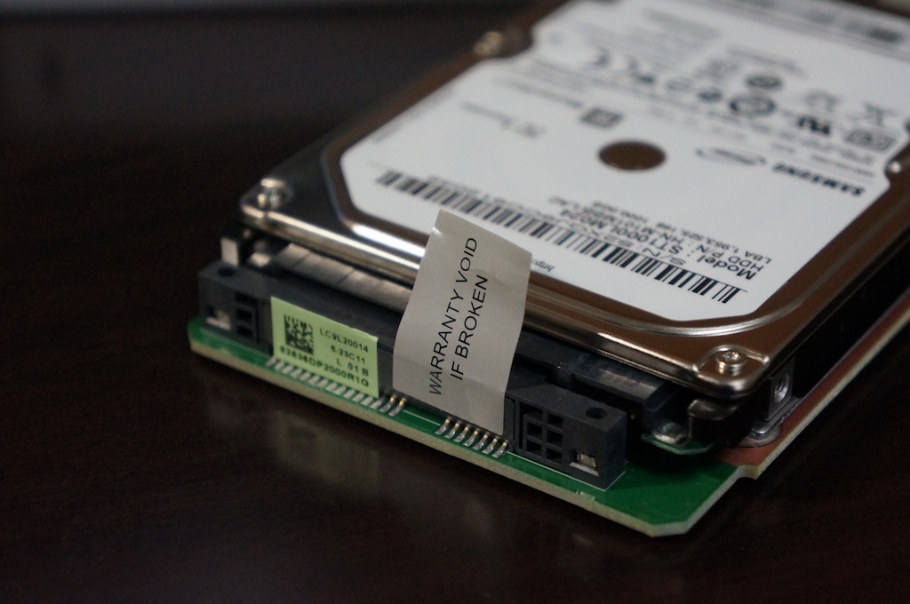

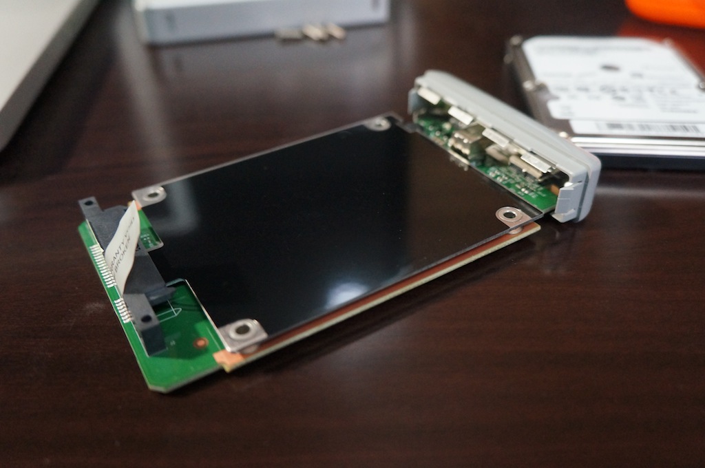

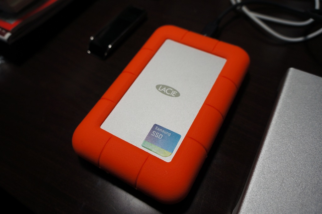

I purchased a LaCie Rugged USB 3.0 Thunderbolt™ Series for ~$230, which is a 1TB external HDD with a Thunderbolt port and a USB 3 port. Then I ripped it open and swap the 1TB HDD inside for a Samsung SSD 840 Pro 256GB. 840 Pro is the fastest consumer SSD available in the market, so the real capability of the enclosure can be seen.

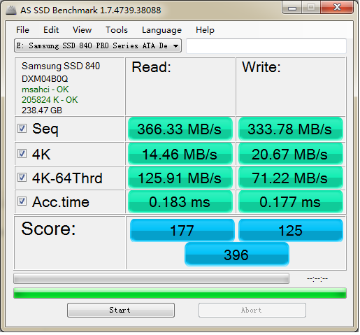

Then I plugged it to a 2012 Mac mini with 2.3 quad-core i7 running Windows 7 (BootCamp).

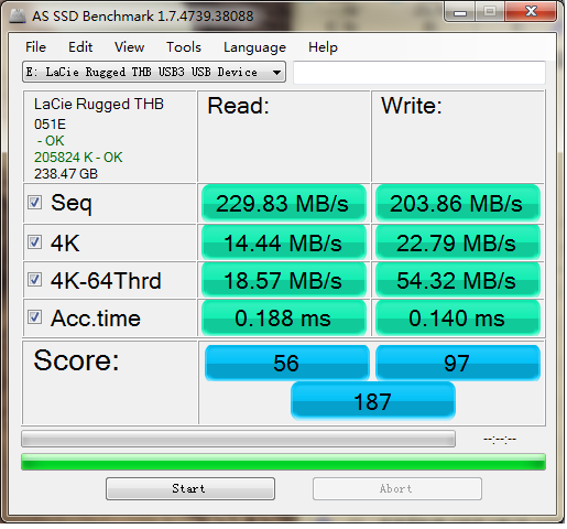

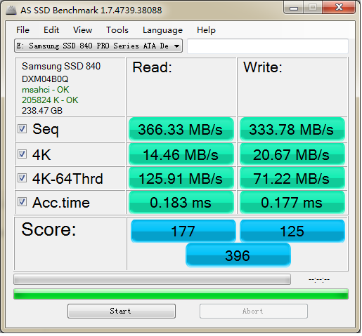

Fig. 1 is the AS SSD Benchmark result.
Out of curiosity, I also test it through its USB 3 port, result is shown as Fig. 2.
As you see, the Thunderbolt enclosure can only unleash ~1/3 of the 840 Pro. 840 Pro can easily score more than 1000 in AS SSD when directly connected to SATA 3. It even cannot beat USB 3 in terms of random r/w (4K 64-Thread is not important for home usage).
So, if you want to put your SSD outside to boost your new iMac, a cheap USB 3 case can handle this task. And if you want to stick with Thunderbolt for some reasons (daisy-chain, old Macs without USB 3, etc.), a entry-level SSD is more than enough, since the limit is the Thunderbolt interface (I am talking about single-drive enclosures only).

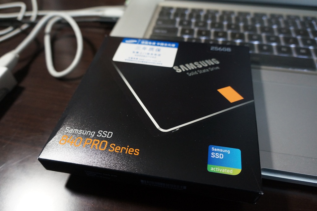

Here are some pics...

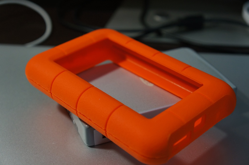

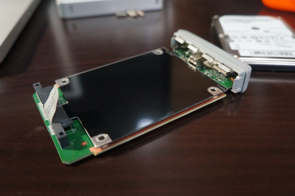

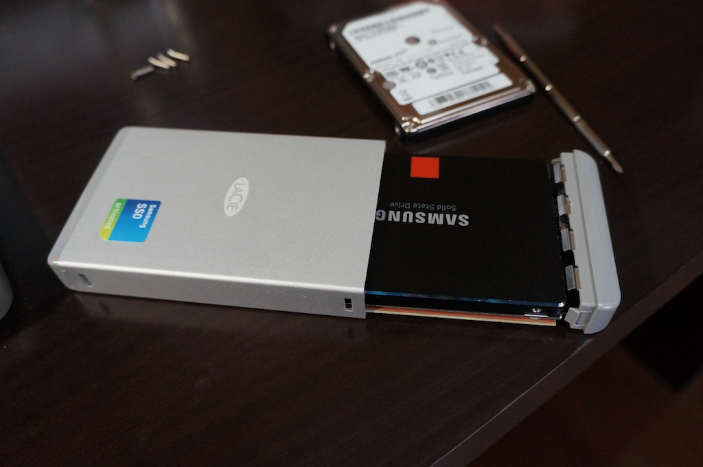

And more...

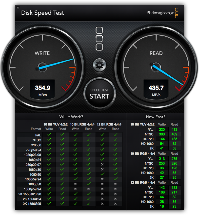

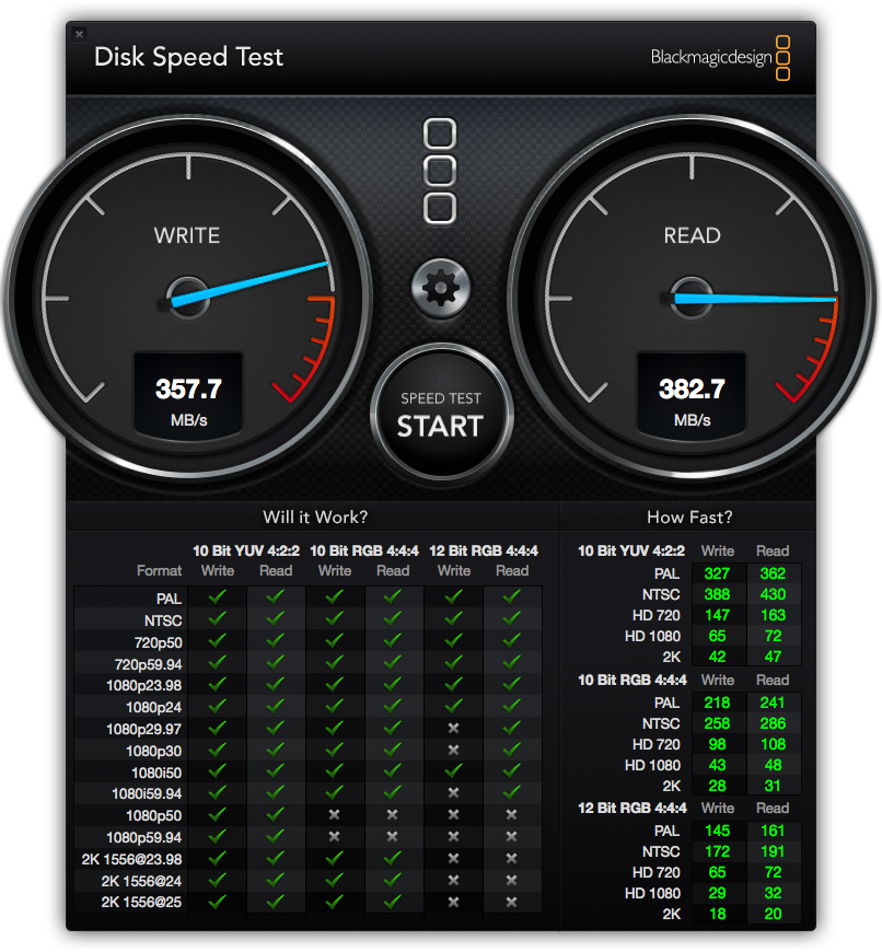

Blackmagic Disk Speed Test (OS X 10.8.2) results are here.
Left - Thunderbolt
Right - USB 3
Please notice that this is not the same machine that ran the AS SSD benchmark above. I used my early 2011 MacBook 15 (MC721) this time.

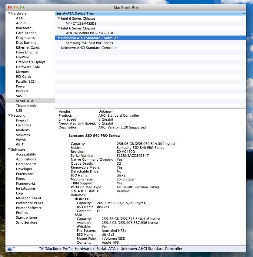

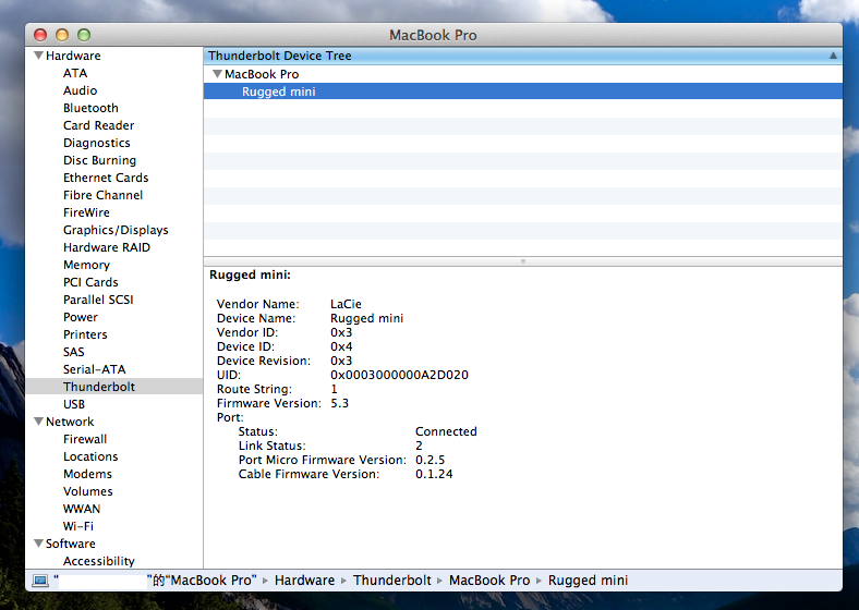

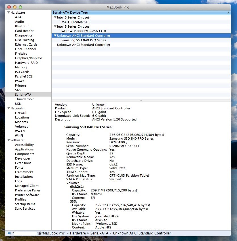

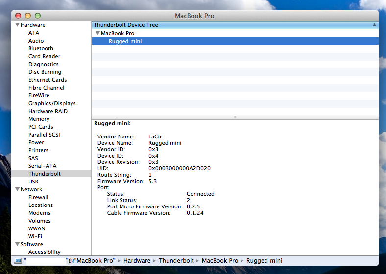

System info...

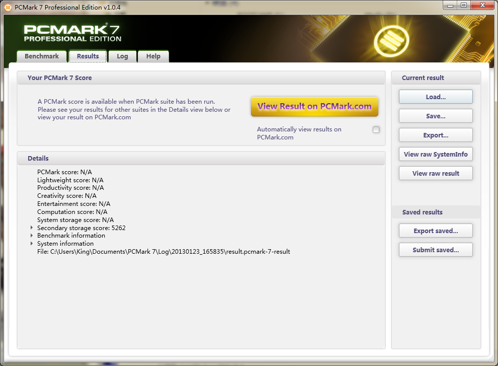

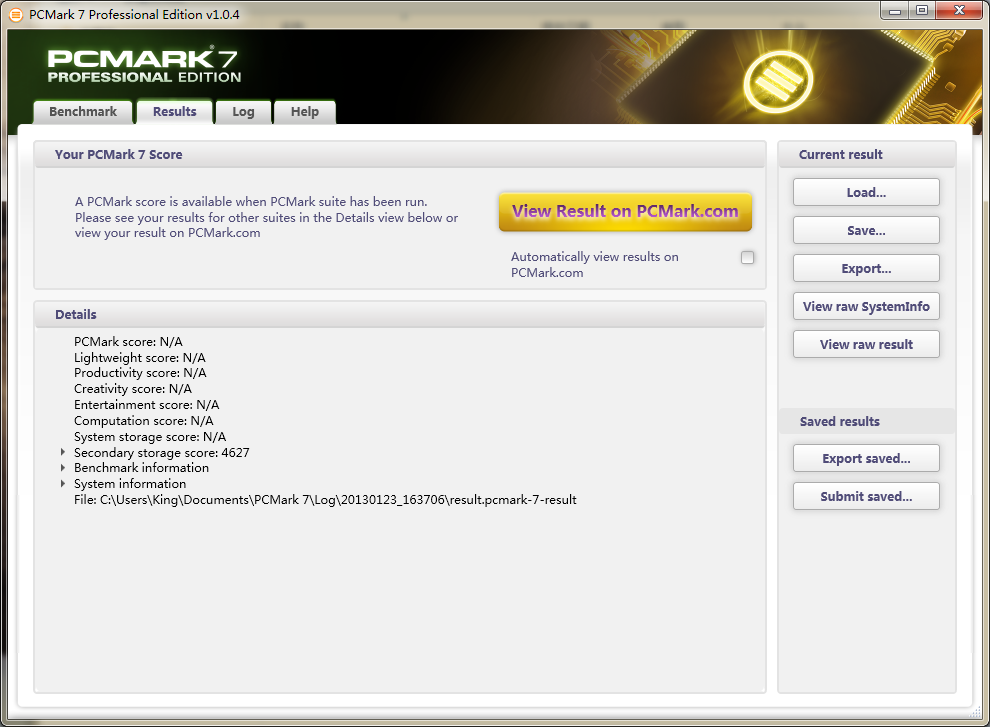

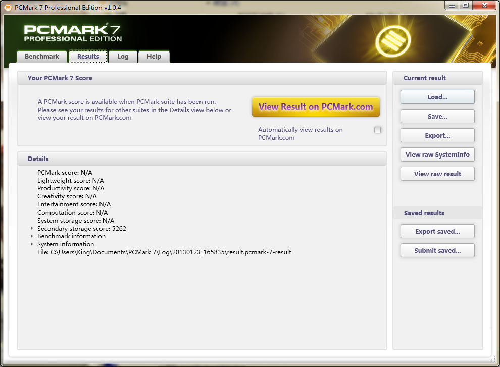

PC Mark 7 scores!
(on 2.3 quad-core Mac mini, Late 2012 model)
Left - Thunderbolt
Right - USB 3

Yes, the bottleneck is the TB. If you use 840 non pro, you may have slower sequential write speed, which is irrelevant to everyday experience. You should pay more attention to random performance. 840 (non pro) does really well.

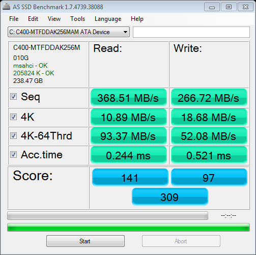

For comparison here are the numbers for the LaCie Rugged 256GB SSD edition (it comes with a C400 inside).
Bootcamp doesn't have AHCI enabled and therefor your 4K r/w results are low. The 4K r/w is the (only) important part of your test. This is where the SSD's are fast compared to HDD and Thunderbolt should be heck of a lot faster than USB on 4K parts.
(it could also just be a problem with the TB bootcam driver, testing TB under Windows is far from optimal)
AHCI is enabled. Please see the top left corner of the AS SSD screen, it says msahci-ok.
Thanks. 256GB SSD edition is a better idea than swap SSD by myself. It comes with a warranty and it's not significantly slower than the 840 Pro.
