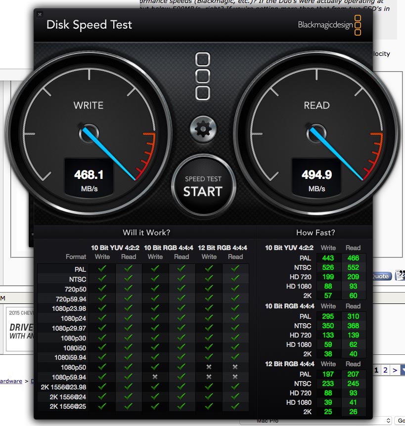

Below are BlackMagic Readings.
1. SM951 on Mounted Lycom Card
2. 840 Pro Mounted on Apricorn Duo x2
3. 840 EVO Mounted in HDD Bay

Flowrider, thanks but those sequential performance benchmarks are not interesting - and I am on a cMP, but I can use a PCI adaptor if needed, but random read speeds are not limited by SATA or PCI, so again, not a very interesting question....

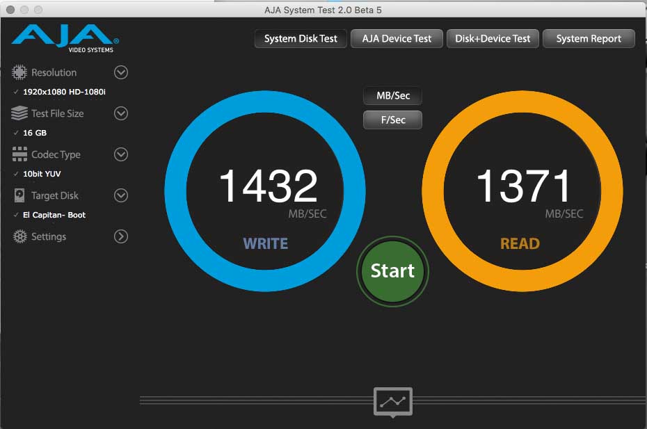

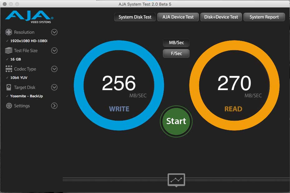

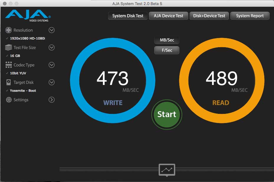

^^^^My AJA Test Results:
1. Samsung 840 Evo in SATA HDD Bay
2. Samsung 840 Pro Mounted on Apricorn Duo x2
3. Samsung SM951 on Lycom PCIe Card
Lou
