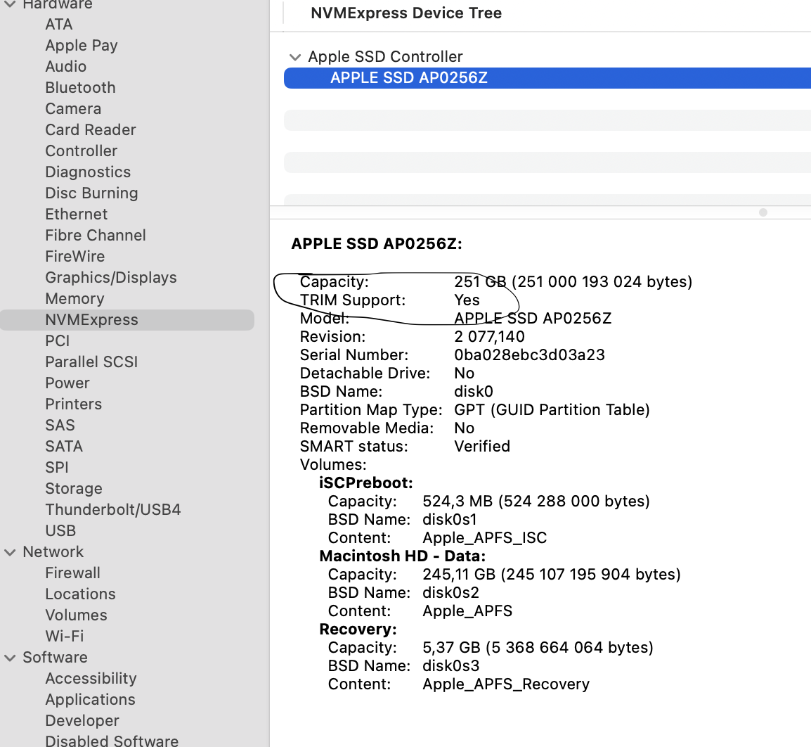

Hello everybody!
One question about boxes TBU405 or TBU405 Air
Are these both enclosures support trim in mac os when they connected to Thunderbolt port? Maybe anybody have this boxes in use, so can you check System Information wether trim enabled for this external disk or not? Like on the screenshot for internal disk of macbook.
Thanks.

Hello everybody!
Yes both should work equally well when connected to a Thunderbolt 3+ port. Main difference between the TBU405 Air and the other TBU40x (/Pro) models is that the former does not have the RTL9210x chip and so will not work with USB3-only connections. The TBU405 Air requires a Thunderbolt 3 or better connection (USB4-only hosts should also work but YMMV).
Then assuming a Thunderbolt 3+ connection, both will put a supported SSD on the PCIe bus of the host computer as an NVMExpress device. MacOS generally supports TRIM to NVMExpress devices.
However note that TRIM is handled by the SSD and so there can be incompatabilities between the SSD's TRIM implementation and MacOS. Some people had problems with macOS Monterey+ and Samsung 980 Pro+ (problem may have been resolved with Samsung 9100 Pro but I have no hard data on that).
The thing is the whole tech stack has to work together and it's a pretty complicated stack. That it works as well as it does as often as it does is almost a miracle. But then some combinations of hardware/software/devices/firmware/etc have issues and good luck from there...
Thanks.
I have a TBU401 Pro (almost the same internals as the TBU405 Pro though guessing the latter has some refinements) and can confirm it supports TRIM. Tested with Samsung 970 Pro 1TB and Seagate 530R 2TB SSD.

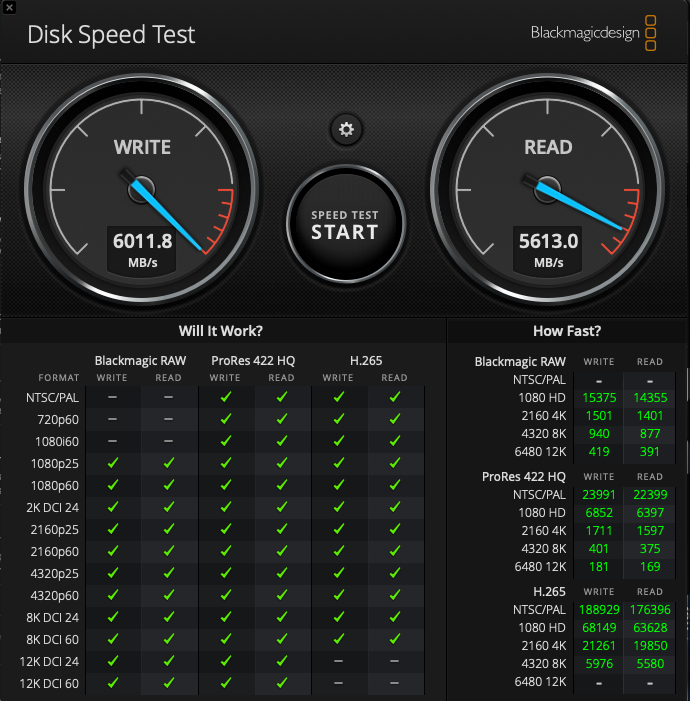

That's why I was looking at the new ACASIS TB5 enclosure i.c.w. a Samsung 990 Pro SSD. It has active cooling, although presumably barely audible.
But maybe I do not need to look any further, if the combination of a TB4/USB4 OWC enclosure and a Samsung 990 Pro SSD works fast enough. Probably would then use half the possible speed of a Samsung 990 Pro attached to a Thunderbolt 5 port?
Yes I have these for various SSDs.... Crucial/990 pro/Lexar etc. I have a M1 Studio Ultra which has TB4 ports.
The fan is silent..... the enclosure barely warm......and all are very very fast.....and the Lexar 8TB the fastest. I'm not going to go to TB5 because that would mean going to a M3 studio ultra and as of now macOS Tahoe and I'm completely happy with macOS Monterey 12.7.6. You have to go to macOS 14 or later to use TB5.
Just my two cents. I own the acasis TB5 ssd enclosure and use it with a WD_BLACK SN850X 8TB drive and a M4Pro Mac mini. I am very pleased with this setup. You have to decide if it is worth the investment. It sure is exceeding TB4 limits.
