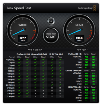

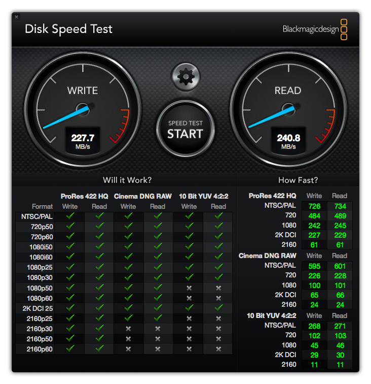

Hi,

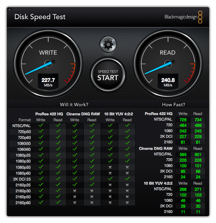

After eventually talking myself out of putting my Samsung Evo 850 inside my laste 2015 i7 iMac, I purchased a USB 3.0 external enclosure (inatek) as many people recommended it would be optimum speed.
I was under the impression I would be getting much faster Read / Write speeds than I'm getting.
Am I missing something? Just formatted to Mac OS Extended (Journaled)
Do I need to reformat it different? Firmware updates? (Can't find for this model)
If this is my maximum speed I may as well stick to my Lacie.
Thanks
Thats pretty low im using a Satechi enclosure with that same drive and am getting 500/480 read/ writes so I would say that your enclosure is limiting you. what is the enclosure?

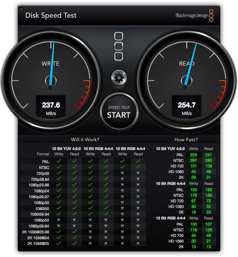

Dug out some old tests I did back in 2014 - beware that the Disk Speed Test dials seem to have had another scale than the current version, so only look at the numbers.

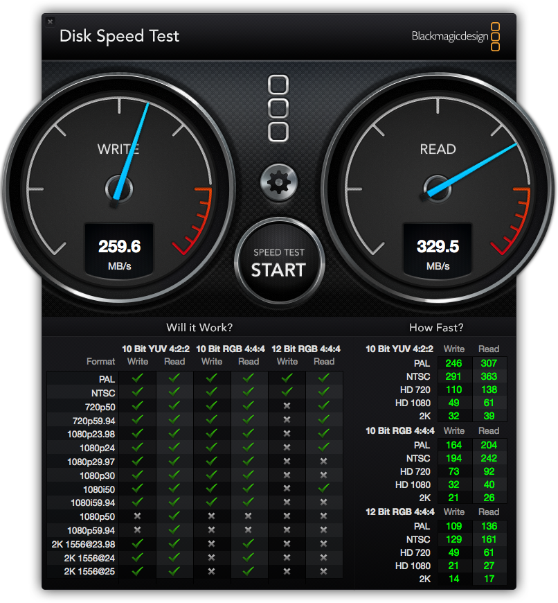

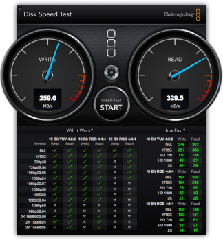

This is what I got on my iMac 27 2011 using a CalDigit Thunderbolt Station with USB3 with a Samsung 840 EVO 250 GB in a StarTech S2510BPU33 USB 3.0 chassis with UASP:

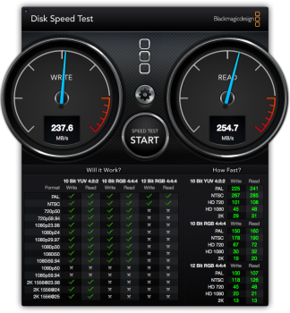

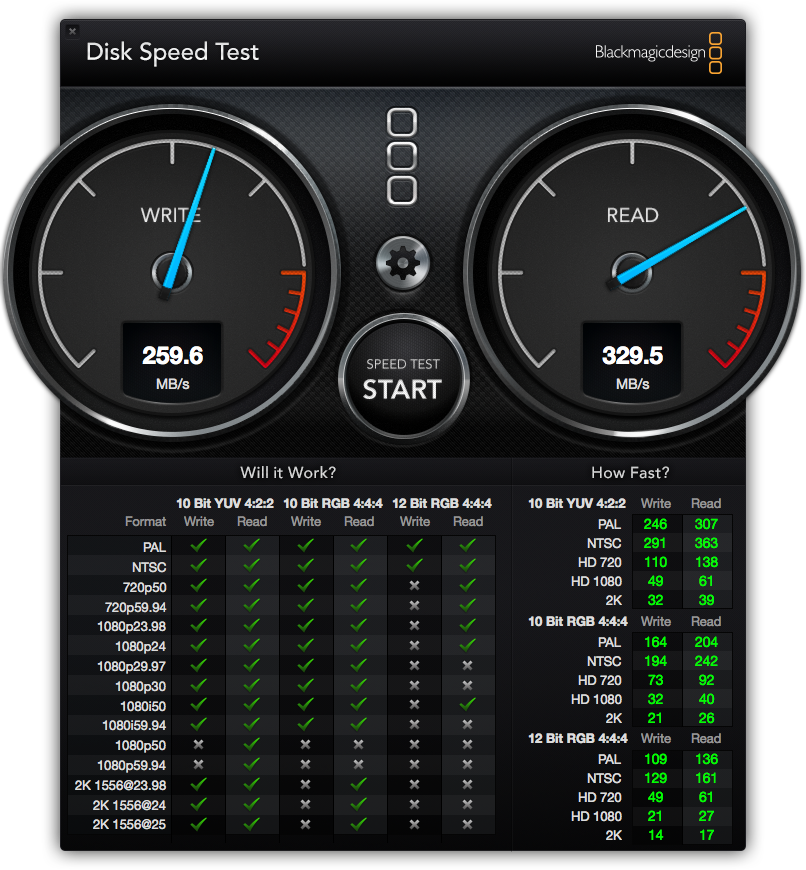

With a Delock chassis without UASP, same SSD:

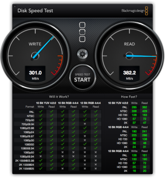

And Thunderbolt 1: Samsung EVO 840 500 GB (note: it is by design faster than the 250 GB version above) in external Buffalo MiniStation Thunderbolt 1 chassis (came with HD I swapped out) and with TRIM enabled:
So it seems like you should be able to get better performance than you currently see.
I believe some speed is lost (via USB3) when "going through" an external dock (like the CalDigit, etc.)
Connect the USB3 SSD -directly to- one of the Mac's USB3 ports, and test it again.
I have a 2012 Mac Mini which I boot and run using SSD's mounted in external USB3 docking stations. I get reads of 431mbps from both drives.
You should see 430mbps at least...
