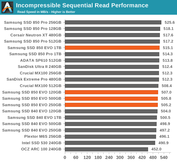

Hmm... Reference? Anandtech has the 850 EVO at consistent speeds across all capacities for incompressible sequential read and write (which is what BlackMagic Speed Test does).

- I wasn't referring to the listed specs, but to the actual incompressible sequential read and write (which is what the BM test does) test they performed (on page 8), which has the drive at very similar speeds across all capacities.

- I did see page 2, and I do see the difference there. But am I completely wrong to think that the more relevant data to our current discussion is the incompressible test on page 8, which indeed does show consistent speeds across all capacities?
