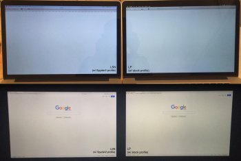

As I understand, and as shown in this image, there's a large variation in white point even within the Samsung displays (which both of these are).
My question for those who have seen large quantities of these is - how common is the whiter example on the right?

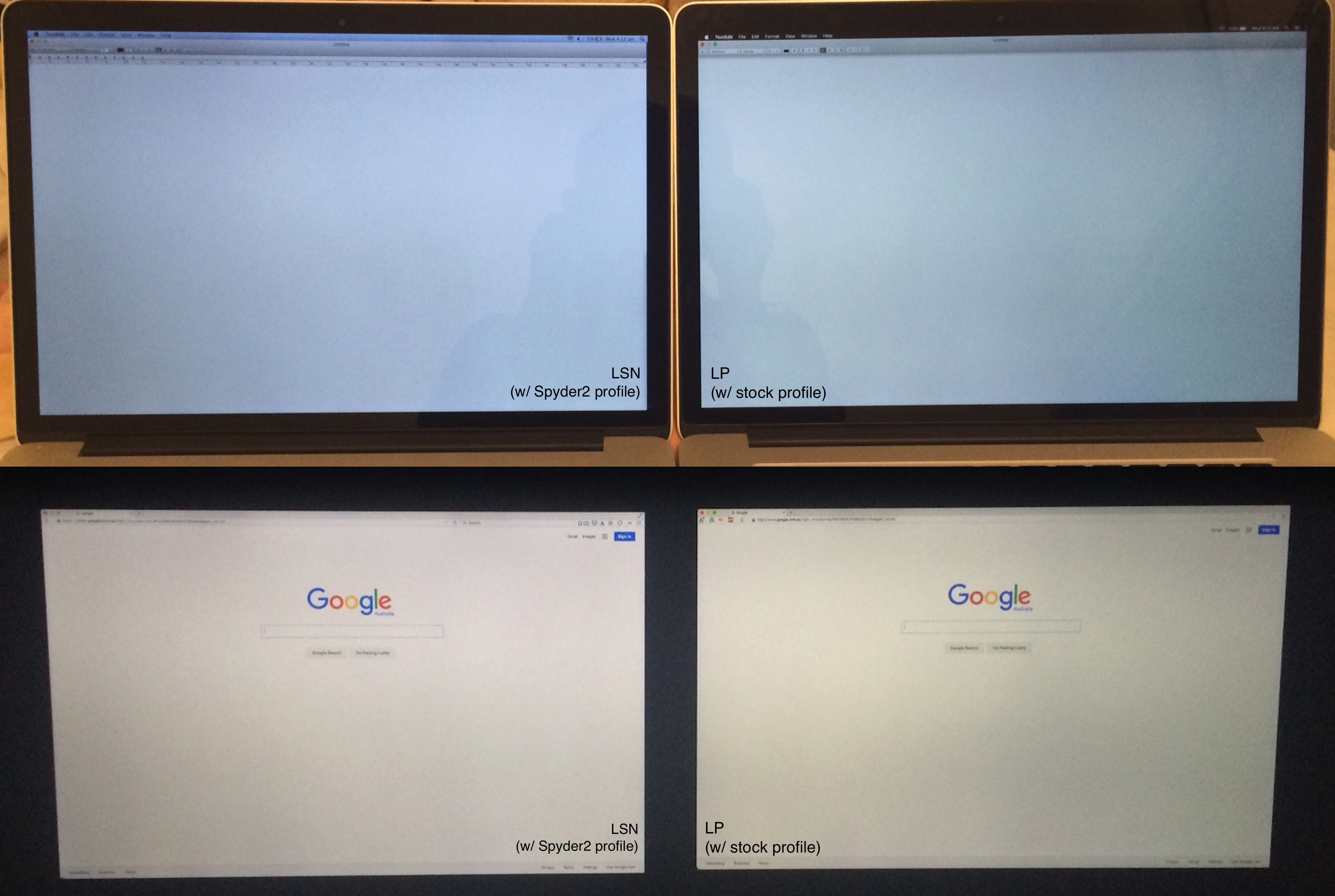

I ended up getting the Samsung screen and it was roughly comparable to the LG in its display of whites (both in 15" MBPr), though slightly worse than the LG in stock guise. After installing the presets suggested by @Scott M (I found "Spyder 2" best for my panel - thanks again for sharing those), the Samsung is slightly better.
I think there's definitely substantial variations and inconsistencies in the Samsung panels, so I wouldn't recommend them and I think Apple need to have far stricter quality and consistency controls.
However, I'm happy enough with mine and took some pictures for comparison. I used low brightness (4 bars on both) to give a realistic idea of color. The difference isn't nearly as exaggerated as the photos suggest - and the LG was better in stock guise. However the profiles helped make the Samsung quite good / slightly better than the LG.

Glad it worked for you! I think the bottom left screen in your pics shows the best colour. The top 2 are too blue and the bottom right is too yellow.
