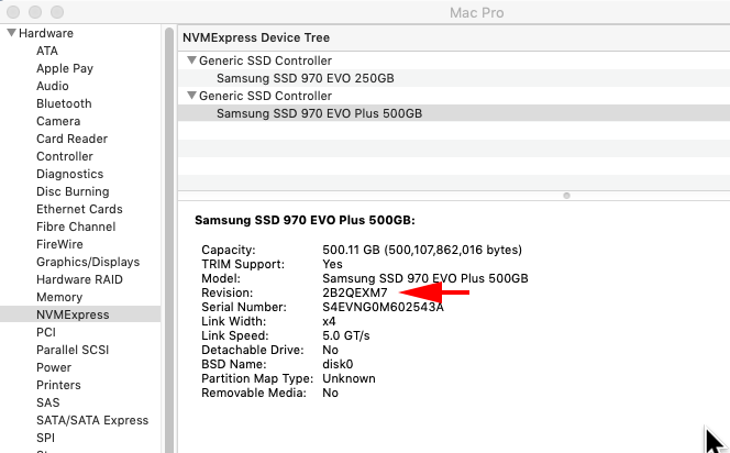

I bought a 500gb Samsung 970 EVO on Saturday. I realised that the firmware had to be checked as the 970 EVO's firmware in the first release from Samsung ( 1B2QEXM7 ) was causing kernel panics etc.
Sure enough looking in " About this mac / Hardware / NVME the firmware was the problomatic" 1B2QEXM7 ".

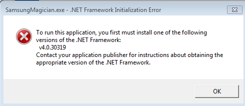

So, I fired up Win 7 and ran Samsung Magician . .but .. . I got a popup message saying that it needed Microsoft .NET v 4.6.
this had never happened before. So I ran Win 8.1 and got the same message.
Now I was starting to get worried. so I did two re-installations of Win 7 in both 32bit & 64 bit.
Got the same popup when I tried to run Samsung Magician.
After quite a while and many net searches I happened on the solution over at tonymacx86's haxckintosh forums.

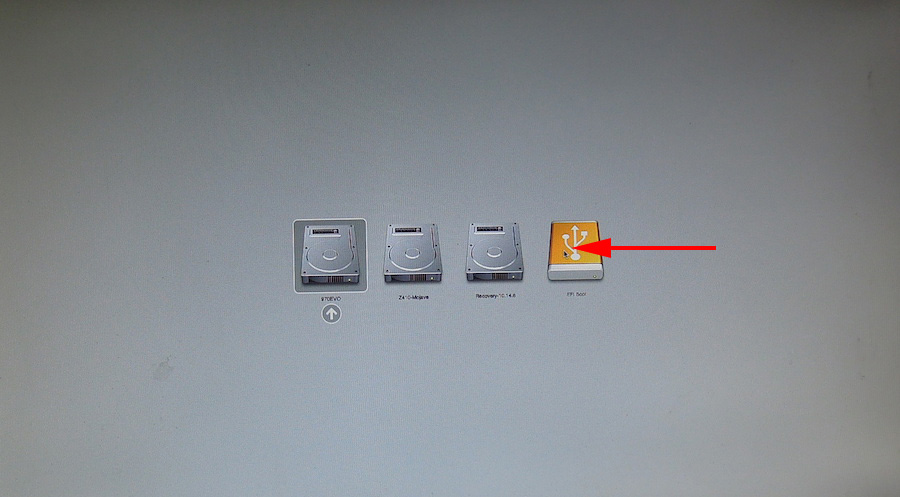

6. Booted up holding down the OPTION key for the pre-boot selection screen ..
. . there it was ! My USB stick shown as " efi boot.

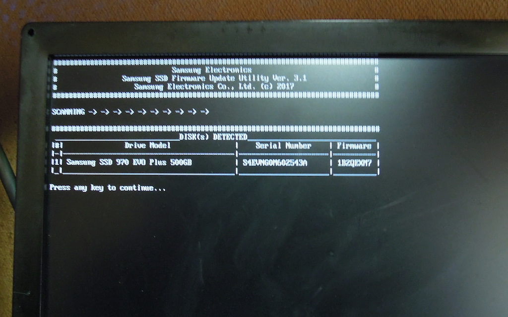

7. Started the "Efi Boot and then UNetbootin started up.
The rest was simple & easy. In about 10 seconds it found my 970 EVO Plus and asked me if I wanted to update it.
I typed in "Y".
Another 20 seconds and it was done.
I now have the latest ( 2B2QEXM7 ) firmware on my 970 EVO Plus.

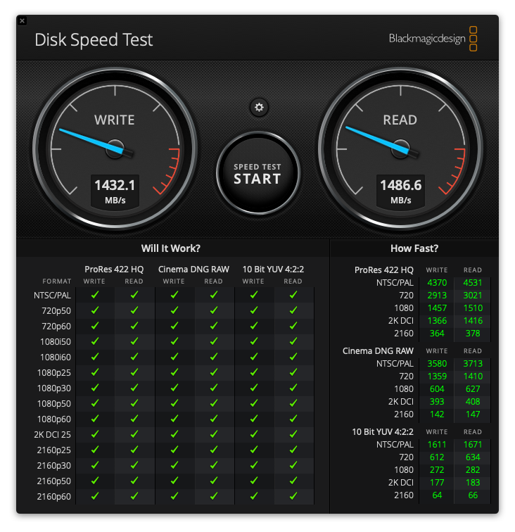

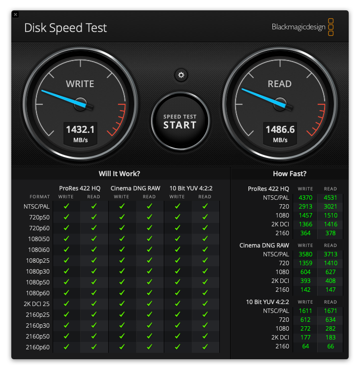

I also have a 970 EVO installed and I have noticed that the 500gb 970 EVO Plus is definitely faster and doesn't slow down as much as caches fill up.

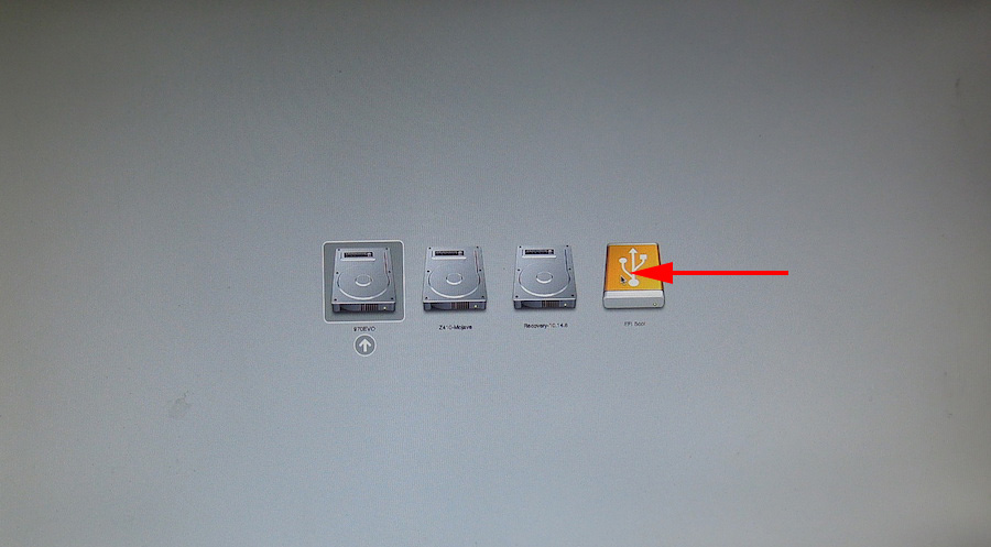

Perhaps you could have mentioned that your 970 EVO Plus installed in your iMac.
My firmware-updated 970 EVO Plus firmware is 2B2QEXM7. 8 digits.
