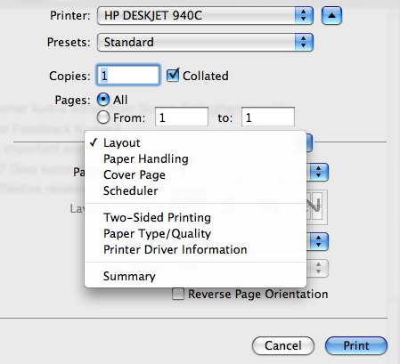

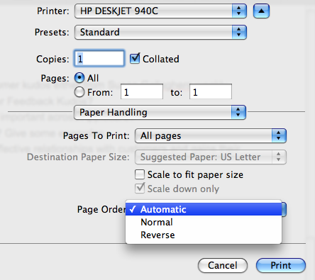

I'm not sure of the exact specifics of your printer...but when you press print (or command+p) there should be an option to change the 'paper handling.'
(click on the 'pages' button if thats what application you are using, for preview it will say 'preview' etc etc..)
It is under this setting that you can change the page order. Then set it as default.
Hope that helps!

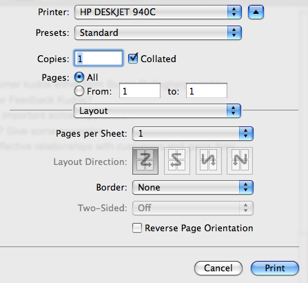

Here are screens of the process after bringing up the Print menu.
