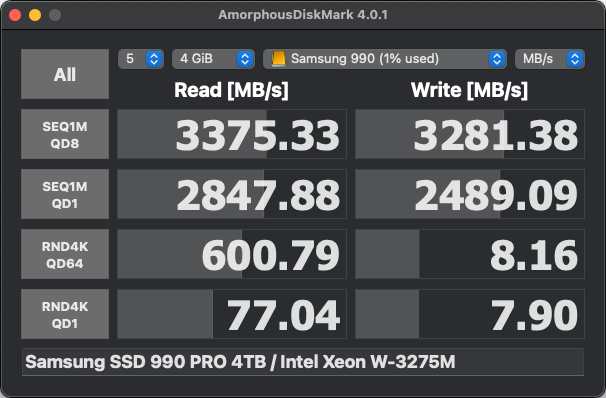

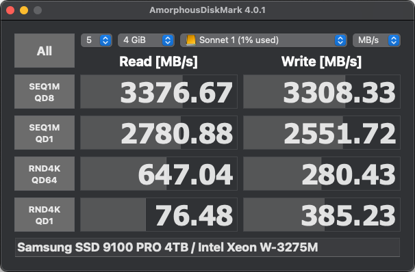

I'm using a Sonnet 4x4 PCIe card, and I've got two brand new drives currently hooked up to it.
The 9100 Pro seems to be operating fine, but the Samsung 990 Pro is posting extremely slow Random Write times. Random Reads are good.
This seems abnormal and not an issue related to running on PCIe 3.0. I've also posted results for the 9100 for comparison.
These are running on the same PCIe card. Ive changed the PCI slots to a different x16 slot and same results. I've run Samsung Magician and the Firmware is up to date.
I'm not sure what could be causing this. Bad drive?

Leave the Samsung 990 idle in the background for a few hours while you do other things on the computer.
I'm thinking the overprovisioning (effectively a write cache) is loaded up. The card will do background maintenance while idle, which should restore your write speed. A manual TRIM pass might help. Had you just finished an OS install on the 990?
Reactions: betthefarm
No, just installed it brand new and newly formatted. MacOS is on the main Apple SSD. I'll try that and report back.
I let the Samsung idle overnight, so far no luck. Still getting about 8MB/sec Random 4k Writes at QD1.
Wondering if there is another app to test it with. Could it be a bad result that's unique to Amorphous Disk Mark? Still seems strange though given that the other Samsung 9100 drive is fine.
This is a strange result and Amorphous has gotten better numbers from that drive on other systems:
Given that your connection to that NVMe is relatively direct and the configurations used in the above had their drives in an external enclosure (first over TB3 to an Intel machine and second over USB4v1 to a M4 Pro), I would have thought if anything you would have gotten a touch more performance from that drive in your system.
Is it possible that drive doesn't like the Sonnet for some reason? Do you have any way of testing that drive on a single drive extension card or a TB3 enclosure? Have you checked the card's settings in Expansion Slot Utility?

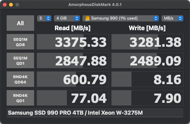

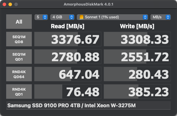

View attachment 2499995View attachment 2499996
What numbers do you get from Blackmagic?
Did you check the drives have the latest firmware (by installing them in a PC) first?
The results suggest your stick is at fault. Can you post the raw SMART values for your 990 stick? (you may have been sold a heavily-used one) Maybe pictures of the front & back of the 990 also?
I've read of people buying imitation Samsung sticks from Chinese marketplaces. The fakes often omit DRAM cache and other performance-boosting features. While the box they come in shows a real Samsung stick, the actual stick has a different component layout.
Maybe. But it's weird that the 9100 works well, and the website advertises results with a Samsung 970 EVO as the benchmark (albeit from a few years ago). Is NVME a universal standardized language? I know the card doesn't need a driver.
I tried removing all PCIe drives in case it's a Pool allocation problem. Tried PCI Expansion Utility to put the card on its own Pool. Also tried a different x16 Slot in case it was a Motherboard issue. No luck.
I also checked to see if it was a Sonoma issue, but I was able to reproduce the problem on Catalina.
Blackmagic only tests sequential Read/Write. Those numbers are fine. It's the Random writes that are off, which is a much more real-world test.
When I drag a 1TB folder with thousands of small files, after about 10min it says it will take 8 hours to complete. The same folder copies in less than an hour on the Samsung 9100. That seems to backup that there is a real world problem with Random Writes.
The Drive has the latest firmware according to Samsung's website.
I ordered it directly from Samsung's store on Amazon. I've ordered a second 990 Pro drive just to check. That should hopefully tell me if this one is a lemon.
I downloaded SSD Reporter and the 990 gets 100% health, all readings/indicators at 100. Disk Utility is saying SMART status is "Verified".
When I get the new drive, I can post the results to see if therey're any different. Any ideas of what to check in the meantime?

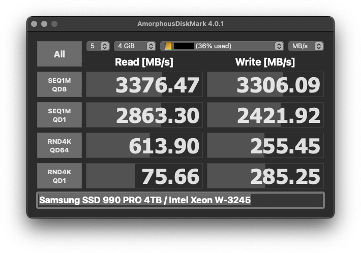

My results on a Highpoint non-hardware-raid card, with 2 out of 4 NVME slots filled, on an x8 pci slot.
FWIW.
FWIW.
That's super helpful, thank you. Most likely a bad drive or compatibility issue with the Sonnet.

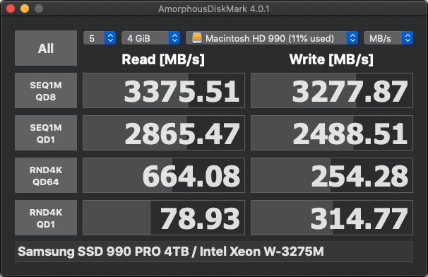

Boot from a clean OS, running on one of the Samsungs?
I'm running a clean install on the Samsung 9100. I can try it on the 990 Pro and see what happens.
This solved it! When running MacOS off of the 990 Pro, I got the following result:
Samsung SSD 990 PRO 4TB : Intel Xeon W-3275M Bootable.png
Which means this may have just been a Amorphous Disk Mark issue all along. (!) Something about its Random Write programming doesn't gel with an external 990 Pro.
