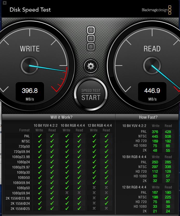

What kind of speeds are you getting with the drive?
This is what I get with the Toshiba 128GB.
I wonder if one can really notice any difference in ordinary usage. Sure you'd notice copying a 25GB video file from one part of the disk to the other, but will you notice any difference in Video Editing, programming...

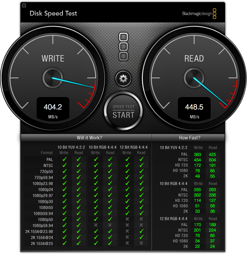

Samsung 256GB in 11" Air (2.0GHz, 8GB Ram).
This is my SpeedTest
