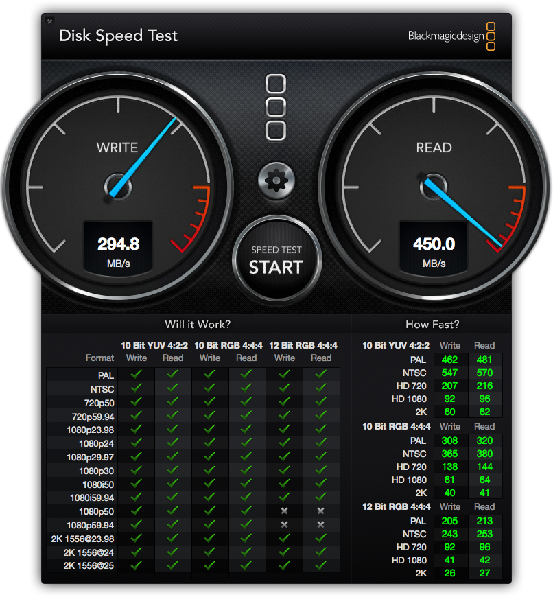

So as the title suggests, I ran the Samsung Performance Restoration Software on my 2 day old 840 EVO.
The whole thing took approximately 8 minutes so I'm wondering, should I have run this a few months from now? Others who have older 840 EVOs said the process took close to an hour.
So I can't rerun the Software either and I'm kinda scared that I messed up on the "Restoration" part and nothing happened at all.
Now while some of you may suggest benchmarking, I really don't know how to read Blackmagic benchmarks and I'm kinda lost in that area at the moment.

Here is what Blackmagic is showing after the Software was used

I see nothing that looks terrible.
If you have apps open and running, that could impact the results. And as to the results, they are simply synthetic. You aren't going to get the published numbers every time etc.
Do you have Trim enabled? If not, that is something to consider. Outside of that, unless the drive starts showing signs of a problem, I would use and enjoy the upgrade from HDD.
Edited to add: I have a Crucial MX100 512GB. It is "rated" for 550/550. I haven't seen those numbers since I installed the drive on 12/29. The most I have seen is 480/520, which is fine. The drive is working as it should. The drive numbers are no different than car manufacturers placing fuel economy numbers on the stickers. Nobody gets the exact numbers.
