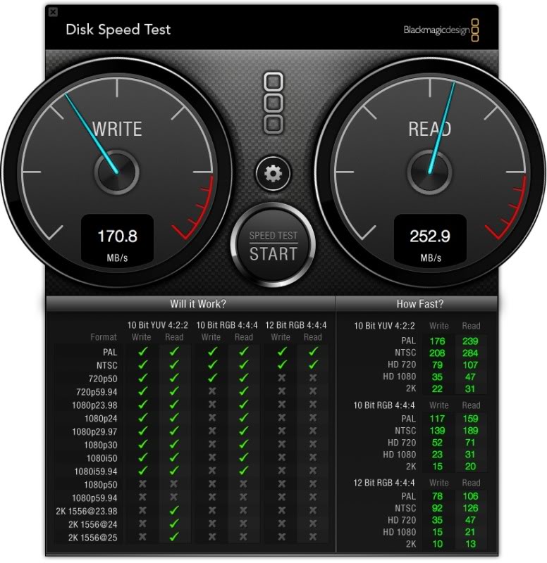

I'm thinking either the SSD is defective or the SATA cable from the motherboard is bad? Currently it seems to be running fine and boots extremely fast but if I run a speed test (screenshot attached) it doesn't seem to perform like it should. I have searched the forum and read the threads about this SSD and it looks like a few people have had problems but I can't seem to find a solution that I haven't already tried.

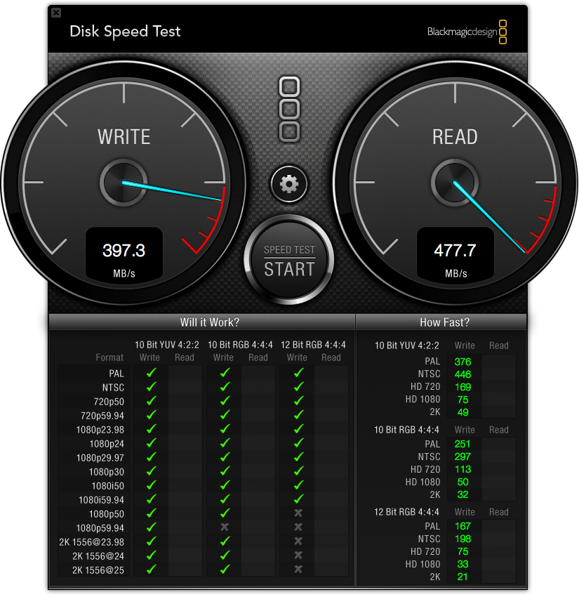

If I'm not wrong you have a mid 2009 MBP. Those only have Sata 2 connetion. Thats why you dont see the advertised speeds. This is what I got on my Early 2011 MBP with a Sata 3 connection. Disk Speed Test 2.1.

You MBP is a 2009 model, right? I might be wrong but I think that your MBP is from the ones that suffer the issue with the SATA connection when updating to EFI 1.7 which supposedly updated the chipset's SATA speed from SATA I to SATA II but caused lots of problems for people.
See https://forums.macrumors.com/threads/729883/
If that is the MBP that you have, the only solution seems to be to downgrade to EFI version 1.6. You would be limited to SATA I speeds but that would be a lot better than constant lock-ups and kernel panics.
Thanks for this! I followed the instructions and downgraded to EFI 1.6. During normal use computer still seems very fast but now much more stable. I haven't done much on it yet and am still running Snow Leopard for now. I called Samsung and they offered to send me a replacement. I'm going to try it out for a few days before I get a new one. I'll definitely take it to school and work tomorrow though and see if I can get it to lock up/crash again.
