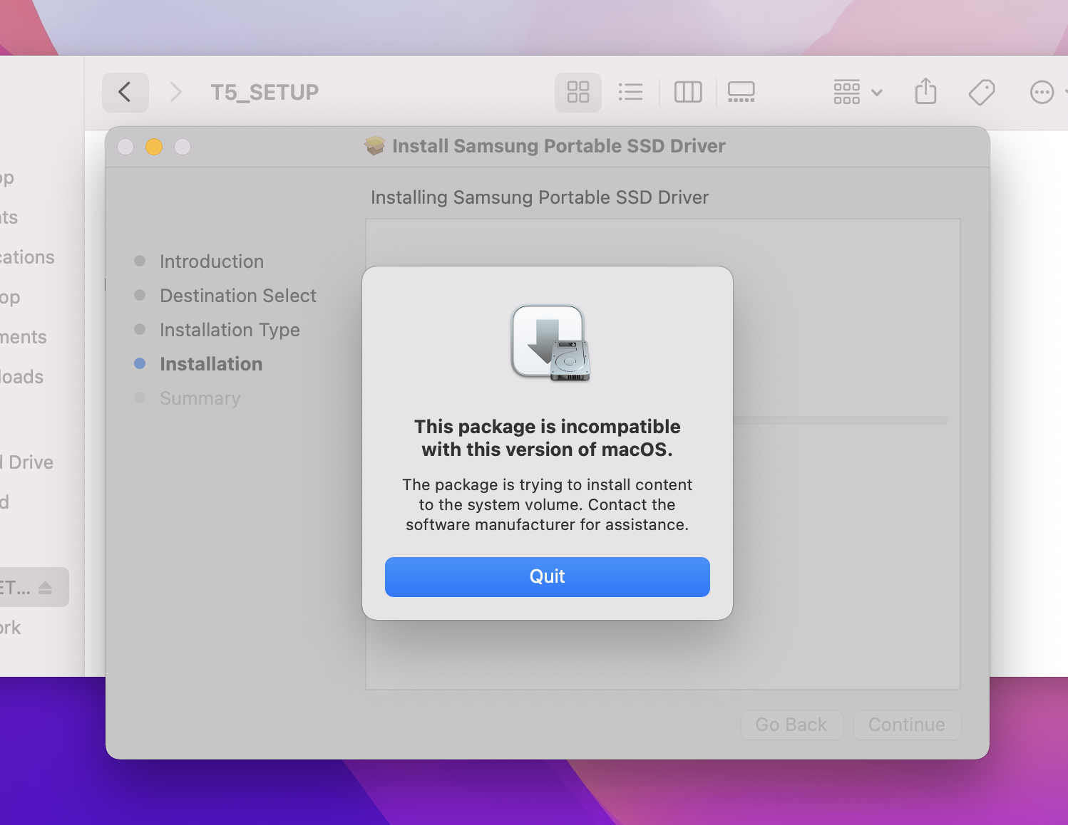

When I try to install the driver it says it is "not compatible with this version of macOS".
I don't know much about computers. I have EVERYTHING saved on this Samsung SSD T5 that I got a few years ago and used on my old laptop that I don't have anymore. I used it as a backup and was going to just copy and paste all my files onto my new MacBook. But I can't now???? Did I royally screw up?! Please help! It is showing this message: (see pic). I had a password setup on it, so not sure if that is the problem too? I do have the password.

I routinely use two different Samsung T5 SSDs for backing up my Mac. The T5 does not require a driver in order to use it with your Mac. It sounds like you may be trying to install a Windows driver.
As stated above, the T5 does not require a driver for use in macOS. You can connect your T5 either from a TB3/USB-C port or use an adapter to connect to a USB 3 port.

It made me install it, like there was no way past it once I plugged it in. How can I get around it? I'm not sure what those cables are that you are talking about, but I have the one my samsung ssd T5 came with, and it fits in the computer..

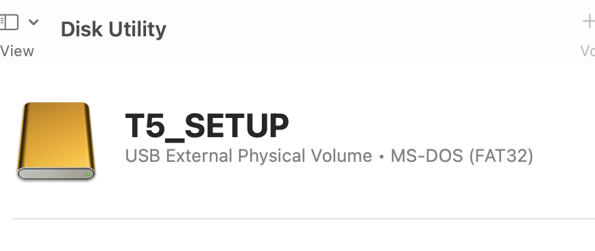

Is this a problem? ...

What made you install it? What is it exactly that you're trying to do? As I said the T5 does not require a driver when used with macOS.
The Samsung T5 comes with a USB-C cable which fits into a Thunderbolt 3 connector, and it also comes with a USB-C cable that fits into a standard USB-3 port on your Mac.
There is no requirement to install a driver. Many of us are using the T5 without the need of a special driver.

Is it because I had set a password? Does that make it encrypted? (I don't fully know what that means but from the reading I've done, that's what I figure). So what I'm trying to do is to use my Samsung SSD T5 on my brand new MacBook Air M1. I had been using this Samsung SSD T5 on my old MacBook, but I bought a brand new MacBook so now I do not have my old one anymore. I have saved ALL my files on my Samsung SSD T5, and did not transfer anything at all from my old MacBook to my new MacBook because I was going to just transfer it all straight from my Samsung SSD T5. However, when I plug it into my new MacBook, it tells me I need to download this driver and when I do so, it tells me it is not compatible as seen in the pic I posted. Furthermore, I went to check Utility Disk as per what I have read online, and I noticed that my Samsung SSD T5 is of the format MS-DOS (FAT32). Is that the problem?? PLEASE help! I cannot lose all my files and my precious photos.
Does that installer pop up when you connect the drive? If so, just quit the installer. Then open finder and look for the T5 disk on the left hand side. Click it to open it. Do you see your files and folders?
I think it has an installer that auto starts. I would probably delete it, but first I would copy my files over before I deleted anything.

Okay, that makes more sense. No, setting a security password for the T5 does not make it encrypted. Do you remember the password? If so, enter the correct password and then you should be able to use the T5.
Note though.... that you can not use the MS DOS format with your new M1 MacBook Air if you want to use the T5 for Time Machine or backing up. So make sure you copy all the files off the T5 first, then use Disk Utility to erase it and format it as APFS.
