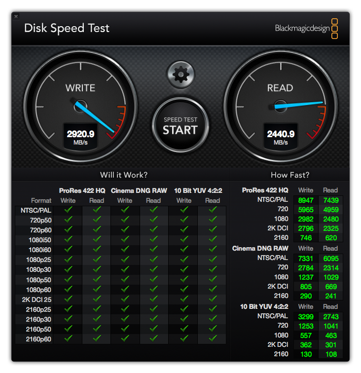

here is no way in h--- that an external SSD is going to be anywhere near the speed of the internal SSDs on the iMac Pro (even the "base model").
iMac Pro 4 TB SSD

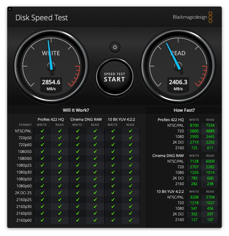

External 2.0TB OWC Envoy Pro EX with Thunderbolt 3
I'd call it a tie.
I should have qualified my statement by saying external "USB" SSD!
But the OP's post was comparing the speed of a USB drive (not thunderbolt) to the speed of the internal drive.
And again, I'll restate -- nowhere near the speed!
Samsung X5 (or equivalent) -- yes.
Samsung T5 - NO.

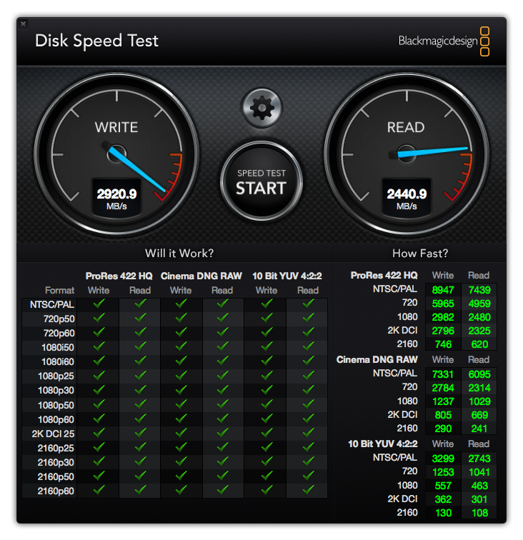

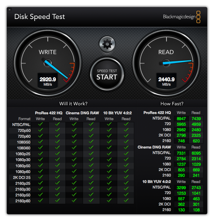

iMac Pro 4 TB SSD

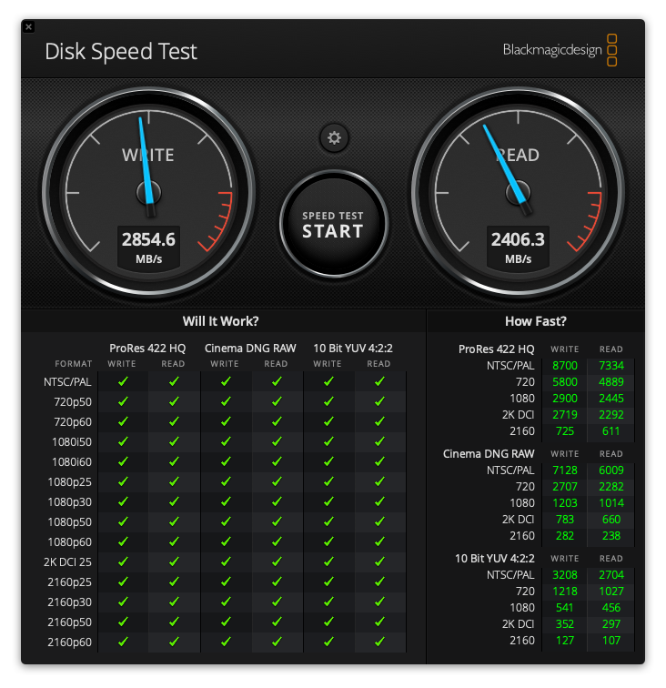

I'd call it a tie.
Nice speed, however you are comparing the iMac Pro's internal NVME drive with an external NVME drive so the speed should be the same. I have the same setup. SSD's, while once thought really fast, are much slower and the 400-500MBs is about right. They are certainly fast compared to a HDD, but not a NVME drive.
