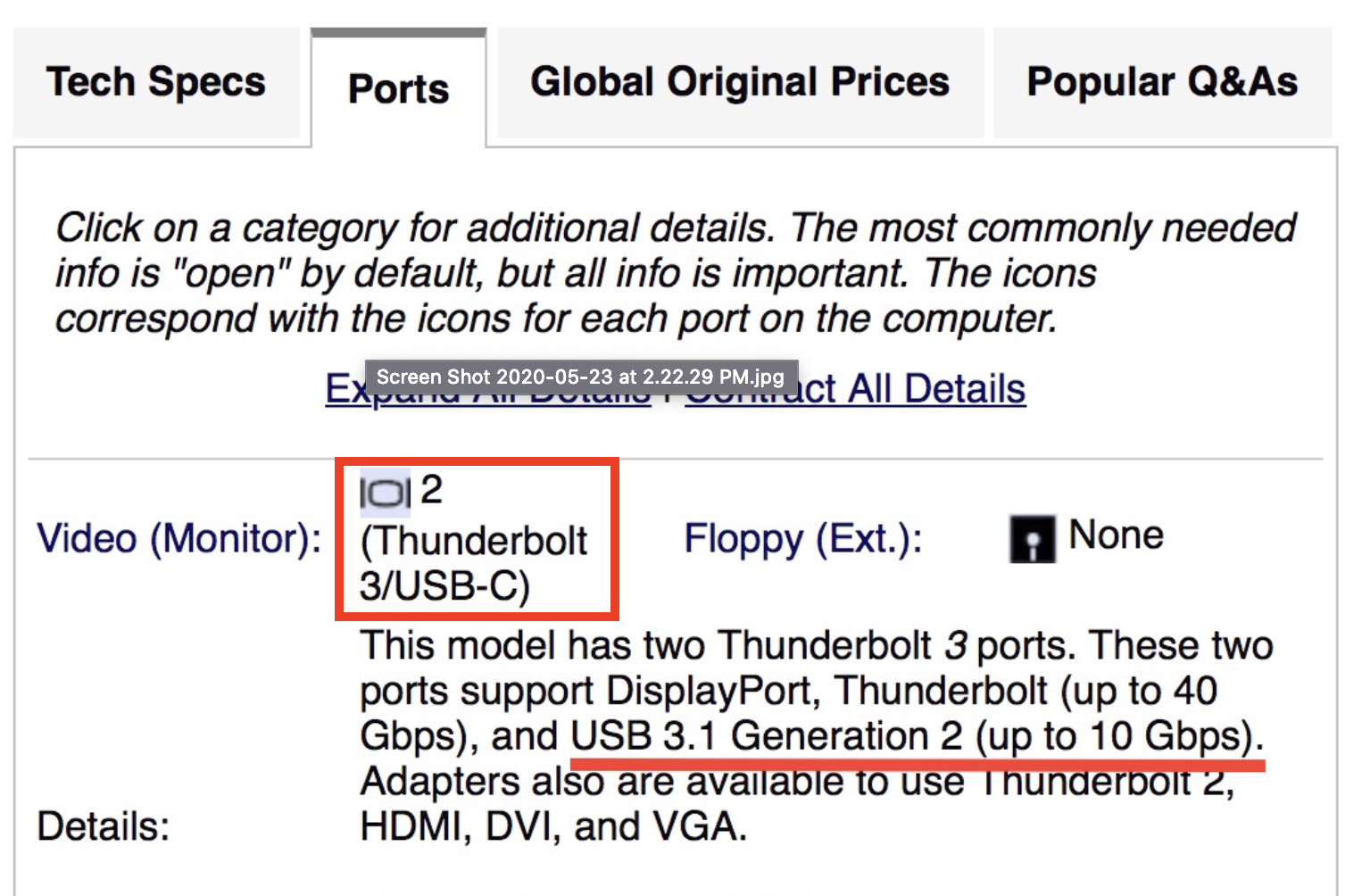

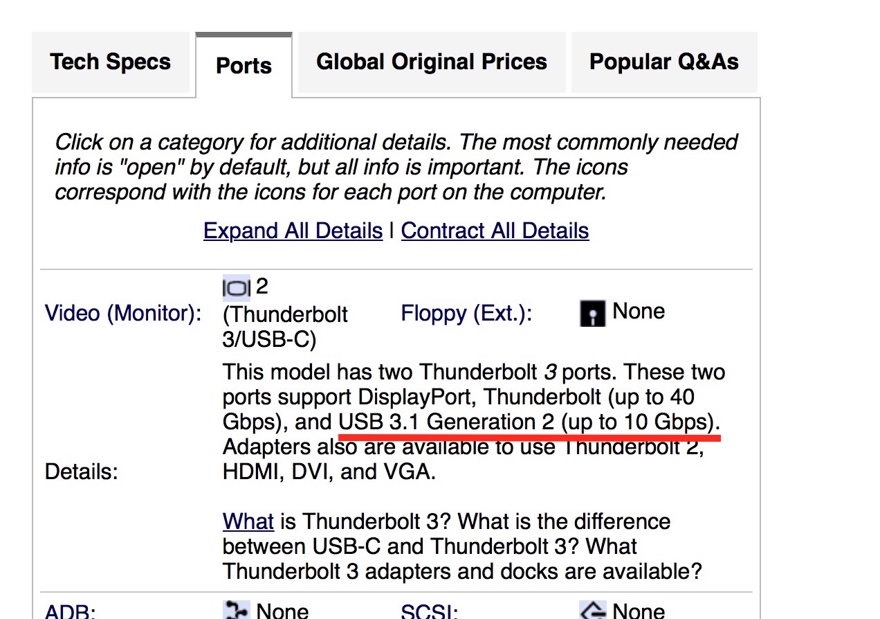

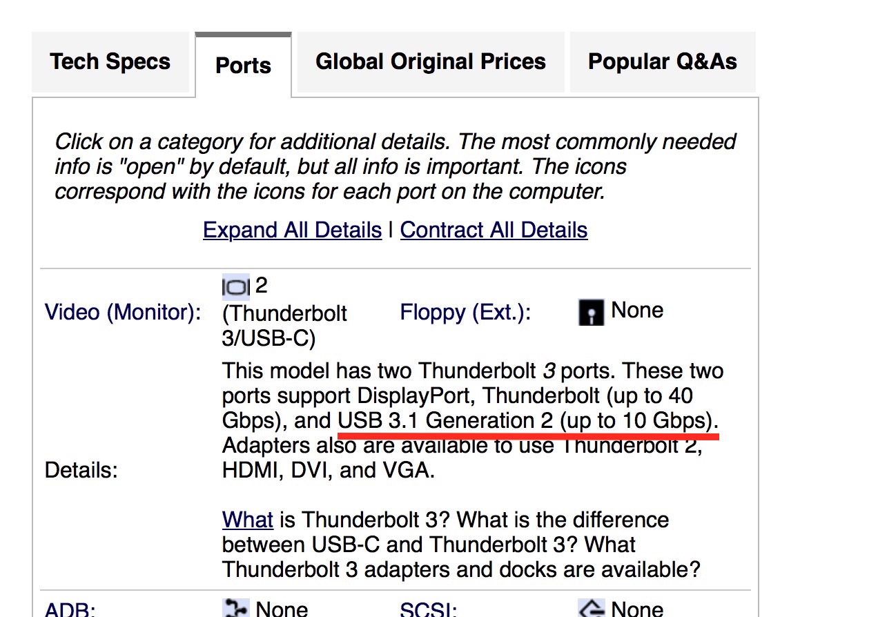

Do you know if by any chance usb ports on imac 2019 are usb 3.1 gen 2 actually?
"The USB ports on the 2019 iMac are only USB 3.0"
No, I believe that's NOT correct.
I have a 2018 Mini (released almost a year earlier) and it has USBc ports that offer USB3.1 gen2 (tested and proven by me).
I just visited everymac.com and looked up the ports on a 2019 27" iMac.
Here's a screenshot of that page:
