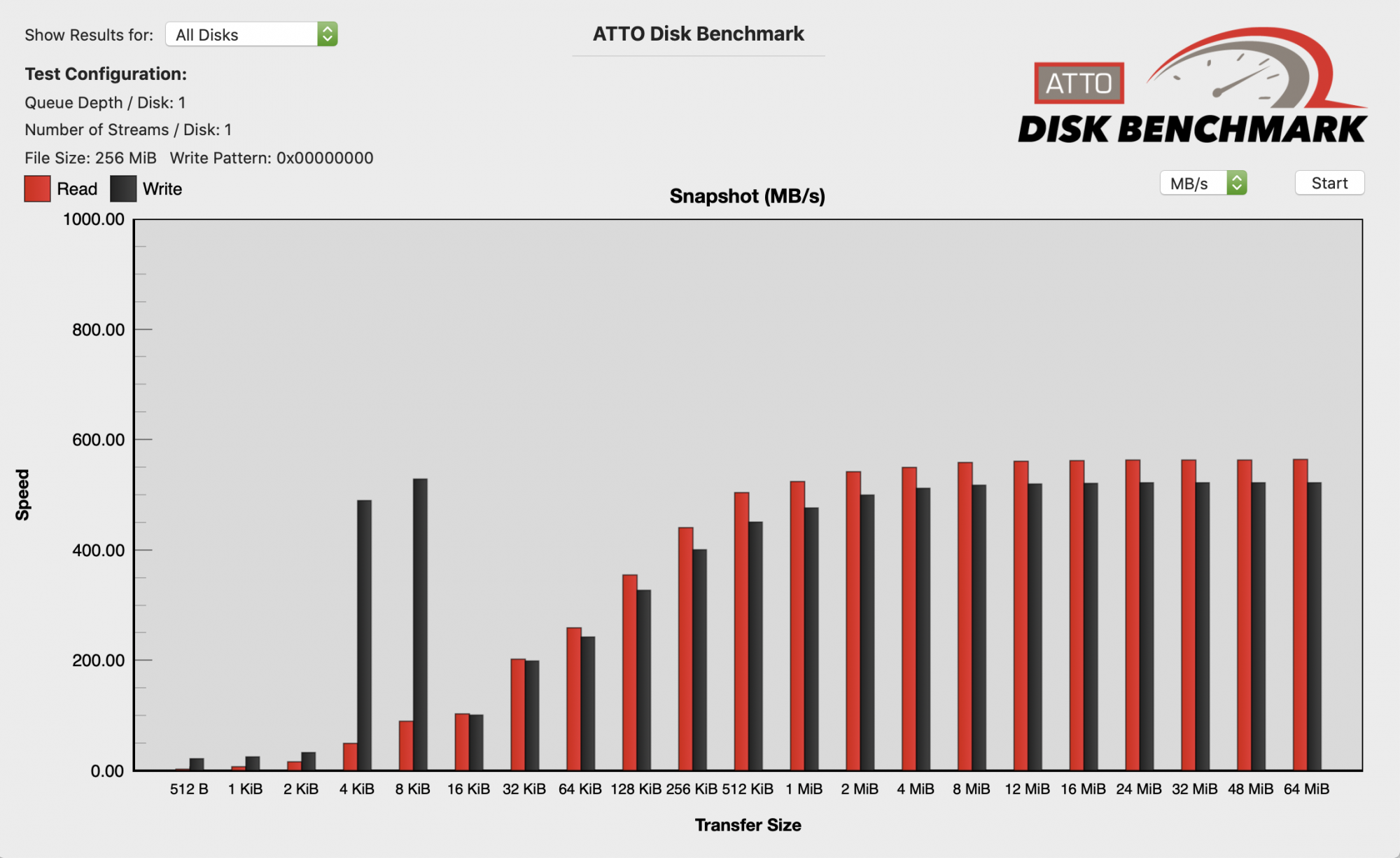

IIRC, the T5 uses a SATA bridge and so its max theoretical performance is the 6.0 Gbps ceiling of SATA 3 and max actual performance at the threshold of about 575 MB/s in the absolute best case scenario (non-encrypted, empty drive, HFS+, larger file sizes). USB 3.2 gen 1 (AKA 3.1 gen 1 AKA 3.0 AKA USB 5 Gbps) doesn't quite get there after overhead, but it can get pretty close with UASP.
This is a 2 GB Samsung 860 Pro, empty, formatted to HFS+, using 10 Gbps USB (tested on a 2019 16-inch MacBook Pro, using an enclosure with a 10 Gbps AS Media chipset)

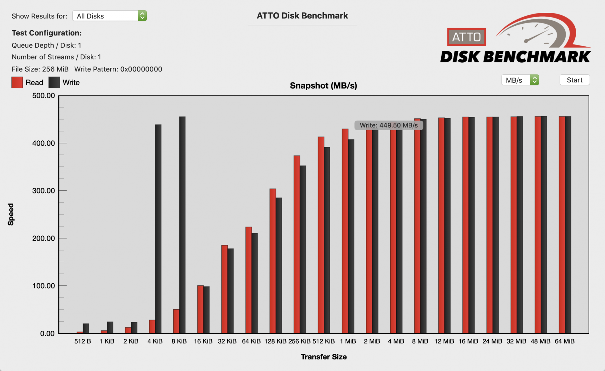

This is the same everything, except USB has been constrained to the 5 Gbps ceiling using an older USB 3.2 gen 1 hub
(scaling of the table is a bit different)
As you see, with larger transfer sizes, you're looking at a difference of about 100 MB/s with reads and a bit less writes. If you are constantly moving larger files, that can be a pretty substantial difference. Obviously these don't exactly speak to the specifics of the T5, but they should give you a general idea of the difference.
