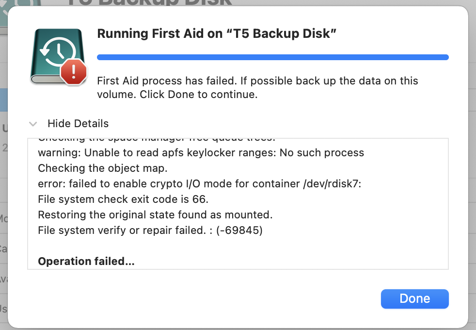

I ran DiskUtility and it is showing that the drive is failing. Not happy.
Yeah, that's what I was getting to when I tried to run disk utility / repair. I'm guessing that the drive is not in fact failing but that there's just an issue with it and the M1 Mini / Big Sur. It's very stressful nonetheless, and so far I've found nothing that seems to fix the issue. The only consolation is that I'm able to mount my T5s to older Macs with no problems. But I'm worried that messing with them so much on the mini and having so many failed repair and reformat attempts can't be a great thing either!

After doing some searching, I think I found out that you can't run DiskUtility FirstAid on a mounted Time Machine drive. It will always fail.
I opened up Time Machine, went back a few days, and was able to open a backed up file. I am less sure there is a problem with the drive.
Can anyone confirm my suspicion about First Aid and time machine volumes?
I'm not sure about Time Machine, but I can say that I wasn't using TM and couldn't perform First Aid. So at least in my case there seemed to be no connection.
