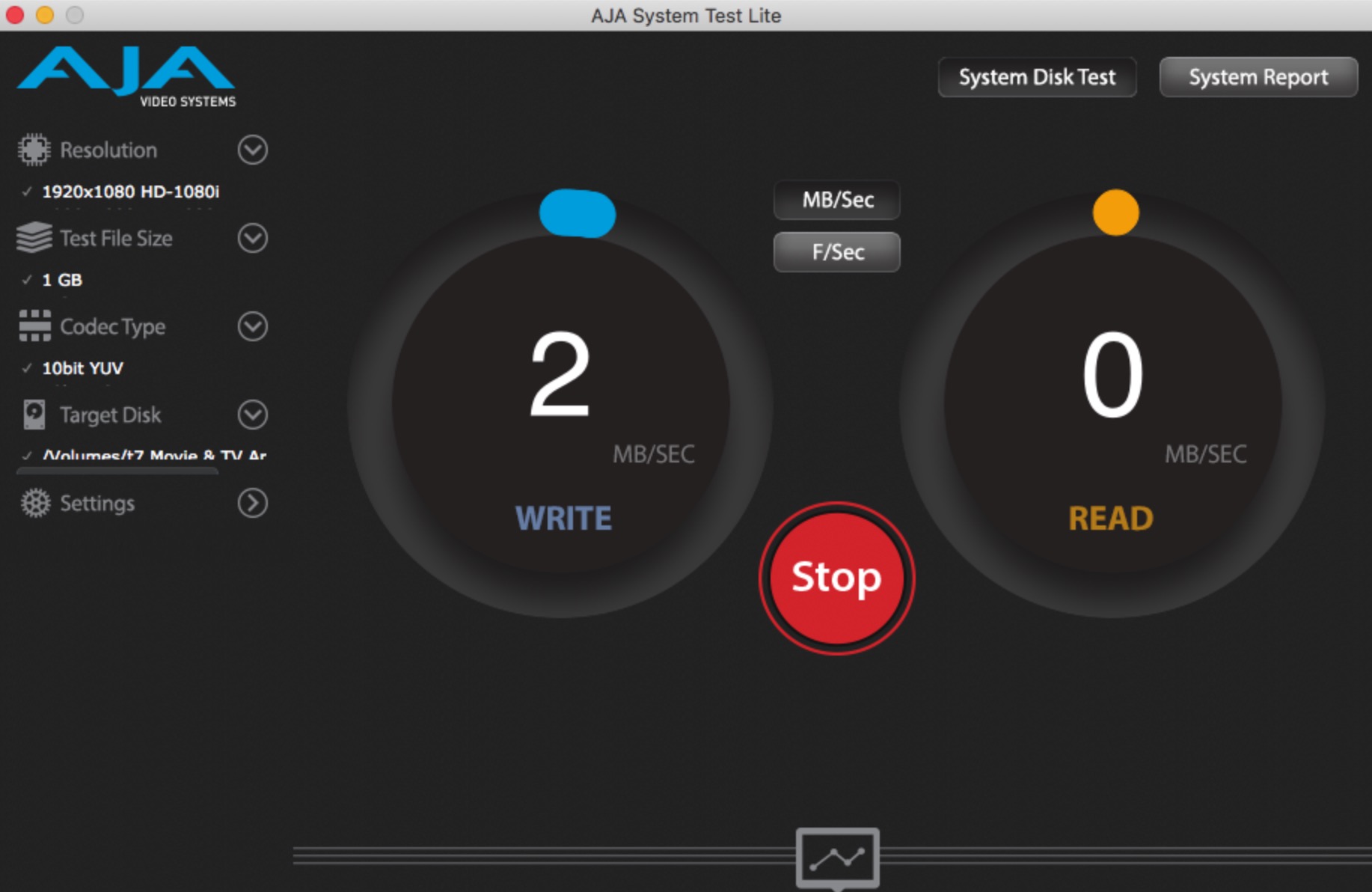

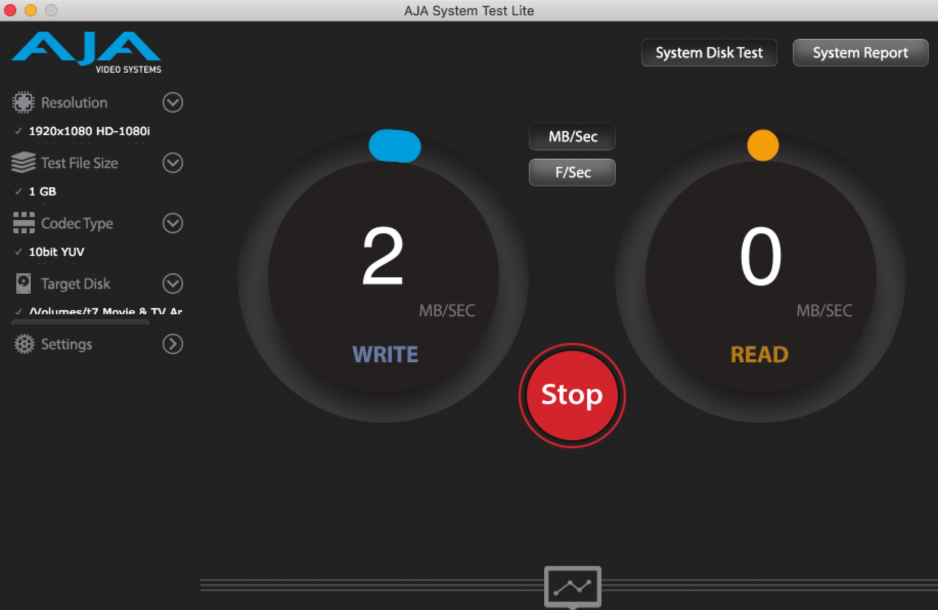

If I run a speed-testing utility on them (I generally use "AJA System Test Lite"), read performance originally starts out as terrible -- sometimes as low a 2-3MBps.
Almost as if the drive won't "respond" at all:

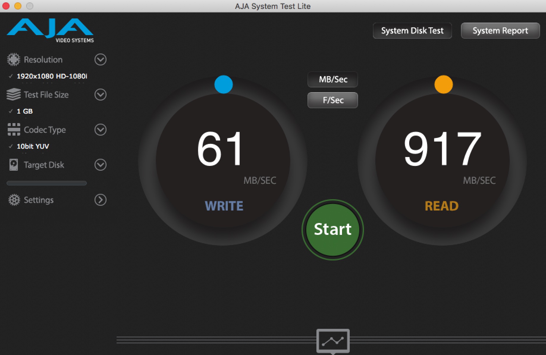

If I let it run, the write speeds will increase a little, then it jumps to read speeds which are excellent:

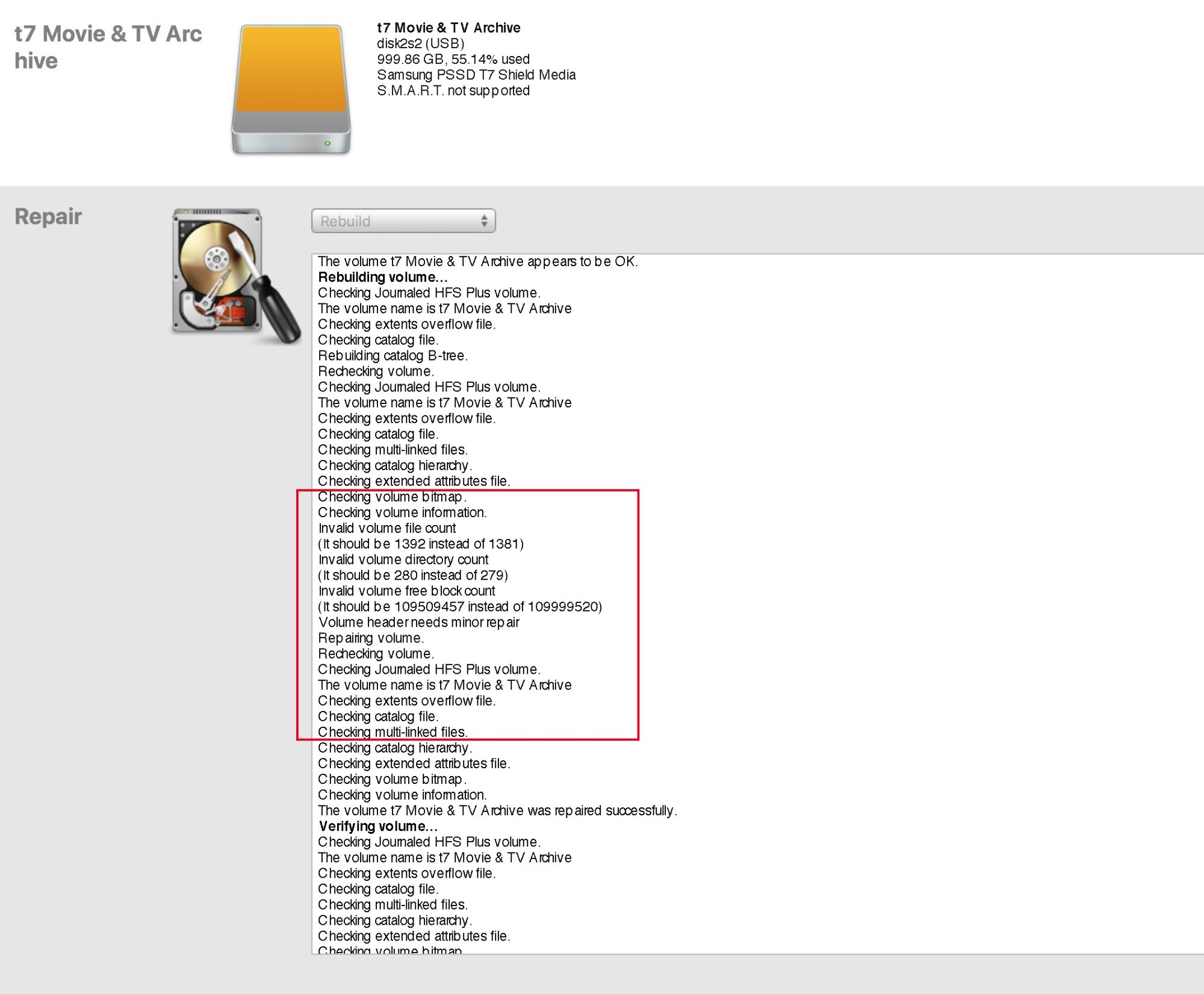

Then, I discovered that if took an old copy of Drive Genius (v.3), and used the "rebuild" feature, it would note some irregularities:
- invalid volume file count
- invalid volume directory count
- invalid volume free block count
... and then would "repair" the volume:

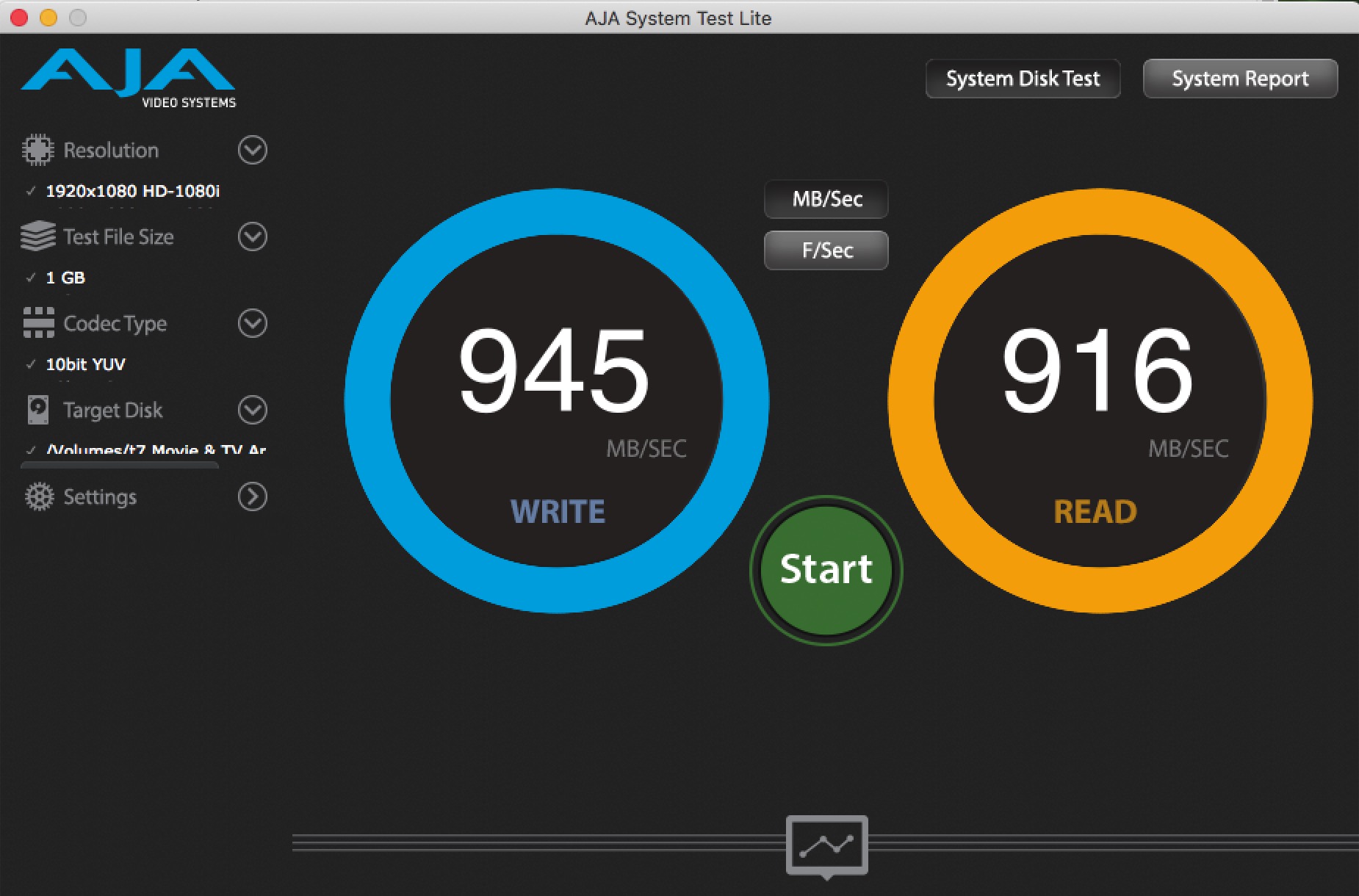

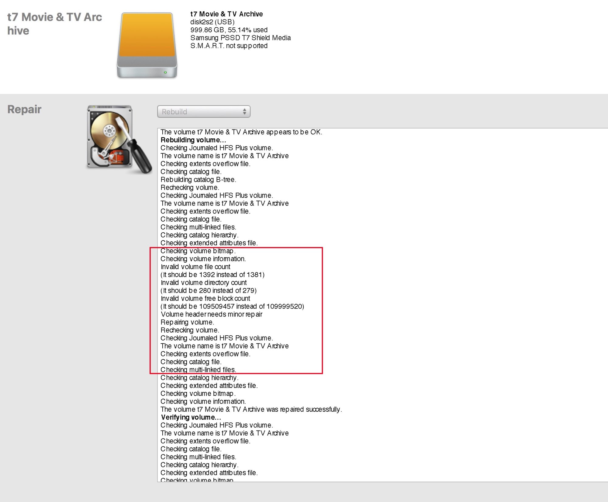

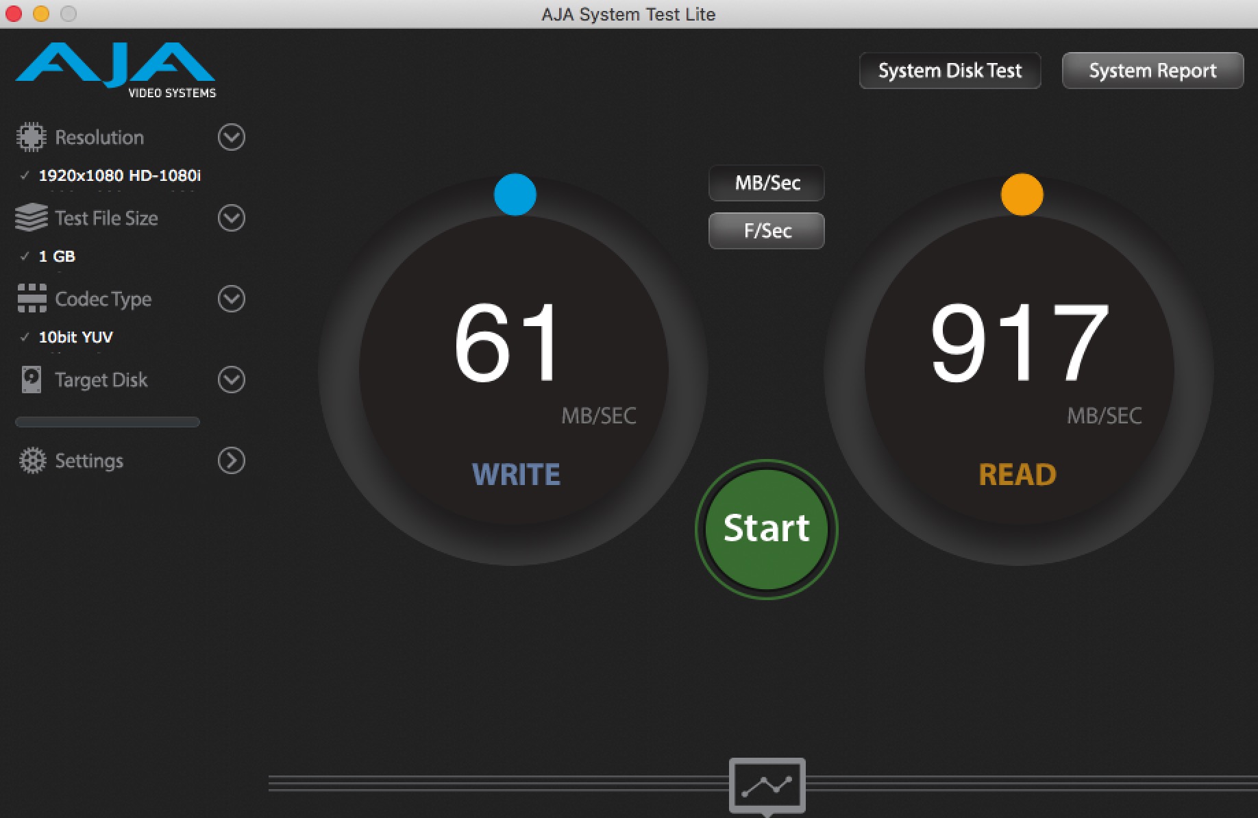

Now I run AJA System test lite on it again:
Much better, as it should be.
