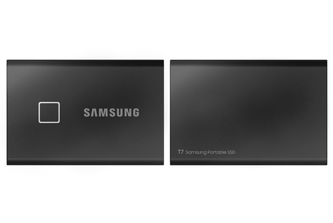

What is the "regular T7"? Samsung site only shows the Touch and the T5.
it was announced at the same time as coming later. Same performance as the T7 Touch but no touch.
the official Samsung store on JD.com has it for preorder. It’ll be out soon.
