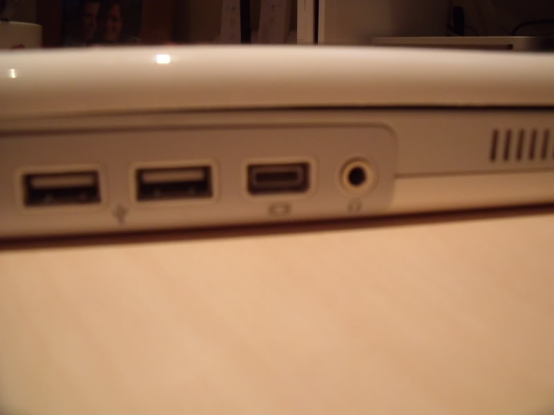

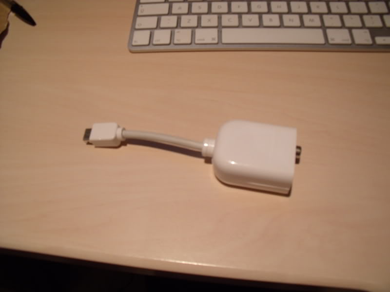

Depends on what type of video port your iBook has. I'm guessing it's mini-VGA. If your TV has a VGA input, then you just need the mini-VGA to VGA adapter, and then a regular VGA cable. Then select the correct input on your TV remote and adjust the resolution as necessary. You'll probably have some overscan.

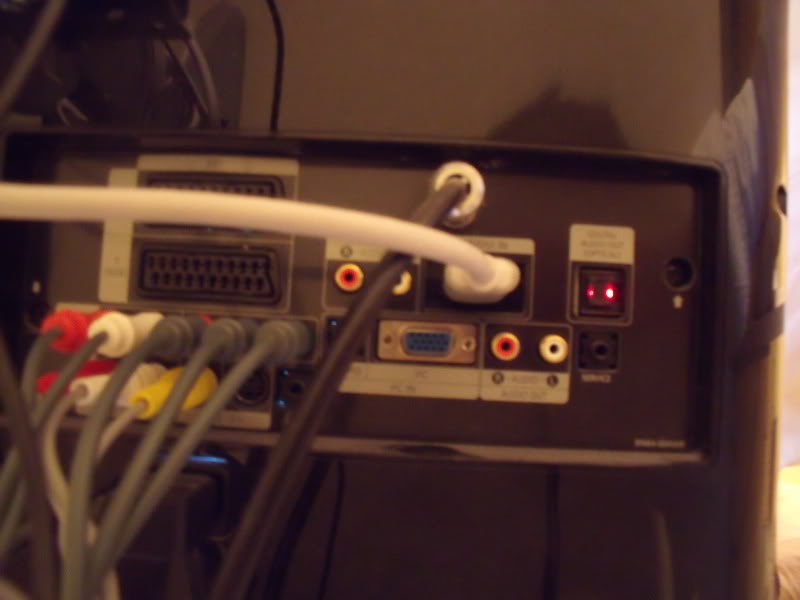

Yup, most Samsung TV's should have a VGA port on the back (it's the blue one just beneath the HMDI port and right of the Component)...
Then you head to the Apple store and buy something similar to this for about 20Bucks:
IIRC this one is a MiniVGA to S-Video or AV but as spice weasel correctly stated you will need MiniVGA - VGA which you plug into the slot just left of the audio port:
Oh and unless you have one, you will also need a simple VGA cable...
