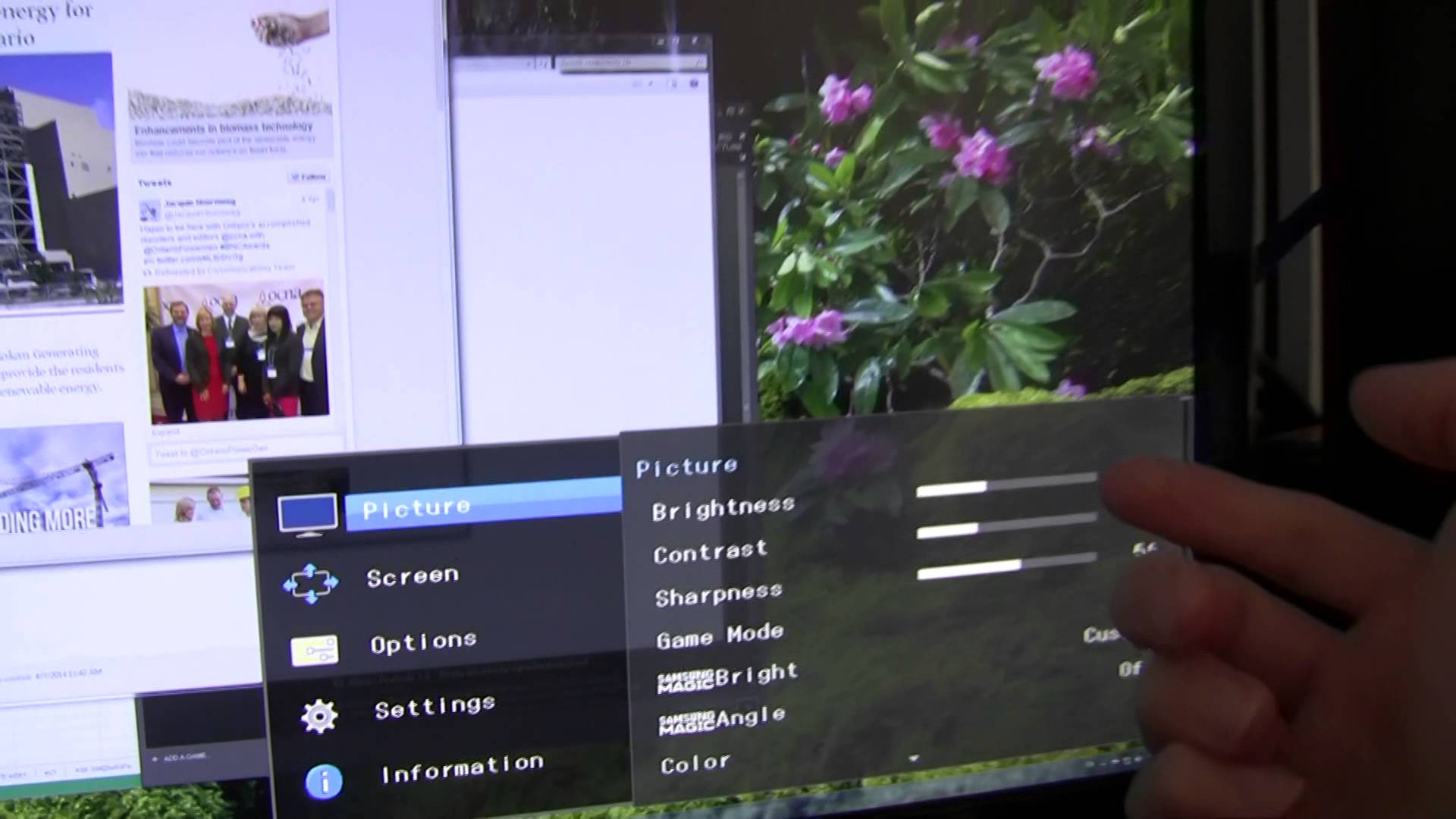

On the U28D590D, the button that you use to navigate the menu is on the lower back of the monitor on the right side.
Step 1: Press the button on the back of the monitor and this should show up on the bottom right corner of your screen:
Step 2: Use the button to go up and click on the icon that looks like a gate. You can see the icon in the previous picture.
After doing that, this will appear on your screen:
Step 3: Go down to Settings and click the button.
Step 4: Now you should see "DisplayPort Ver.". Go down to it and click on it. This will give you the option to choose between 1.1 and 1.2. For your mac you should choose 1.1.
That's what I did, but there is no DisplayPort menu, and I didn't find any firmware update on Samsung's website.
I checked on the back of the screen, it's a U28D590D model.
Have you tried scrolling down within the settings menu to see if there is a second page? I know that if I go into the settings and scroll down that there is a second page.
No, there is not a second page. There are two pages in the "Picture" menu, not in "Settings".
There is a small arrow on the bottom of the first page, notice that this arrow is absent on the settings menu:
