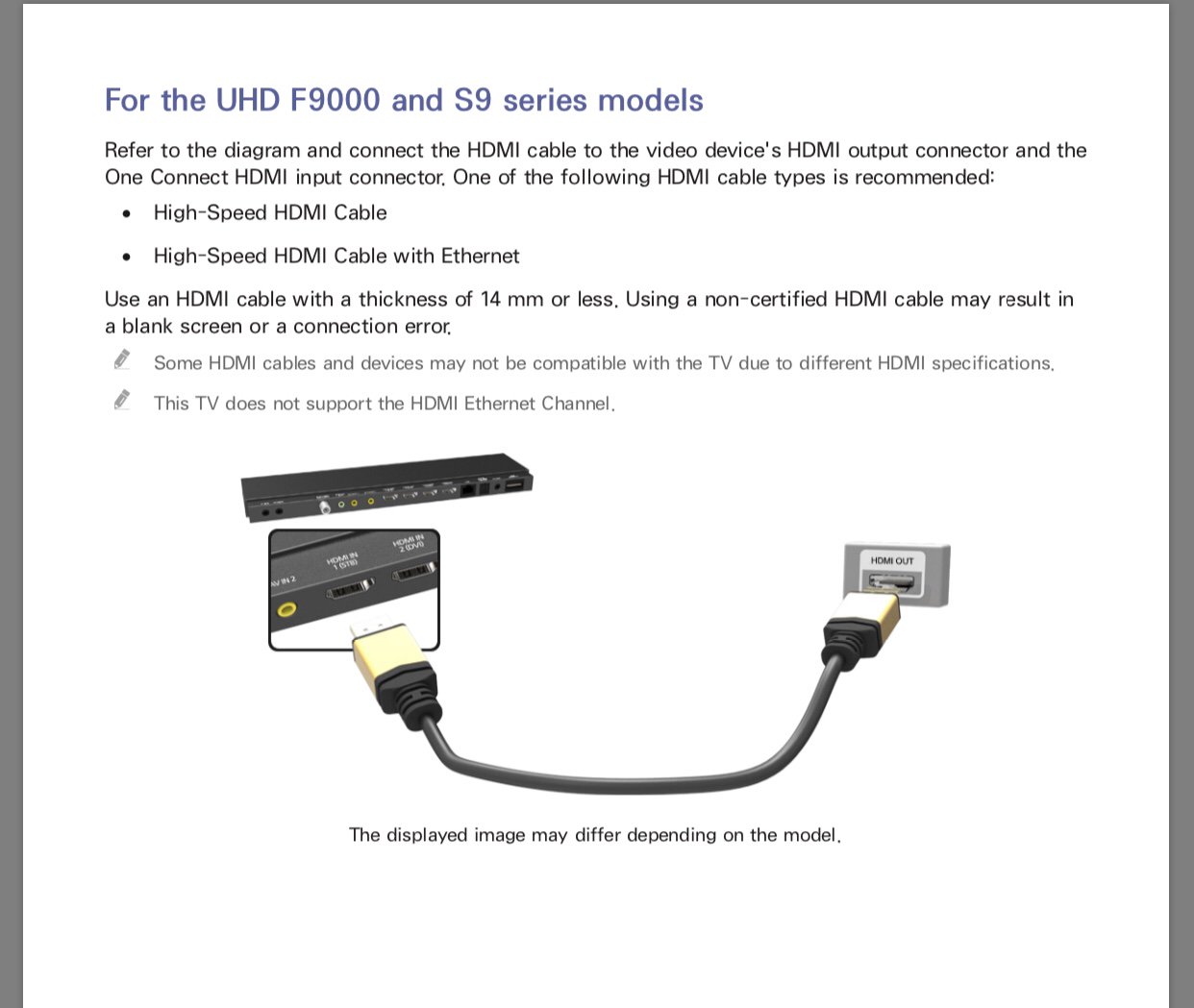

Not sure whether or not this is relevant as you’re definitely seeing something but the manual does mention about some HDMI cables and devices not being compatible.
