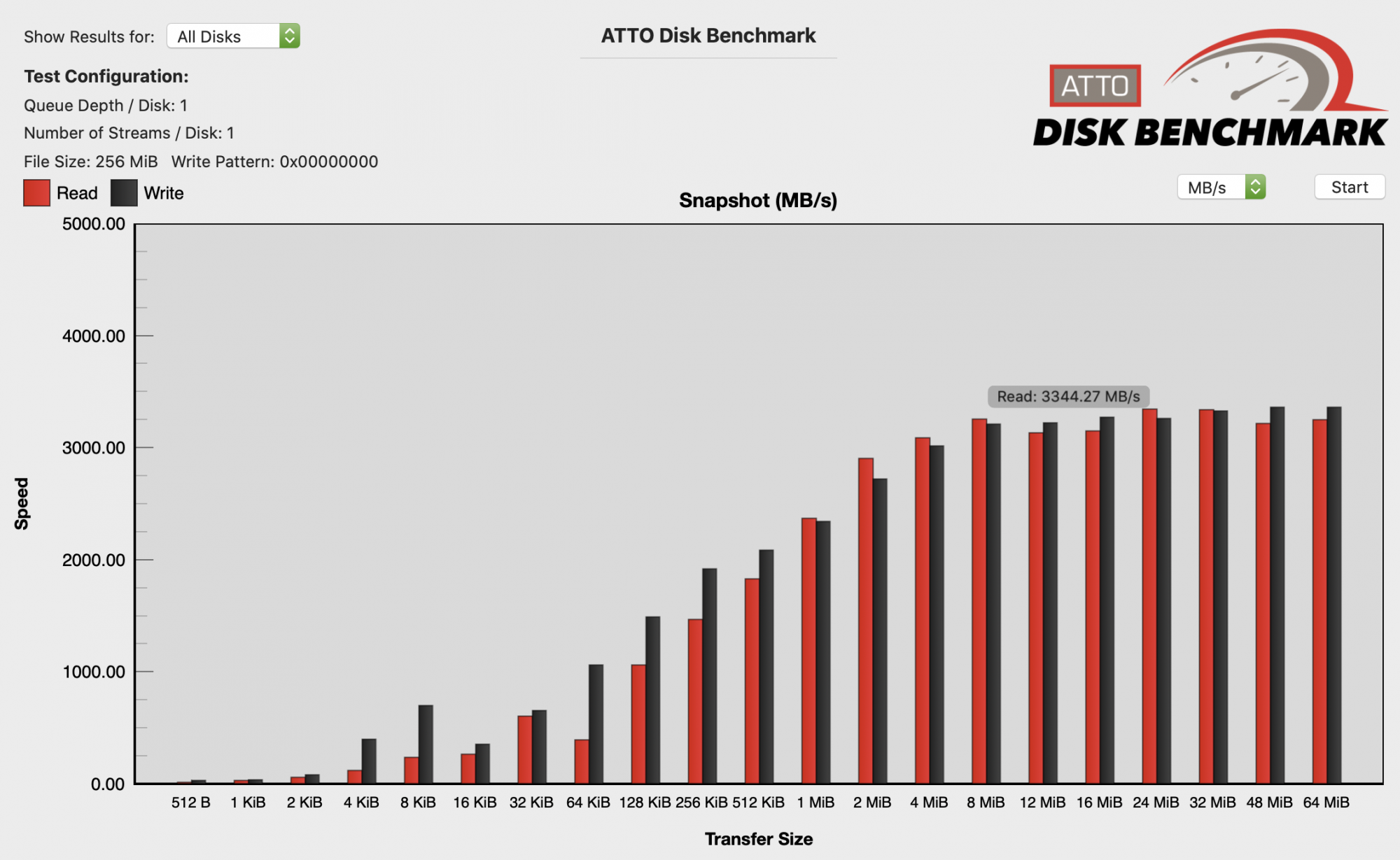

Use ATTO Disk Benchmark, it'll give you far more accurate results. Also, a brand new, empty SSD will always be faster in benchmarks because the controller knows that the pages are empty and have never been used, so it will just return a string of zeroes without actually reading the block. Essentially sending you synthetic data and saturating whichever bus you're using (SATA, PCIe, USB).
This!
The individual attributes of the file(s) being written have a massive impact on speed. ATTO is significantly more comprehensive in testing this than Black Magic.

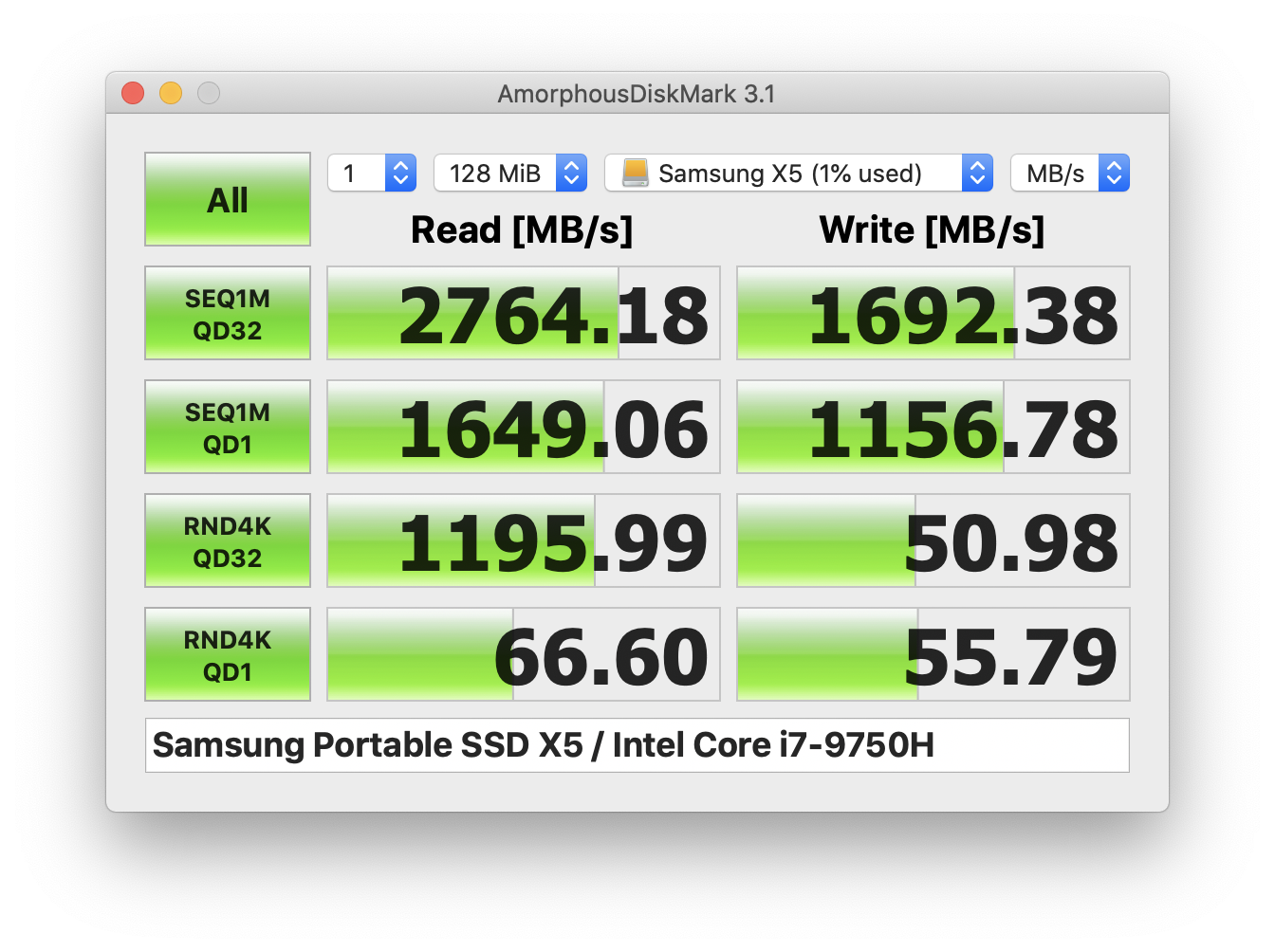

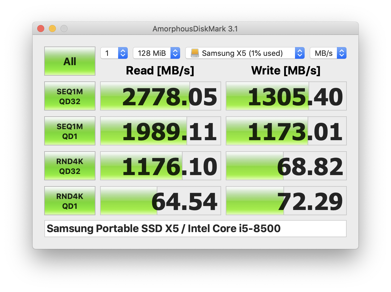

It seems like the slower sequential write speeds are a problem with the iMac 2019 itself. Here are my benchmarks for Samsung X5 512GB.
iMac 2019 (left) vs Macbook Pro 16" (right).
I don't care so much about the sequential write speeds anyway, as I'm going to use it as a boot drive. The 4k random writes and read are even faster than on my Macbook Pro. And even better, I got the drive on sale for only 100€ including shipping and tax. 😎
