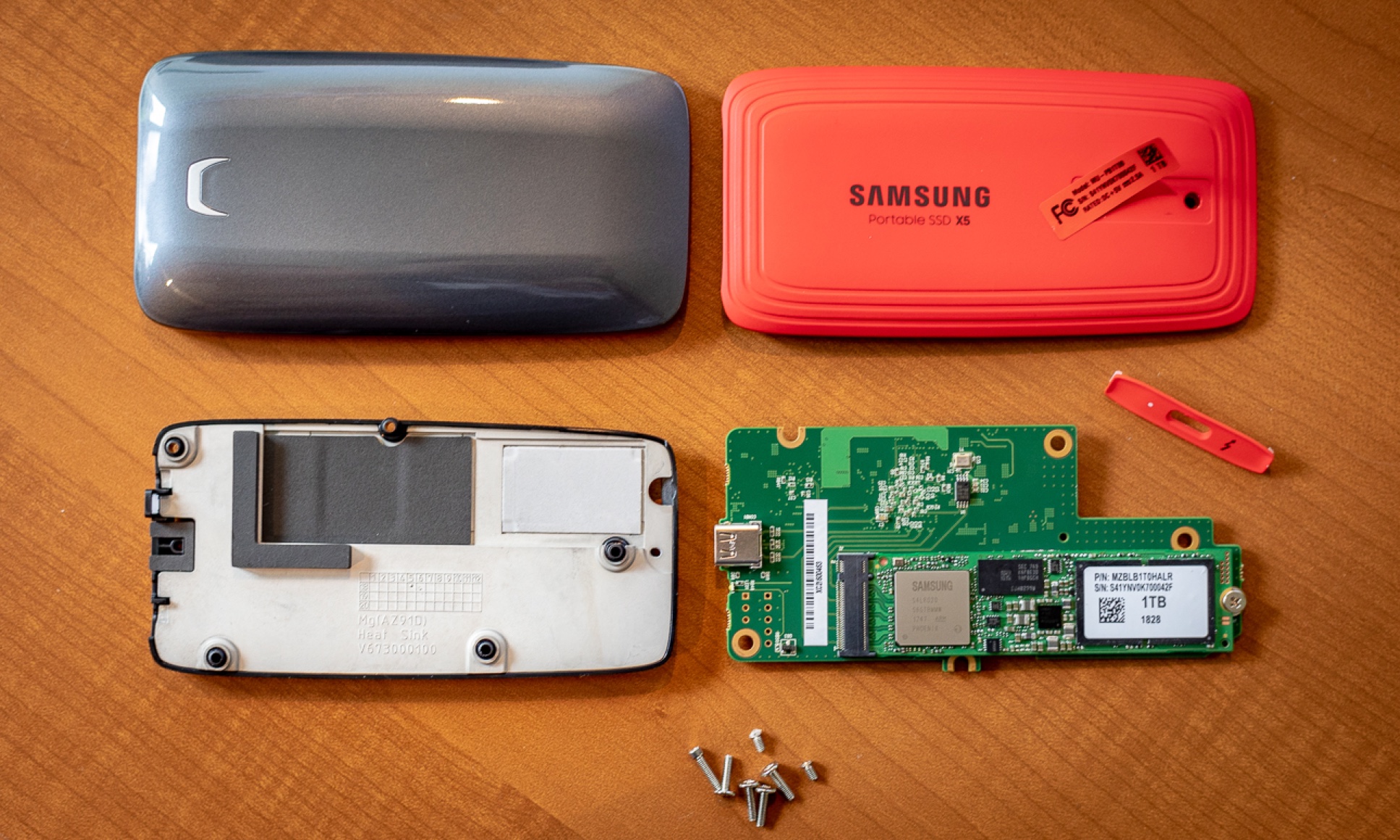

Can anyone else confirm that the newer X5 cases are glued? I am also attempting to buy the 500GB and upgrade to larger capacity.
The newest Samsung X5 drives have started gluing the enclosure shut at the far end (opposite the USB-C port).
Maybe you could apply some heat to loosen the glue?
I purchased a Samsung X5 a few weeks ago from Best Buy, and assuming it isn't old stock, mine was not glued except for the trim around the TB3 port. Getting that trim off was the hardest part taking it apart, although if I had to do it again, I could probably do it quickly. I messed up the case a little trying to get the trim off with screw driver. This was after trying to get it off with a few plastic pry tools.
I ended up trying a razor blade, and that worked for me very easily.
There was no glue on the opposite side, and even if there was, I doubt it would be hard to work it loose, especially after heating it up.

I can confirm that using the 970 EVO Plus does work. I just did it, and work worked fine.
I was unsure whether or not to leave the label on the 970 EVO Plus, thinking that it would be better to have better contact with the heatsinks and thermal pads with the label off, so I ended up removing them.
As for performance on my Late 2012 iMac with TB1, it has slower read speeds than the stock NVMe in the X5 and very slightly increased read speeds. Write/Read @ 715/890 MBps.

I needed a fast high capacity external SSD for my new 2018 Mini for storing and editing a very large number of digital images. I was looking at the Samsung X5. The Samsung X5 2TB Version is currently selling for around $1,200.00 down from $1,400.00 but still very pricey.
So after doing a little research online I found it possible to upgrade the internal NVMe M.2 SSD. So I bought the 500GB version of the X5 for $300.00 and replaced the SSD with a 970 EVO 2TB ($540.00). I was able to sell the new original 500GB NVMe SSD for $100.00.
So I ended up with a 2TB X5 for a total cost of $740.00. A substantial savings of $460.00.
The SSD swap was very simple and took maybe 15 minutes.
