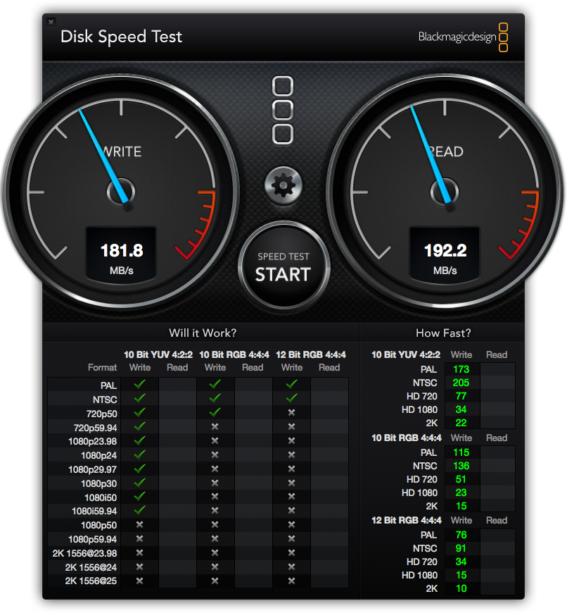

I have a 240GB OWC SSD with a 500GB Hitachi SpinPoint in a DIY FusionDrive in my MBP.
No problems.
Two notes:
Make sure you have version 5+ of the firmware for your Sandforce SSD.
Enable TRIM via the method of your choice. I used Grant Parnell's PERL script to enable mine.
Straight SSD performance was 560MB/sec reads, 518MB/sec writes, Fusion Drive is 192GB/sec reads, 145MB/sec writes. I have no idea how reliable BlackMagic is testing the FusionDrive.
IMHO, I think Apple is throwing a curve to all the established disk utilities out there. It's going to take a while for them to catch up with the features and gotchas associated with CoreStorage.
Filevault 2 is enabled on the drive.

When data is sent to the SSD it is encrypted already. Any program that sends encrypted data is redundant. Most people do not need to encrypt the data before it gets to the drive. In fact if you let the drive encrypt the data you save CPU resources. Then if you use SandForce the drive is already much faster than all other drives on writes so you benefit from two speed enhancements (1. No CPU load, and 2. the drive writes to SandForce are incredibly fast when you let it encrypt the data)
No problems.
Two notes:
