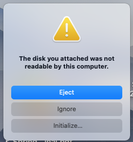

I have a Sandisk 1T SSD, external drive to an iMac (Big Sur 11.7) that just started giving me this message. The Sandisk is less than 1 year old and has been working fine till now. it's formatted as Exfat. This drive has lots of important stuff on it. Is there any way to bring it back to life? I've tried a different USB port, and tried restarting the iMac. - Thanks
Plug it in to a Windows PC, it may be able to repair it. I had the same problem with a 1TB Sandisks and a 2TB. One I had to totally delete the partitions on it from a Windows PC to get it to work again. It's a known problem widely reported. I don't think there ever was a reported fix though. I just got mine by trial and error. And I don't buy that type of sandisk SSD's any more.
Did you buy an SSD and a case separately or was it a whole retail drive?
You could remove the SSD from the current SSD case/adapter and use another one.
Maybe the controller is just broken.
Also using Windows or Linux to check is a good idea - just never click on Initialize ;-)
Try to revive it on a PC, as mentioned above.
I'd get another 1tb drive RIGHT AWAY, and if it can be revived, I'd copy over all the stuff on the drive.

Everything you said was well said except for this one, it will indeed format as a Mac file system, but it doesn't change the fact that it can get corrupted, and since it's a Mac file system, a PC wont be able to fix it. And for whatever reason, the Mac can't fix this SSD either.
I think the drive has a bug in its firmware that makes it incompatible with Macs. After several tries and corruptions, and yes, I tried a Mac format once, I just don't plug it into any Mac's anymore, it's only for Windows PC's, where it works fine.
The time I formatted it as Mac, the only way to get it running on anything was to use Diskpart on a Windows PC, and issuing a "clean" command, which basically deletes all partitioning information, then you can repartition it and use it again.

Your SSD is failing. Try to do a data rescue and use a new disk. Send your SSD to Sandisk service center for a replacement, it's still under warranty.
