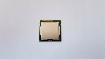

Thanks. Is it a particular i7 2600 I'd need, or are they all the same?
If you feel comfortable enough with the disassembly there’s no loss at least. Performance will go up a little but it’s going to be a very minor difference. - Since they are otherwise identical chips the difference in clock speed should fairly accurately depict the actual performance difference, though keep in mind it’s a base frequency and turbo/multi-core loading will alter results according to burst behaviour. It won’t be like a newer computer’s performance gains since generational improvements quickly outpace higher tiers within the same family of chips, but you’d probably see between 10 and 20% better CPU perf depending on task
So in practice it sounds like it wouldn't make a lot of difference. Maybe the i7 idea is better bet.
Yes just i7-2600 not 2600s or 2600k
Is this the one?
Yes
