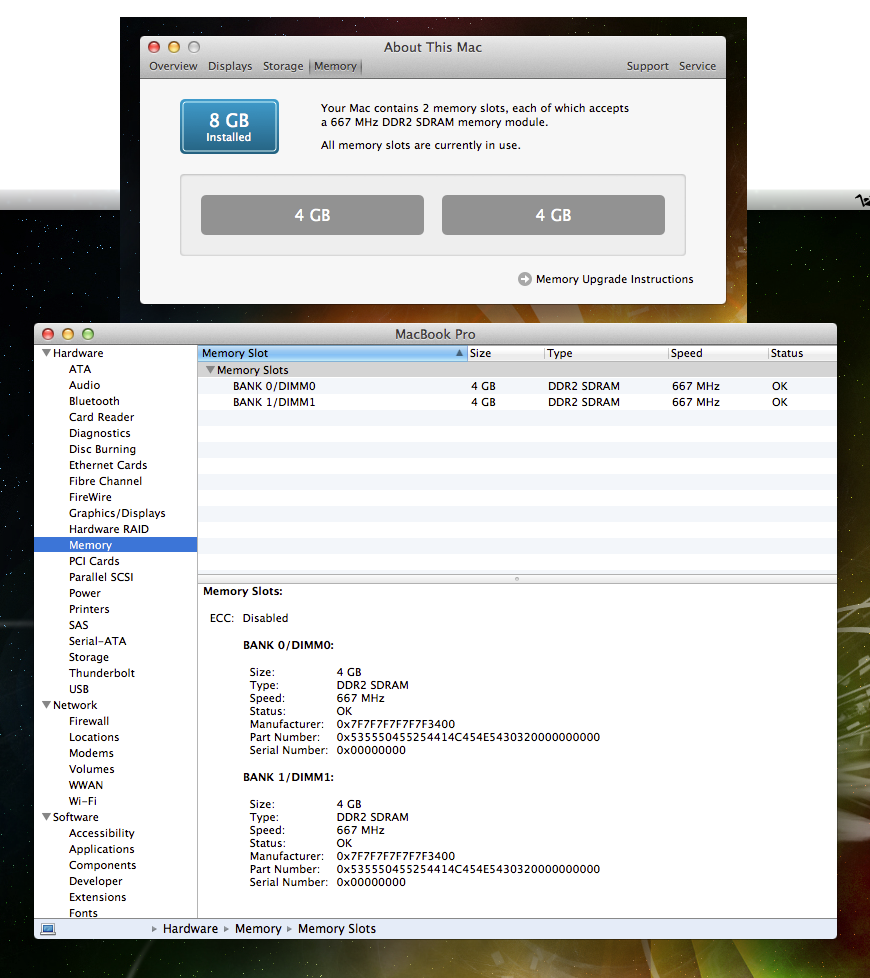

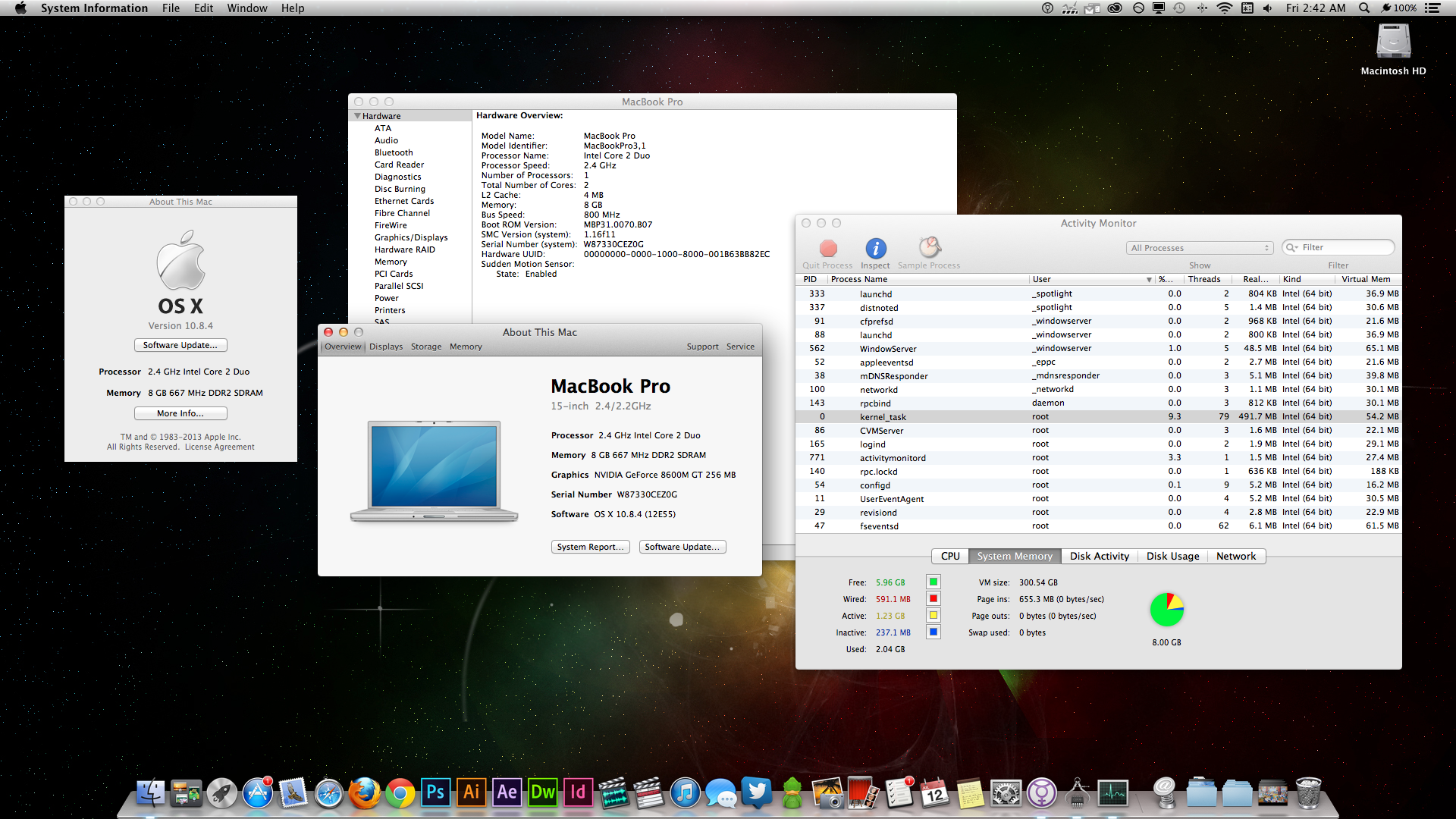

As mentioned, the MBP 3,1 has both EFI64 and 64-bit kernel in both Mountain Lion and Lion. I decided to give 8GB a try (up from 4GB) in 10.8.4. Upon initial boot, my system recognized the 8GB (Crucial brand - 8192MB total) without any problems.

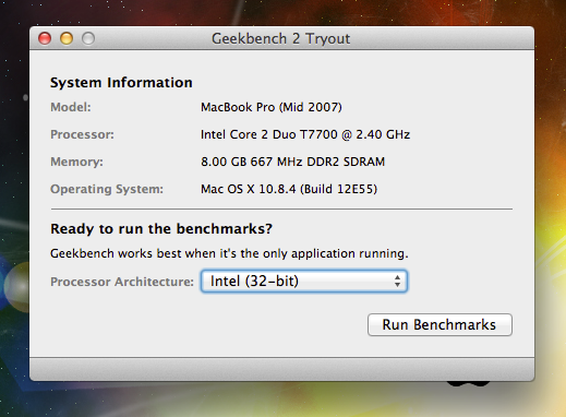

Here's a Geekbench test (average results):http://browser.primatelabs.com/geekbench2/2152107
RUNNING WITH 8GB

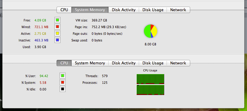

Everything seems normal upon initial booting. Opening applications are also normal, with no real change in experience or performance. While continuing to open apps, I found the system fans would start to rise. This is when things became strange… As suggested by others running Snow Leopard, the system would come to a hard crawl reaching the 3GB - 4GB mark. In Activity Monitor, CPU usage would also skyrocket (around 90-99%). This was never the case with 4GB installed and half the memory utilized.
At this point, tying to use applications, move windows and access menu items were a drag. Though despite the crawling performance, applications would continue to load...VERY SLOWLY. While monitoring the system's performance through Activity Monitor, I managed to use about 5GB before deciding to force quit all apps. Once all applications were closed, the fans would return to normal.
