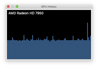

Activity Monitor is nice, but unfortunately I didn't see anything there for the GPU (except select a "GPU history" window).
It doesn't look very helpful as there are no numbers showing that I can use for when modiying the GPU BIOS in Windows.
It would be nice to measure just how much I'm using of the GPU. Is there some sort of GPU monitoring software like that available (for MacOS)?
Most GPU parameters can't be monitored in macOS. Your best bet is OpenGL Driver Monitor, or try to capture something from IOReg.

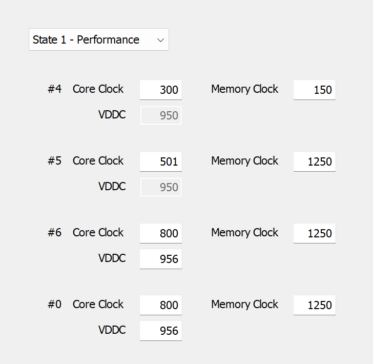

I never use the Vapor-X OC boost, but from my experience, I will start with the following parameters

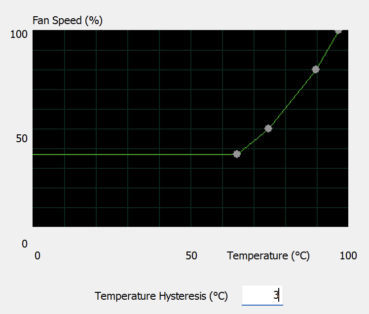

For the fan, if you want to keep the fan noise as stable as possible. But also want max protection. Then I will set the fan profile like this. 37°C to 75°C, 100% at 85°C, Temperature Hysteresis 3°C.

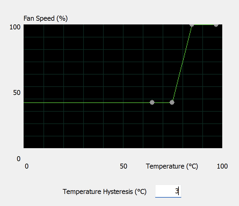

If end up the fan is too aggressive at high temperature, then I will let the fan spin up at 65°C like this.
37% up to 65°C, 50% up to 75°C, and 80% up to 90°C. A smoother fan profile, with default factory protection (100% at 95°C).
