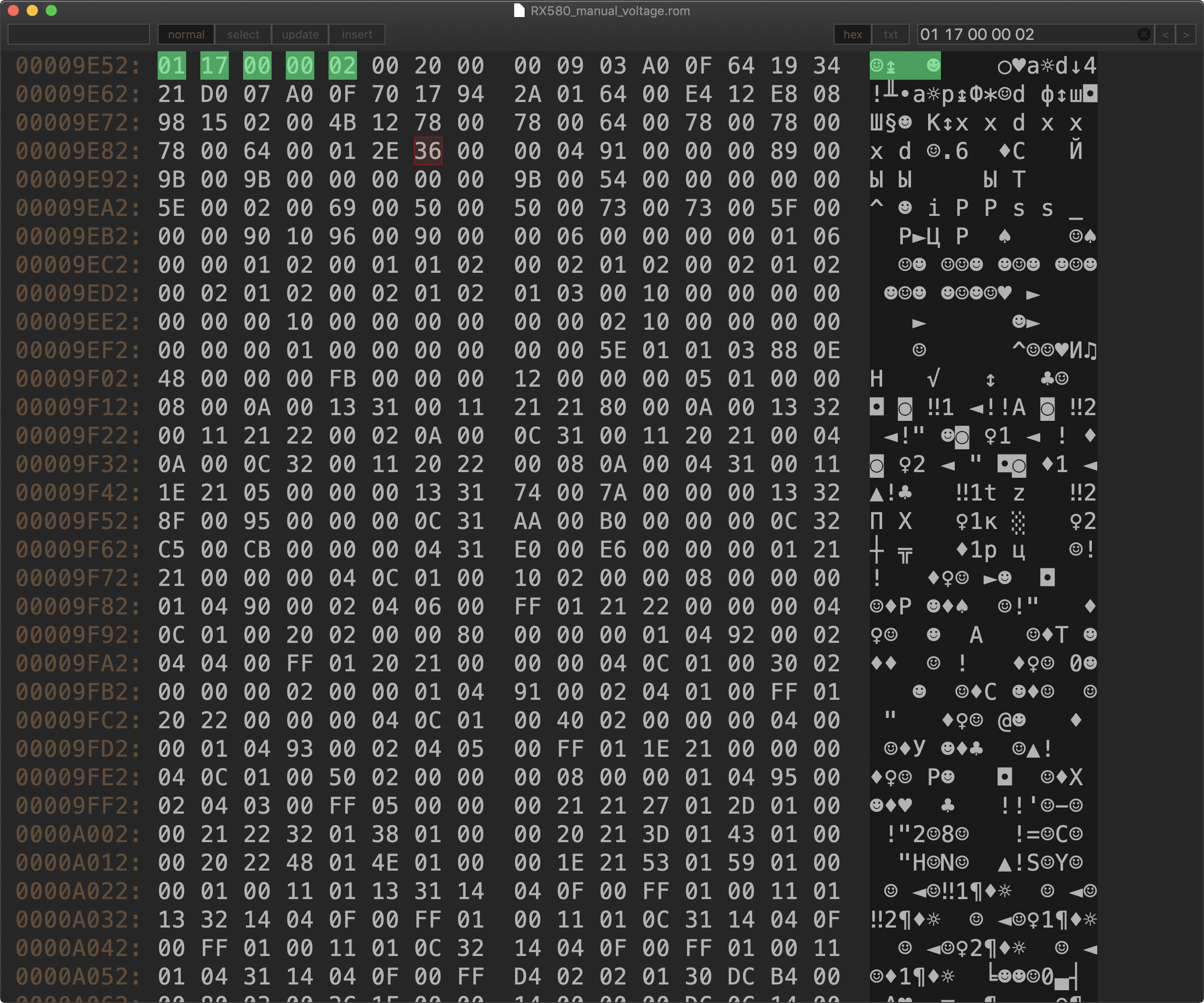

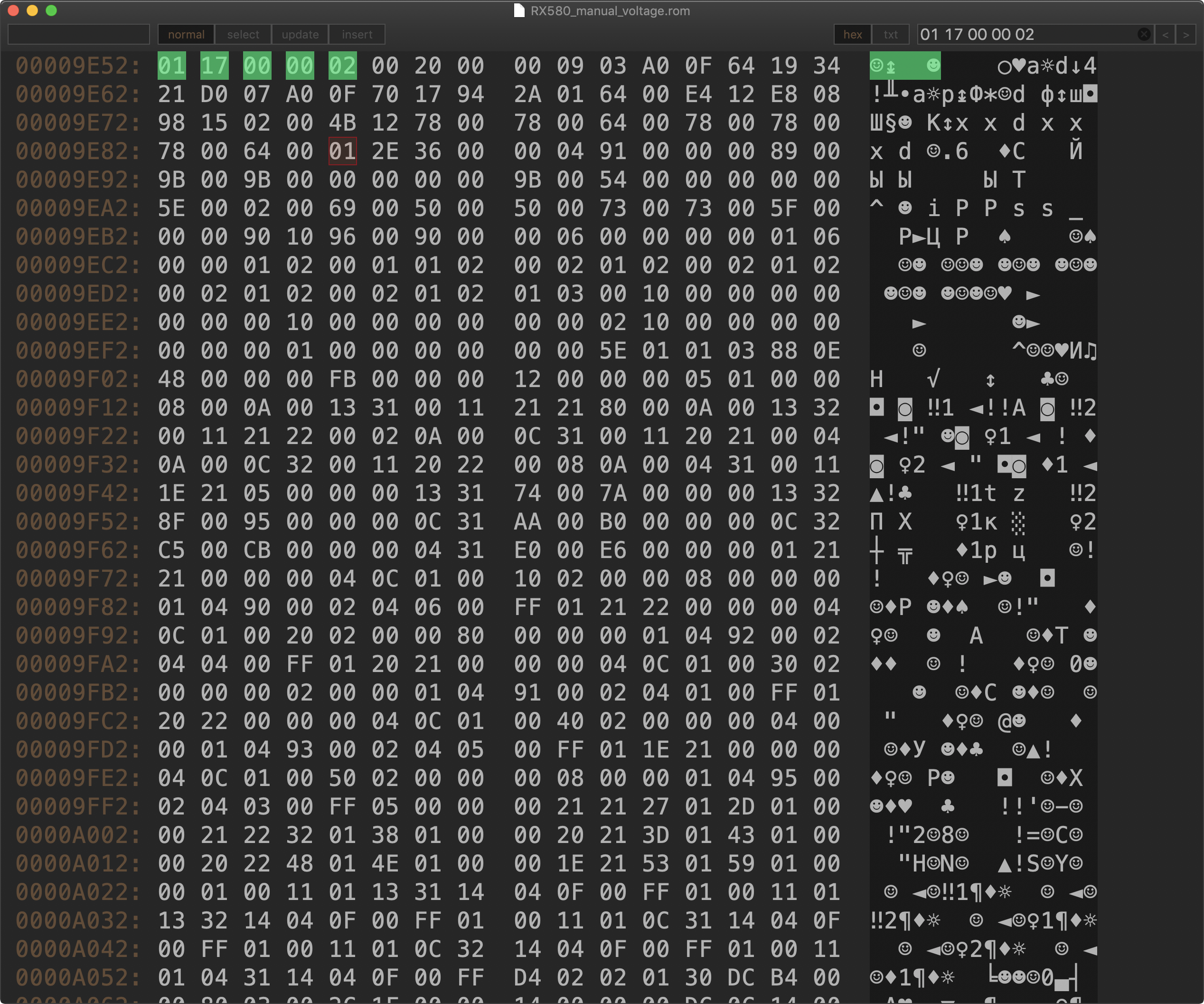

Use any Hex Editor to open your ROM image.
Search 01 17 00 00 02
And 3 rolls below the "02". This 01 means "zero fan mode ON". If you want the fan can stop at certain temperature. Keep it at 01. And if you want the fan always spin, change that to 00.
The byte next to it is the "fan stop temperature". For my PULSE, the default setting is 2E, which mean 46C. e.g. if you want it to stop below 50, then change it to 32.
Last one, the most important one for you. Is the follow byte, "fan start temperature". My PULSE default is 36 (equivalent to 54C). If you want the fan start at 60C, change it to 3C.
And if still doesn't work. Then you may disable Fuzzy fan mode. Change the byte between "max temp" (2A in this case), and "max PWM" (64 in this case) from 01 to 00 will change the fan mode from Fuzzy mode to Legacy mode.
For the PULSE RX580 8GB card. I am 100% the above mod can work. e.g. I turn OFF Zero Fan Mode. And now my RX580's fan always spin, even already below the Fan Stop Temperature 46C, the fan still spinning to assist cooling.View attachment 840258

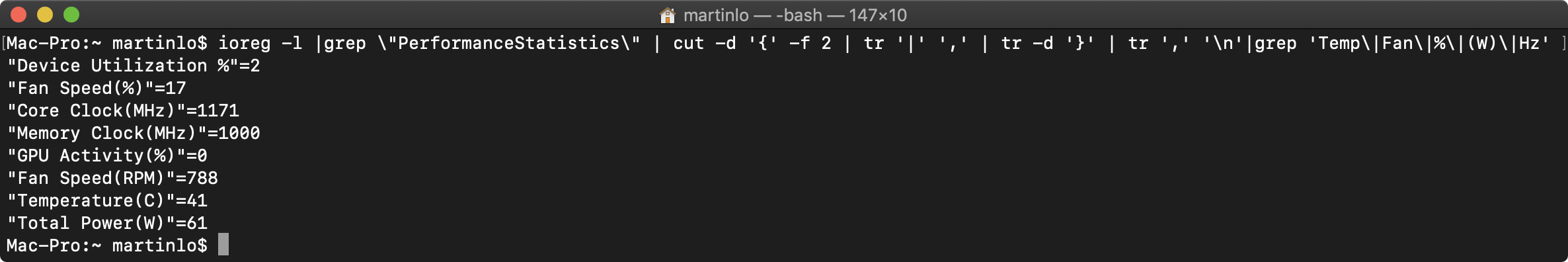

You monitor the RX580's parameters in macOS via iStat etc, and confirmed it follow the PowerPlay table, is that correct?
Reactions: Eschers
It's good to know that.

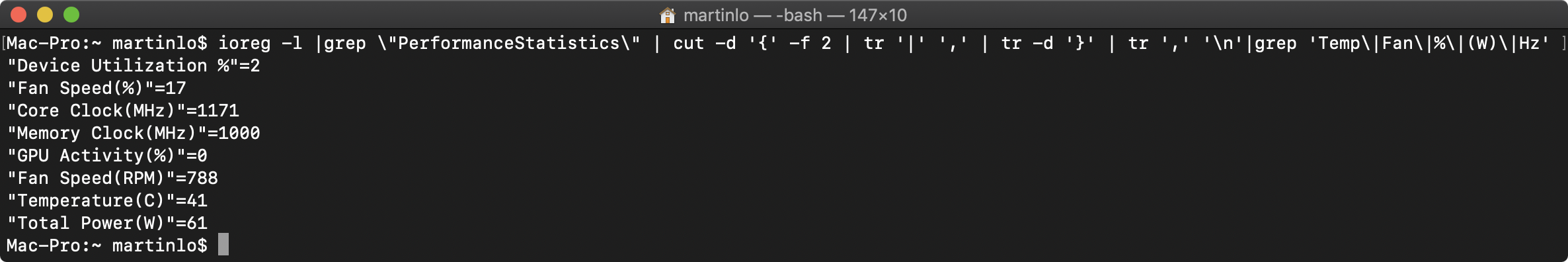

Yep! All works great. I see the fan always spinning at a low speed as configured too. The GPU heat pipes are noticeably cooler of course.

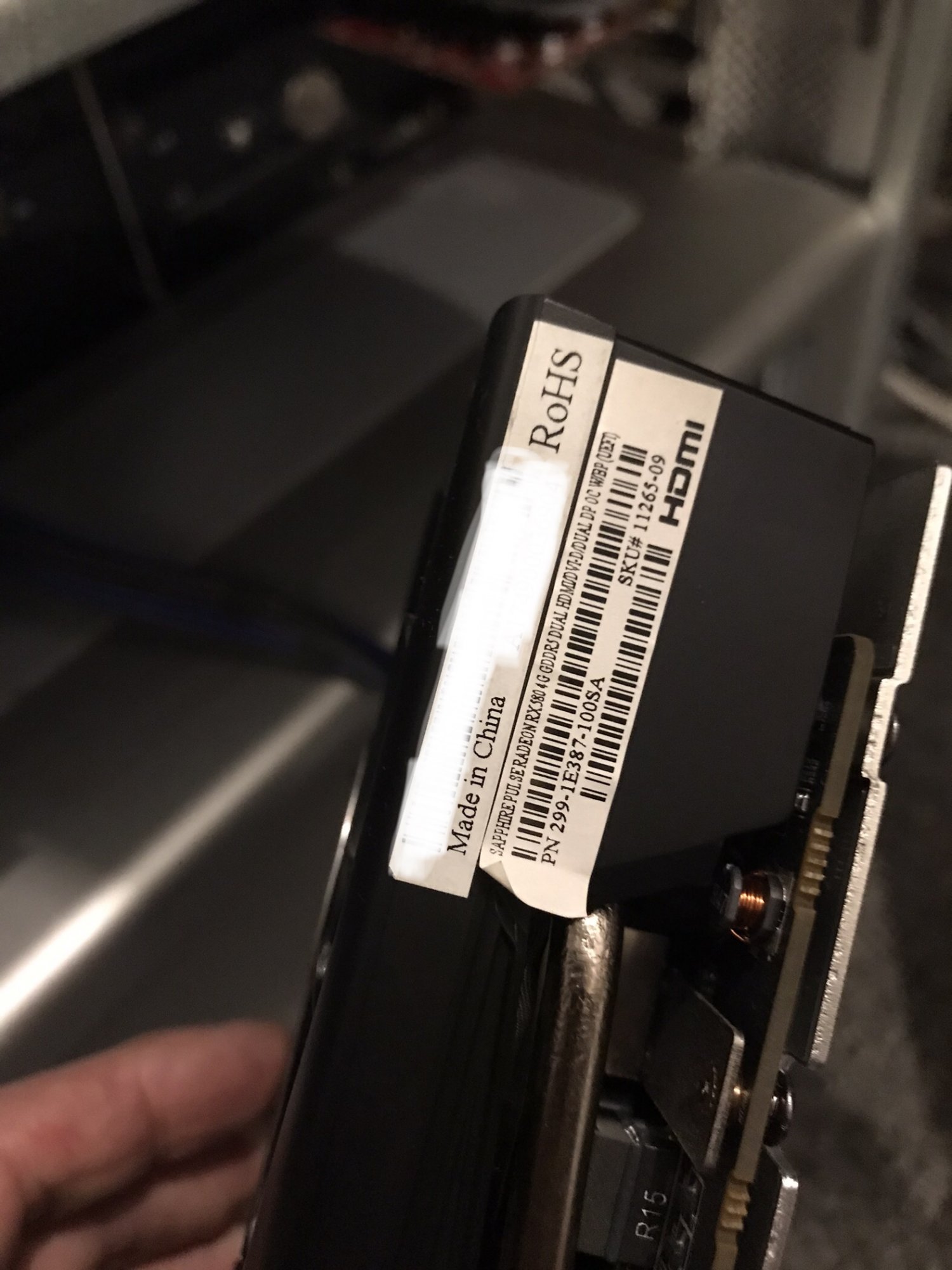

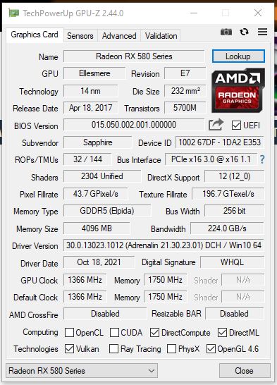

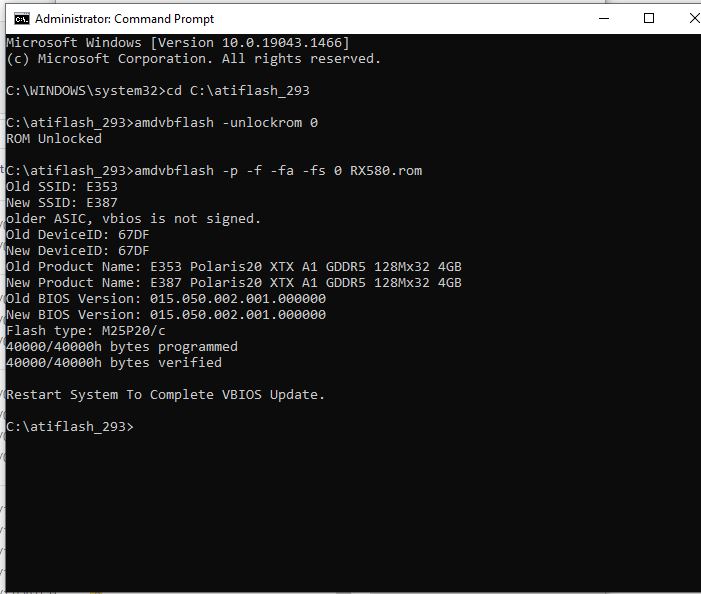

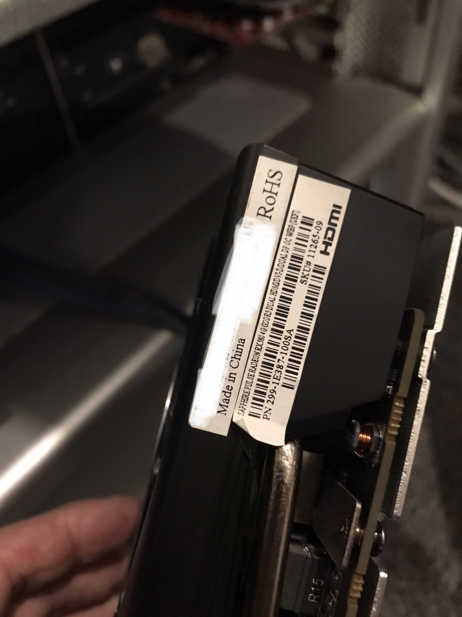

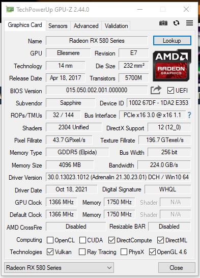

Need a lttle help @h9826790. Ive posted here before about my Sapphire Pulse RX580, i kept the mining bios that was on the card when i recieved it, however now its causing an issue with OpenCore not displaying the picker.
Ive reflashed the below bios from TPU which is an E353 bios, matching the bios now on the card
But according to the label on the card it should be an E387 bios, as below
Ive tried using amdvbflashWin app to flash the matching rom, but it faild, reporting a missmatch. So I have tried (admin) cmd.exe method using amdvbflashWin -f -p 0 .rom method that is supposed to force flash, however it again reports a mismatch. Have i missed something?
And will this mismatch of the rom cause my OC issue to continue?
GPUz identify the card as E353, is that just reporting the rom or the cards actual ID, which is not the same as the label.
Card ID

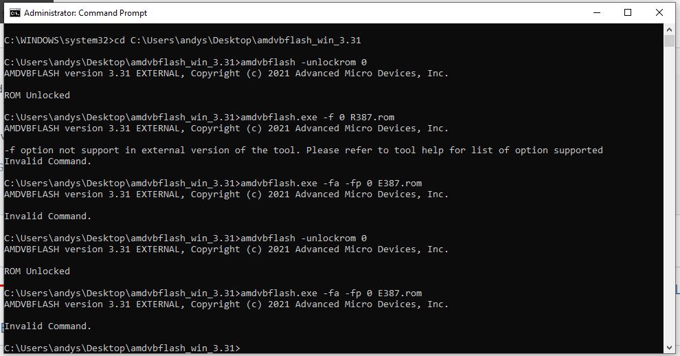

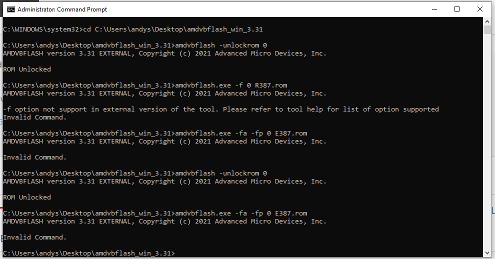

So I should have been using amdvbflash instead of amdvbflashWin, but sill having problems...
