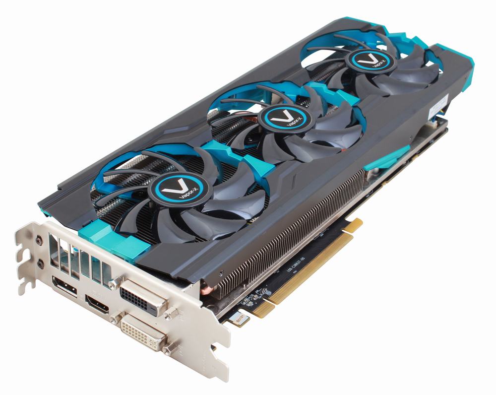

if i'm right you have sapphire vapor x blue black model with three fans, i have had flashed it douzen of, you will have two ports: dvi, and displayport activated in mas osx, and it will show amd radeon rç 280x in system, or you can have all 4 ports activated under native rom, but still you can only connect to 2 monitors maximum under mac osx, if you still want to flash it, please send me you rom i will do the flash for you, good luck
this is exactly the card I've spent this days fighting with (SKU 11221-12, Tahiti XTL).
obviously it is a 2nd hand from a gamer PC so I cannot be sure the bios I have is original (it is 015.043.000.006.000000 1100/1500).
My issue is that the card power-on on start and then power-off after the OS/driver is loaded (both original Rom and efi 280X) on DVI port I'm using; then if I unplug and plug in the cable, the card it power-on again and works quite well; just the open CL scores seems low and in Sys info PCI section the 2nd Hamachi entry states driver non installed.
But it is simply no feasible to do it this way on regular basis.
I've spent hours reading without finding the solution for the power-off, at this point I believe better ask for help here.
If somebody can provide a genuine ROM for this card, I'll really appreciate (on my risk; I flashed already about 10 Roms from Techpower, all of them working on old Windows PC, few on MP 5.1).
Thanks

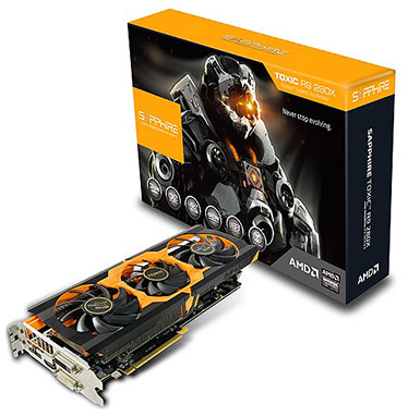

Hi everybody, I am new to these forums. I have one question about the card I got for my Mac Pro.
It's a Radeon Sapphire Toxic R9 280x 3 Gb
My Mac Pro is a 2009 - 4,1 flashed to 5,1
I want to use the card with 3 monitors, 23", 24" and 30", in OS X and in Bootcamp Windows 10.
I did have a red Sapphire HD 7970, that did this. (it died)
I understand that I can flash the R9 280x card to get a boot screen.
But frankly this is beyond me, I've read all the Netkas pages etc and I just don't have enough coding knowledge, or a PC to do this.
So here's the question:
From the reading I've done and the info at -
http://blog.greggant.com/posts/2018/05/07/definitive-mac-pro-upgrade-guide.html
I understand that I can put the card in the Mac 5,1 and though it won't show a boot screen, it will still boot to OS X.
And if I use 'startup disk' to choose Windows, then it'll boot to Windows (bootcamp) and then the bootcamp control panel to get back to OS X.
Is this correct?
And I could also use Boot Runner from https://twocanoes.com/products/mac/boot-runner/ if I choose to.
Any help or comments gratefully received.
Please see the image attached, for the card's pic

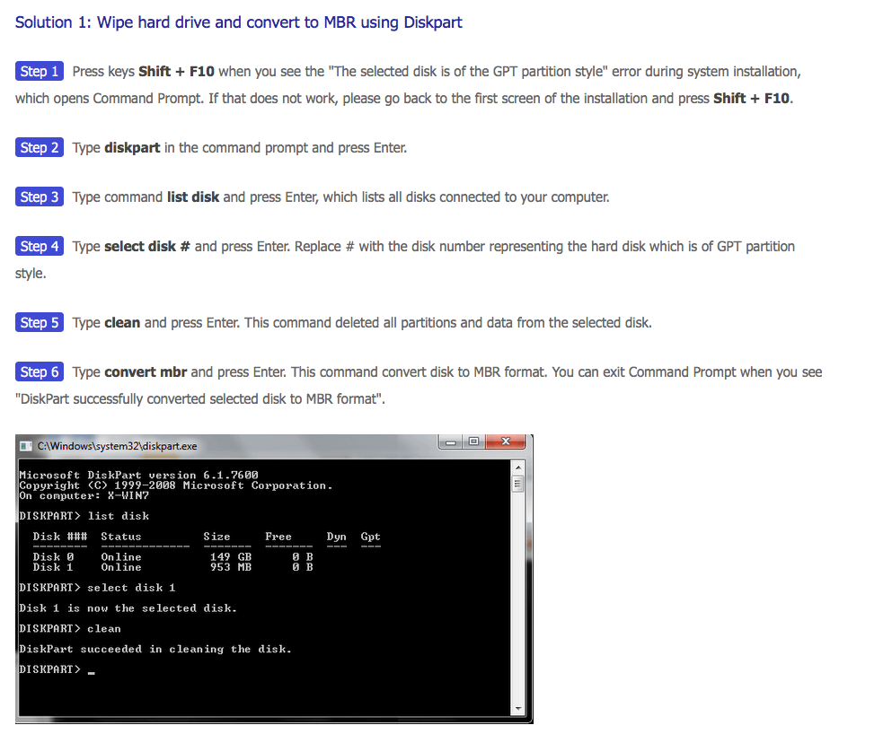

pic for converting to MBR in Win installer:
Then continue the install in the "unallocated space" that is the right disk and size - as the desired disk.
