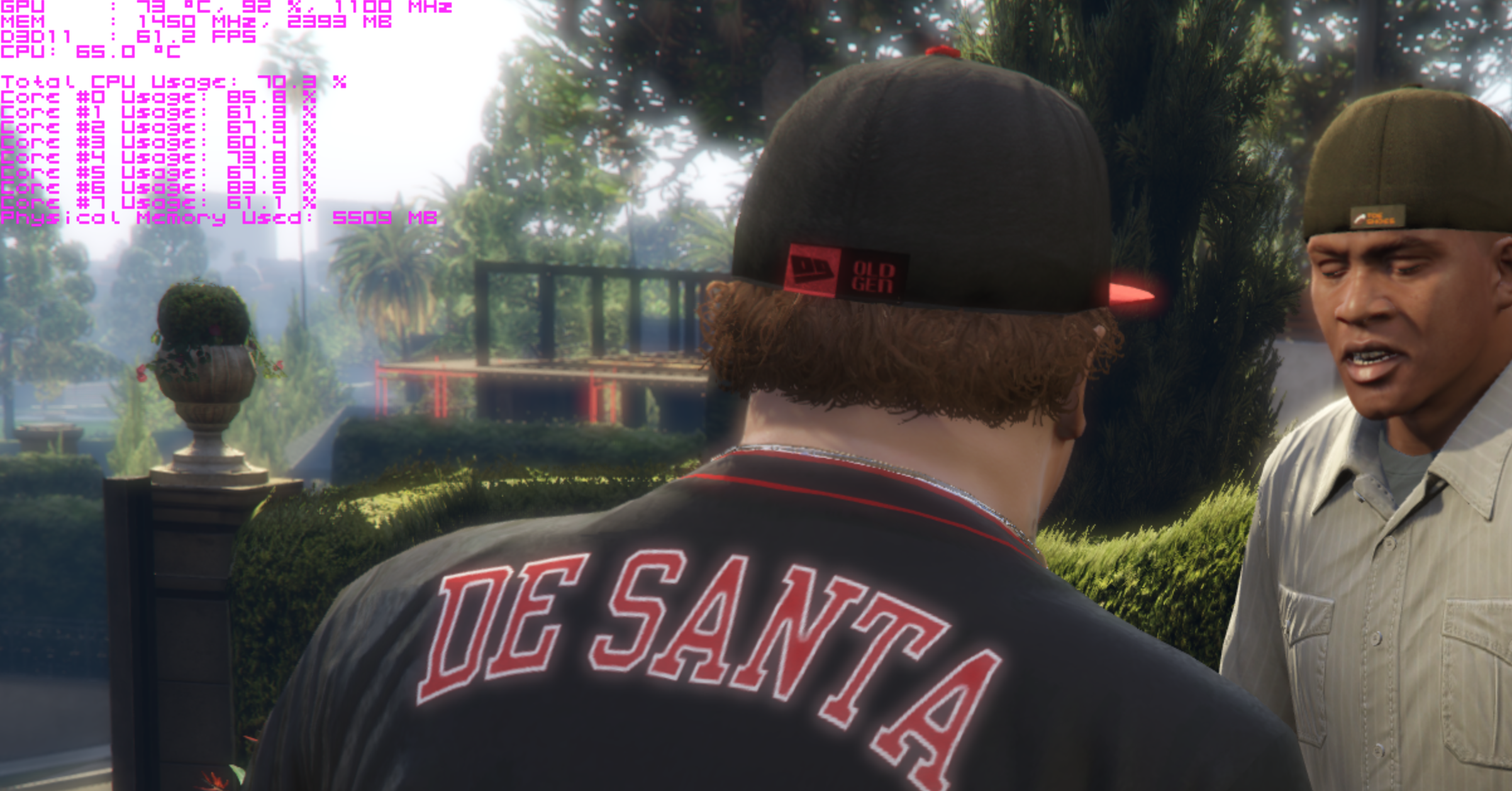

Alright, to everybody saying games cannot use more than 4 cores: what about this thread and the screenshots?
https://steamcommunity.com/app/271590/discussions/0/611703709830099660/?l=german
Plenty of people state there that their rig is using all 8 cores in e.g. GTA 5 and I guess the screenshot below supports this claim, no?

It seems the others said "very few apps", or "rare"... but not "never" or "games cannot"...and OP didn't mention GTA V in his post.
Anyway, the good thing is more and more games optimised for multi thread. So more CPU or more cores may help for some very very new AAA games. However, in general, it won't help at this moment, multi CPU config sometimes may even cause slightly performance degradation.
h9826790 is right, the most important thing is if the games you play will use more than say 4 cores (as thats what the OP has).
Id relay check to see if your copy of windows can see both CPU's as that might actually help a lot if your only using 1 cpu (even if the game can only use 2 cores it lets the OS and background tasks live on the second cpu)
