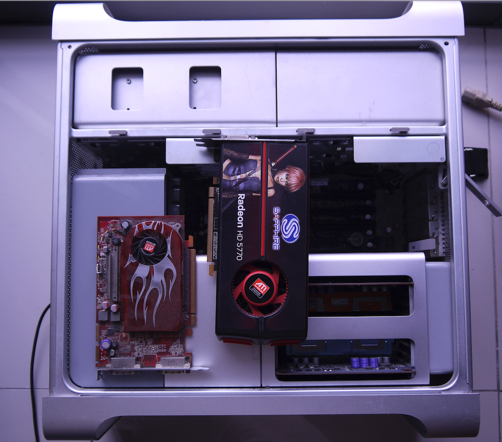

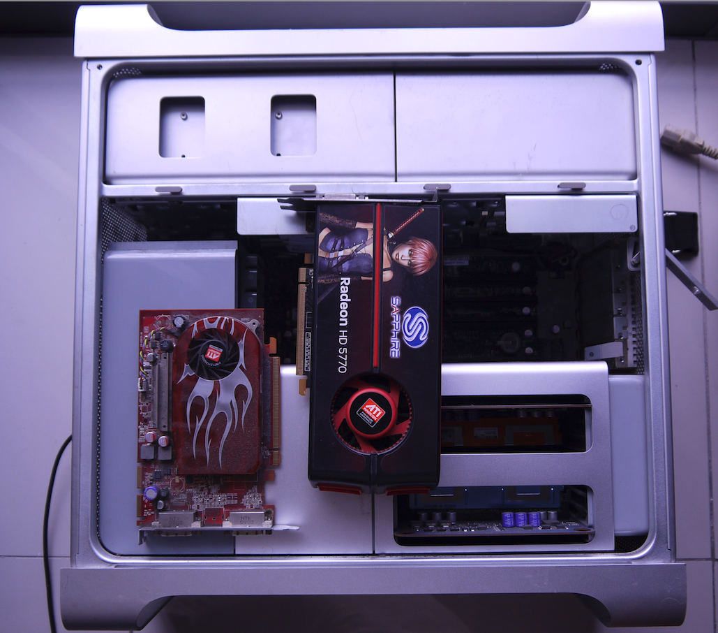

Hi guys, would like to ask if the Sapphire Radeon 5770 would work on the Mac Pro 3,1 or there are versions of the 5770which do not work in a Mac pro 3,1. No Visual at all.
I must also state that since i did not the power cable for the 5770, i power it externally, hope this is not an issue.
I did try the 5770, power it externally and successfully boot in a hackintosh. Any advice would be appreciated.

Hi, thanks.
I do not have the power cable at this point of time, hence the external power.
Could it be that the 5770 is not recognised because the 6pin port has no connection to the 5770 ? I do not have any other card attached.

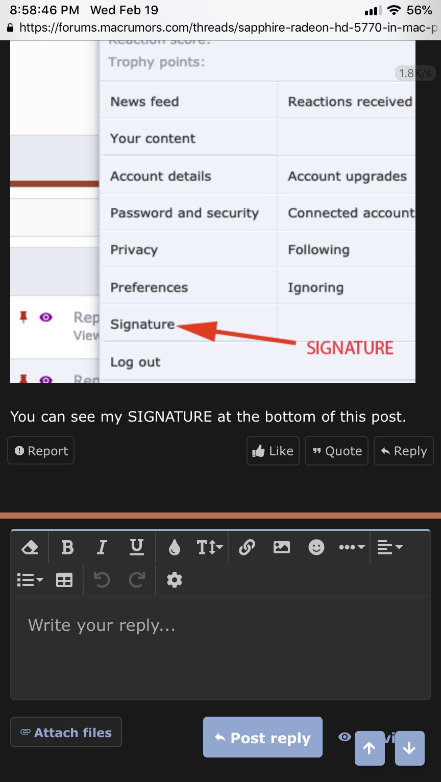

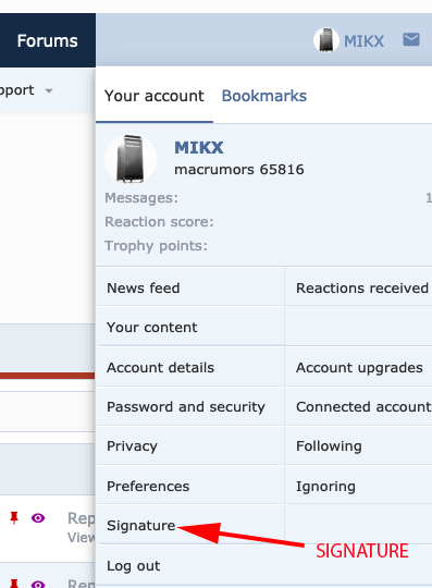

When asking for help in Macrumors it's good to have a "SIGNATURE" you can make a SIGNATURE to describe your Mac Pro.
Go to your Macrumors member profile & type in everything to describe your 3,1 Mac Pro
You can see my SIGNATURE at the bottom of this post.

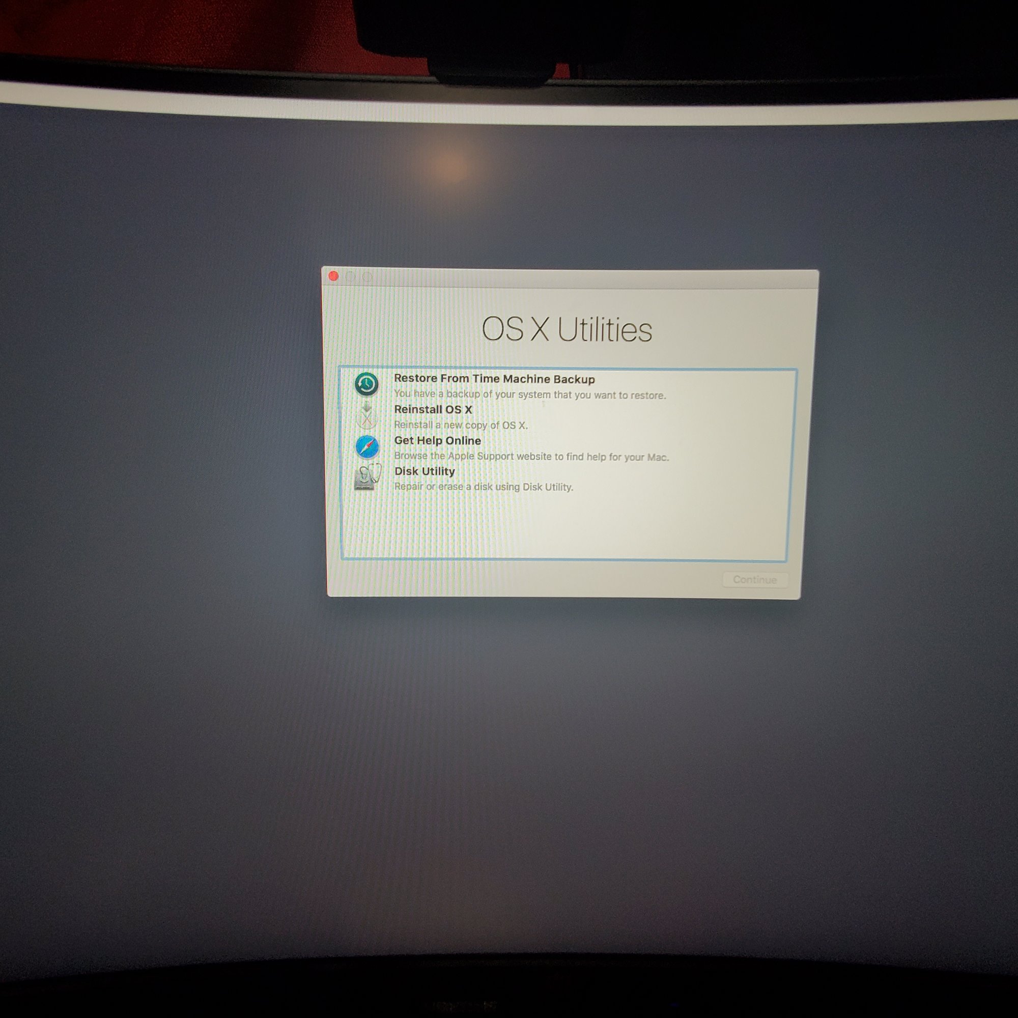

Hi im install my 5770 vapor saphire on my mp 3.1. boot on high sierra but i dont see the boot screen to select bootcamp or other os. If the screen shutdown for inactivity the screen dont turn on again.
I tried flash but when i excecute the comand line return a error :
dd: bs must be between 1 and 9223372036854775807
I dont know what im doing wrong.
QUESTION : Have you read EVERY page in this thread ( as I did ) on the Netkas site ?
NOTE : Easiest way to install the EFI rom is by first installing Widows 7 ( or WIN 10) or it's own HDD / SSD on your Mac Pro. then install ATIflash & GPU-Z
To boot from Win 7 or Win 10 select it in "Startup disk in your Mac pro Preferences.
What procedure did you use ( details ) to flash the 5770?
Have you dumped the ORIGINAL 5770 ROM and saved it with an appropriate name EG : " ORIGINAL SapphireVaporX-ROM.ROM" ?

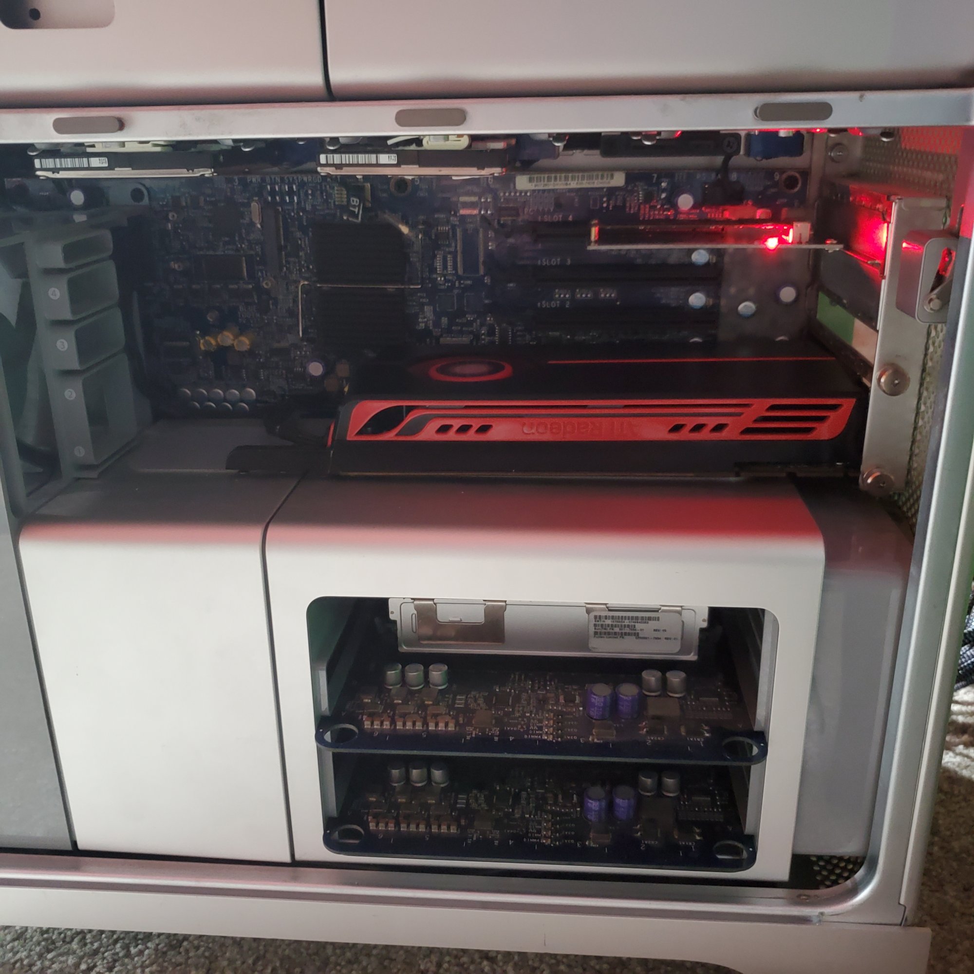

Which GPU Power able are you using for the 5770 ( photo ) ?

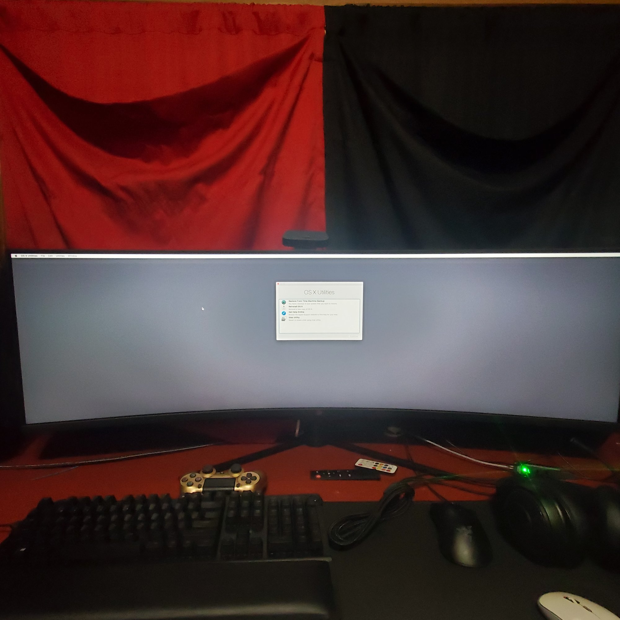

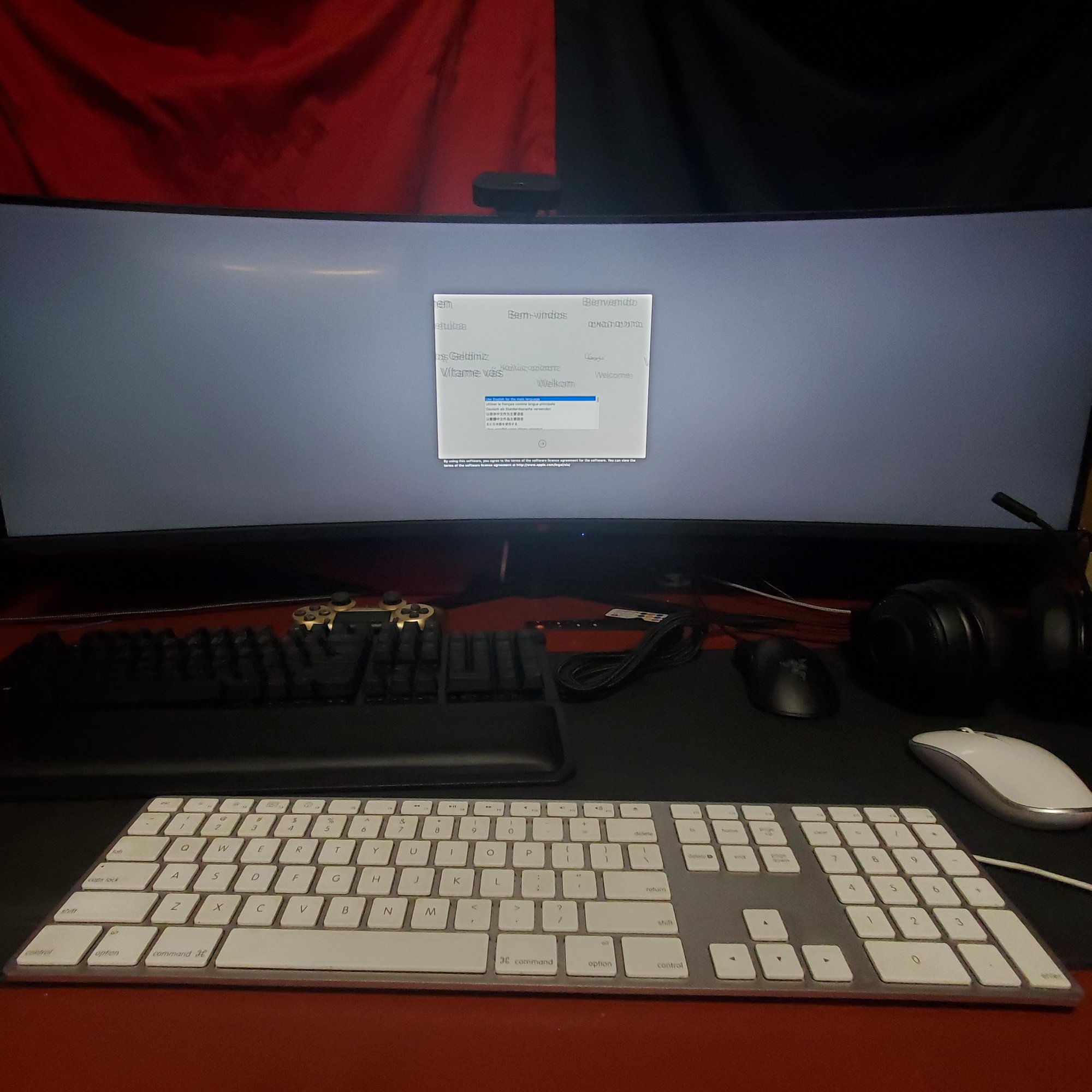

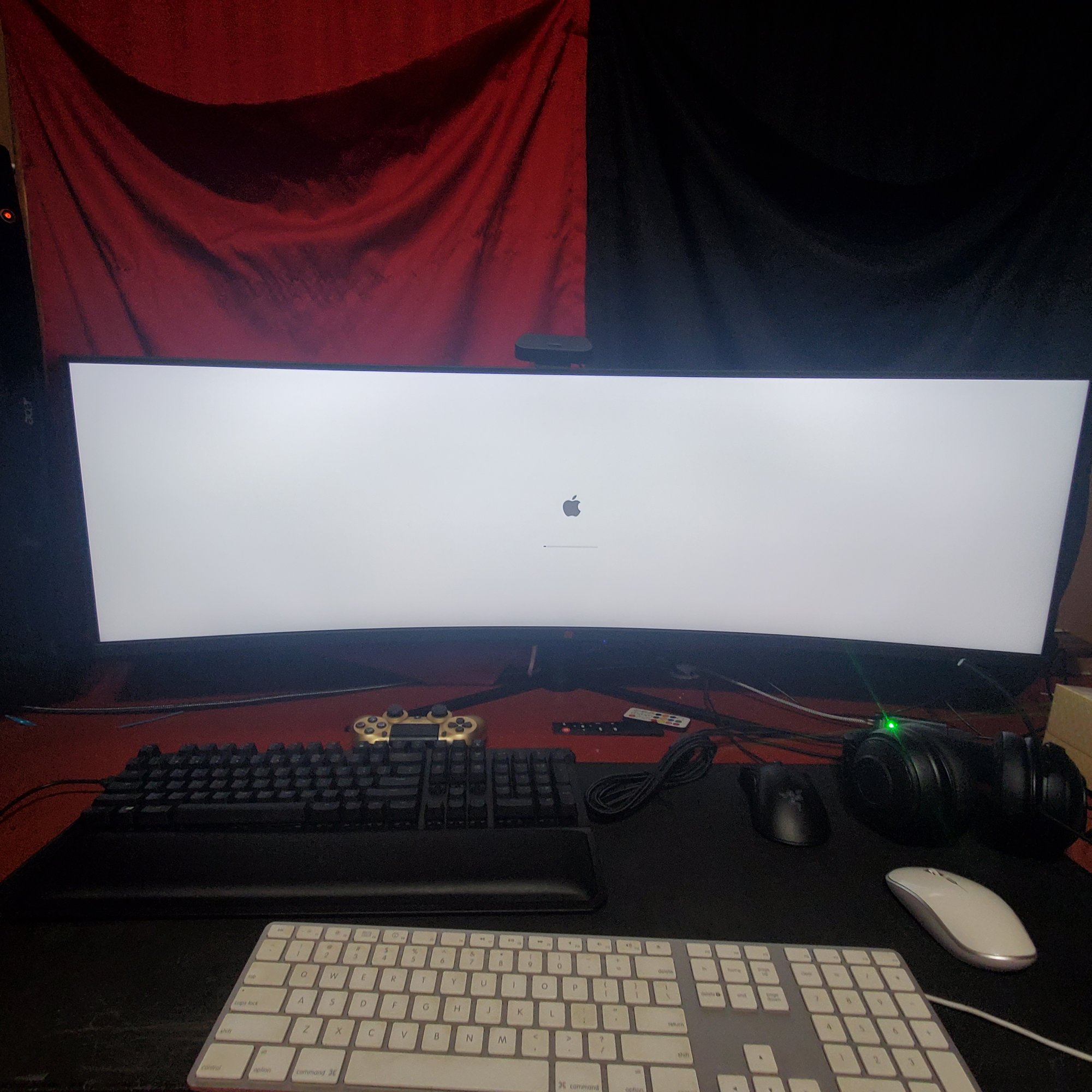

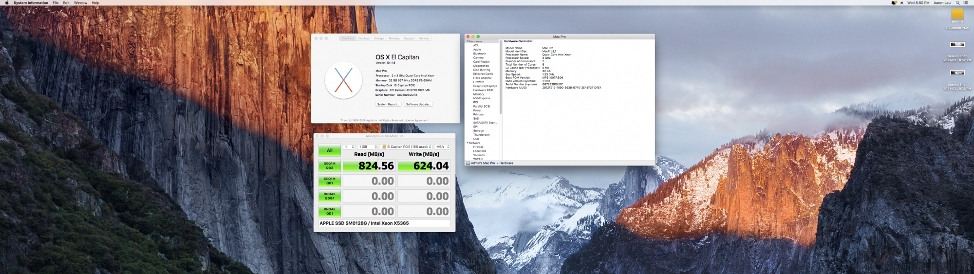

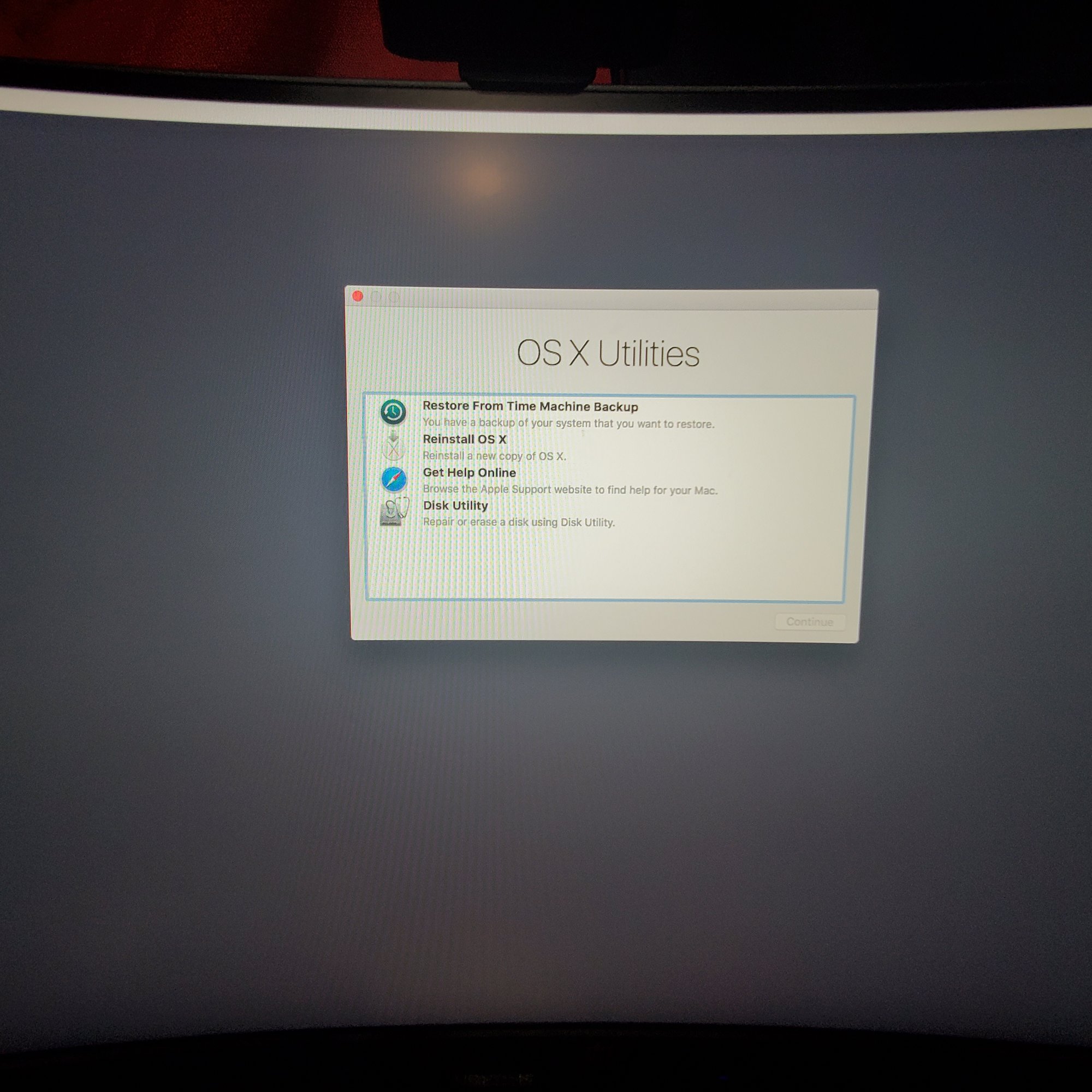

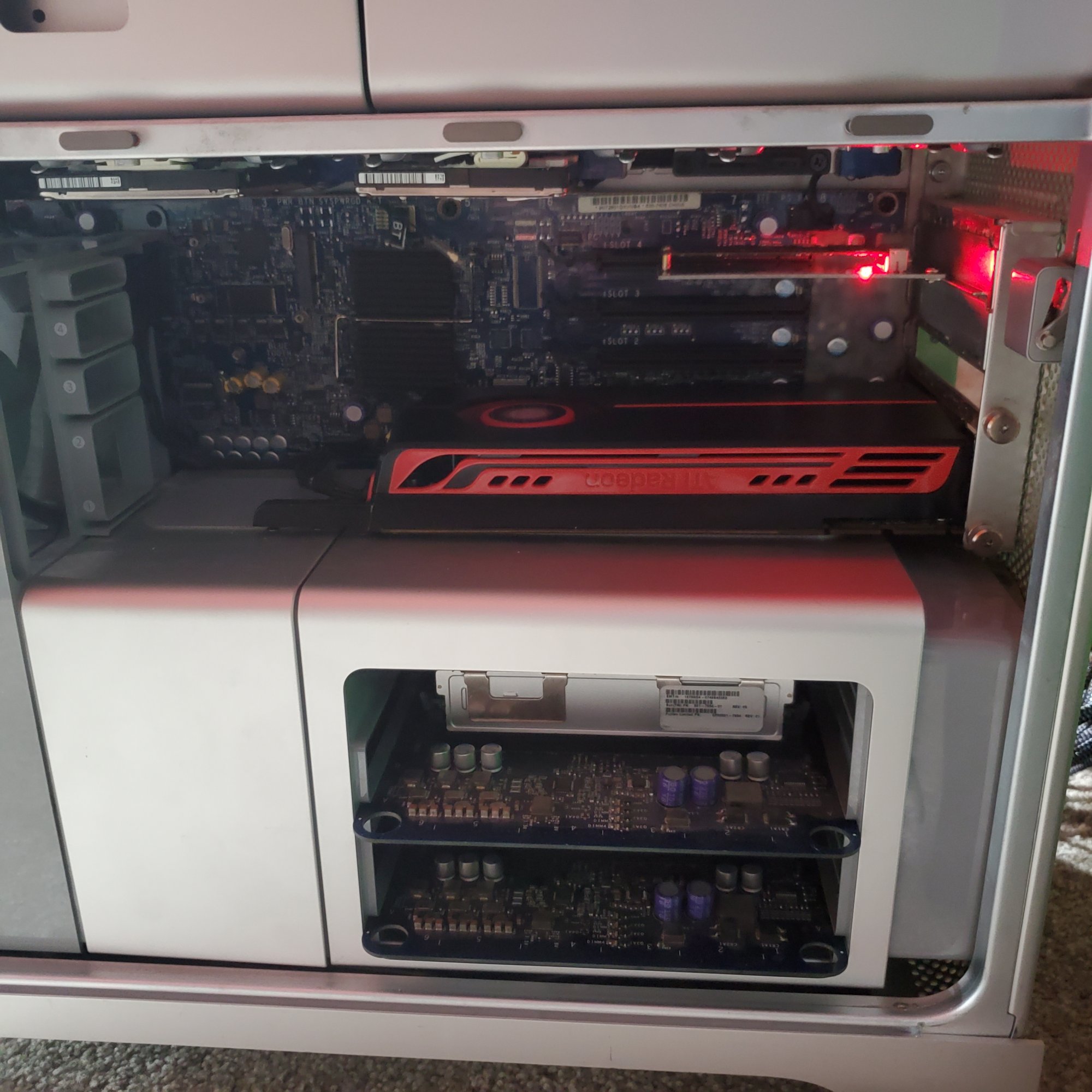

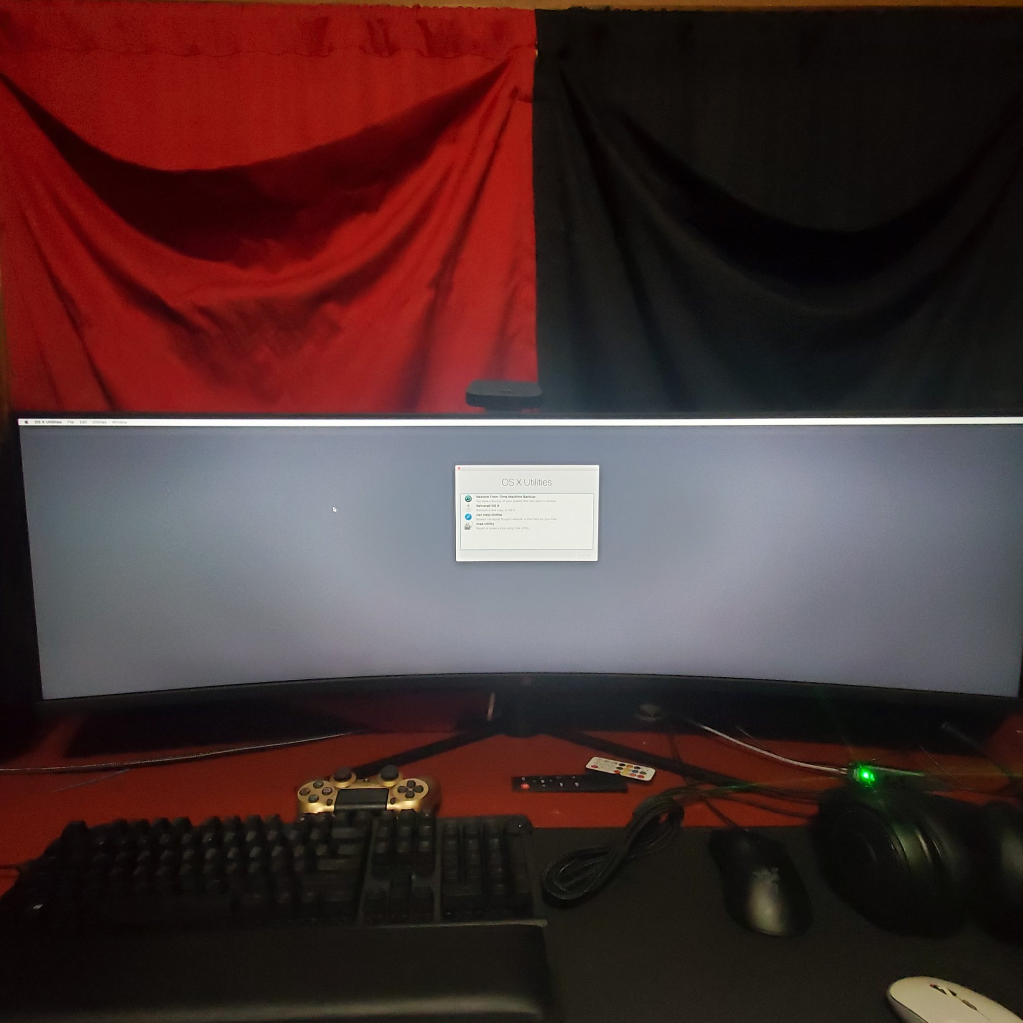

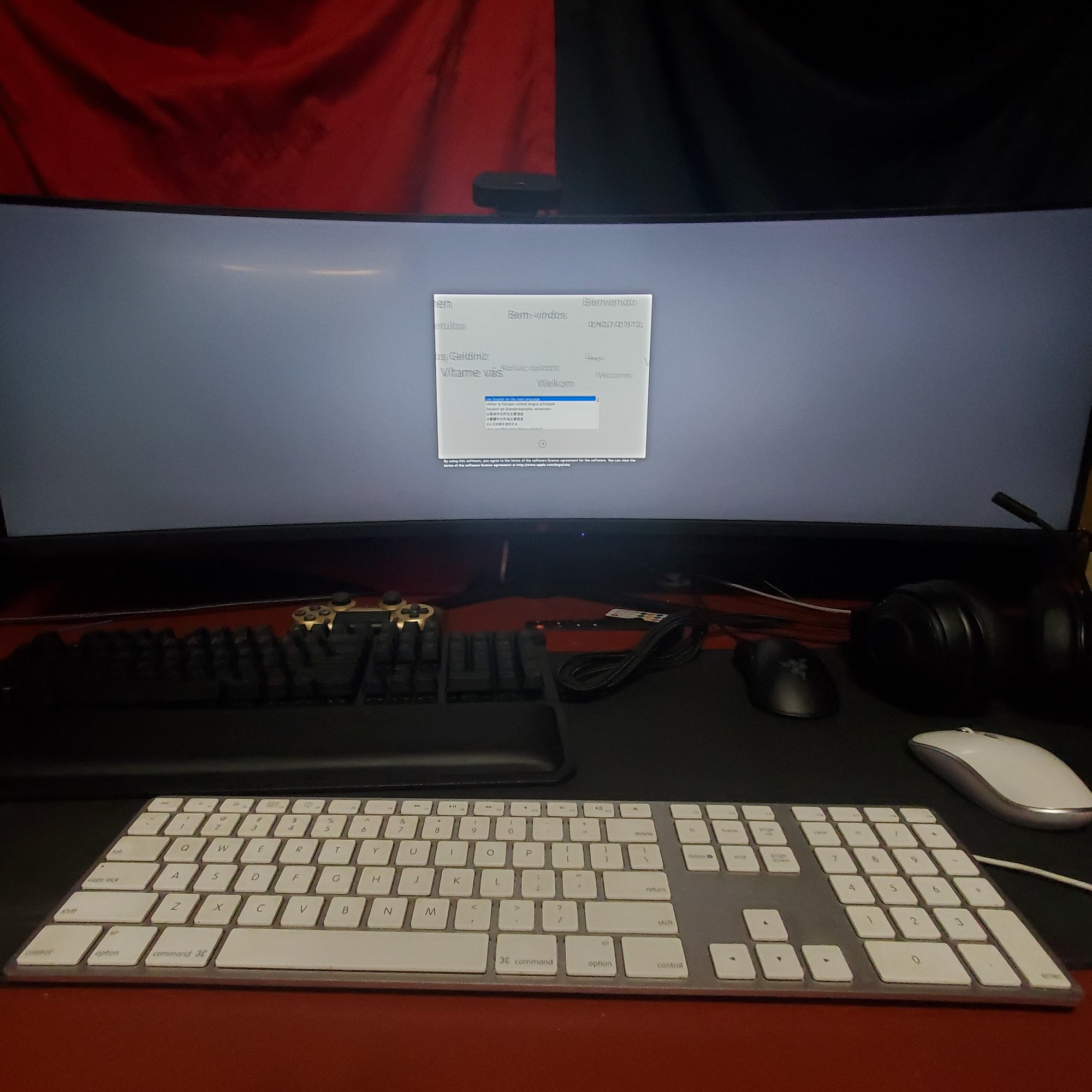

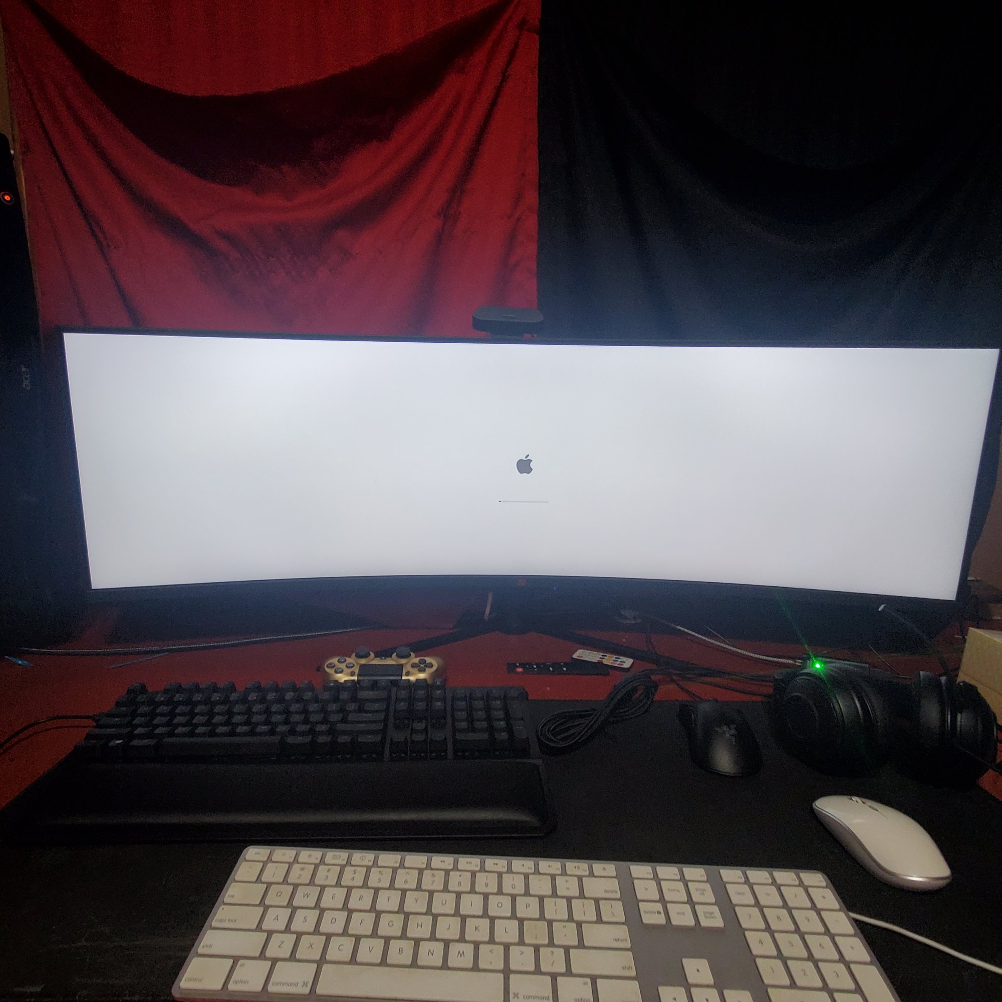

why do you need 2 cards on MP3.1 since HD 5770 can provide bootscreen and run perfectly on MP3.1 up to SH OS. Doinng this will draw lot of power and create even more heat inside your unit. i Have a MP1.1 flashed EFI and SMC of MP2.1. everything was running perfectly with my flashed HD5770 card. i got apple boot screen, booted thru pcie SSD (as external boot drive) with 6GB+/s. and the card provided 3 output sources, 49" ultrawide on 4k resolution and 2 27" LED monitor as 2nd and 3rd. I think just the HD5770 is enough for your system. 2 cards will add up 300W at least just for the GPUs, unless you want to grill some bbq inside your MP and blow the PSU.

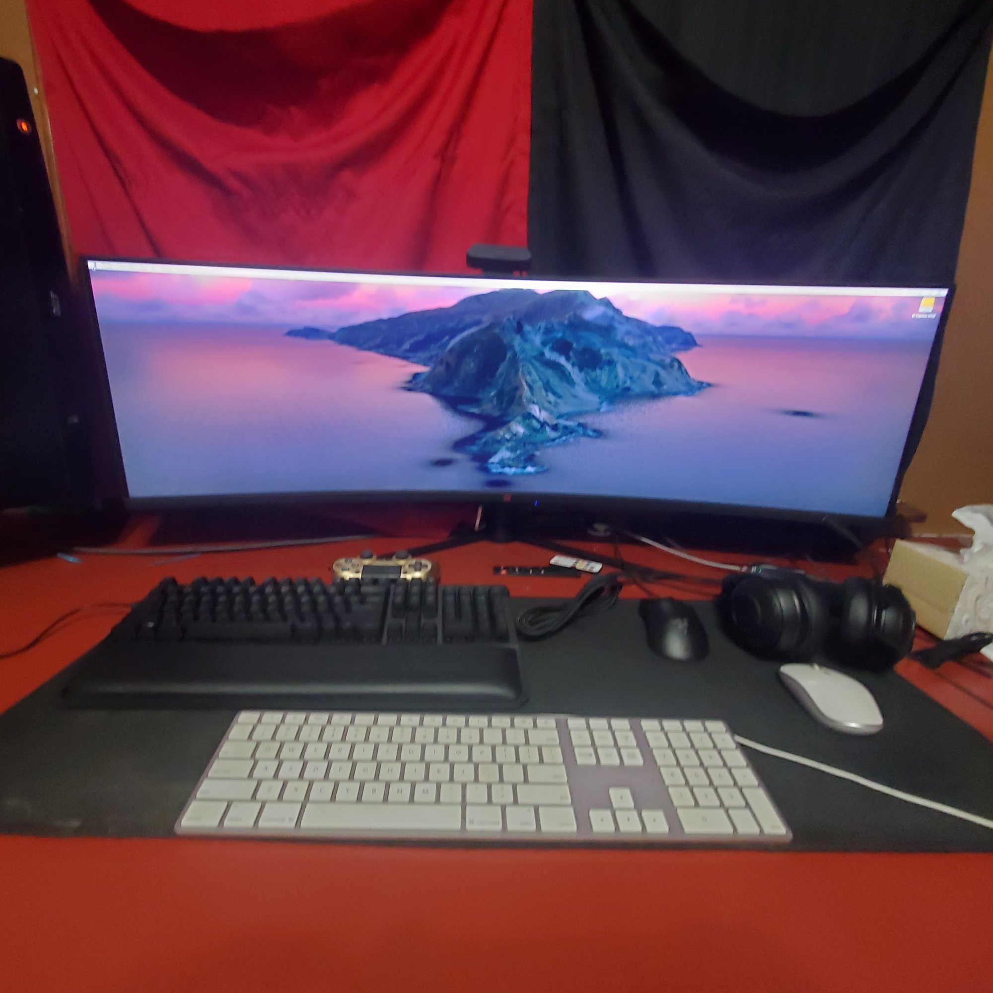

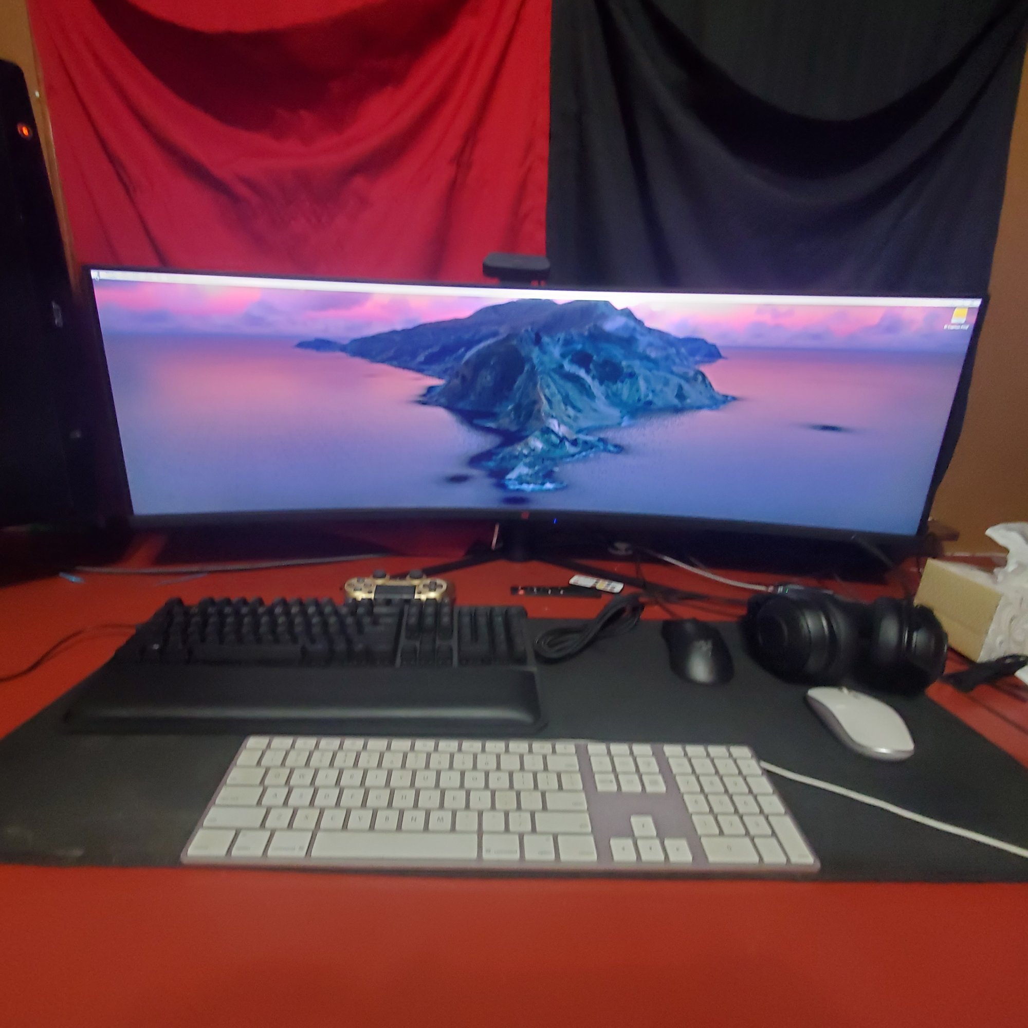

I run the main monitor on 49" 3840x1080 beside 2 1920x1080. I also tested with my other 43" on 3840x1600 without a problem. You need to run main monitor with DP tho. For 1720 resolution i believed you need to connect with dvi or else it won't detect and gives you either 1440, 1600 or 1920.

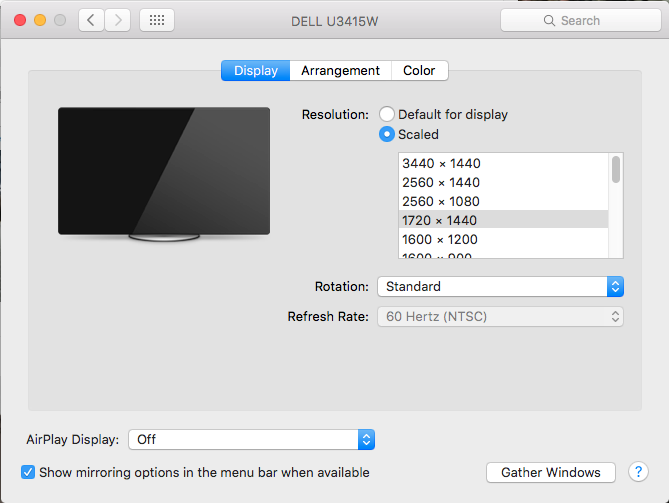

Maybe not detecting but, with holding the option key pressed when selecting scaled resolutions? See included screenshot.
The 5770 has 2 mini displayports so i thought to just use the xiaomi picture by picture option to use it as 2 seperate monitors. I'm not gonna use more monitors.
Thanks for your reply!
I see what you meant now. So you are trying to use the 3440 in split mode. Btw i forgot to mention that i didn't flash the card with 5770 rom. I flashed with 5870 rom, 1st flash failed, 2nd flash succeed and my card was amd radeon 5770 black and red stripe.
