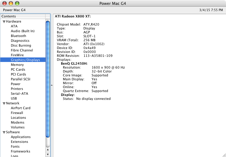

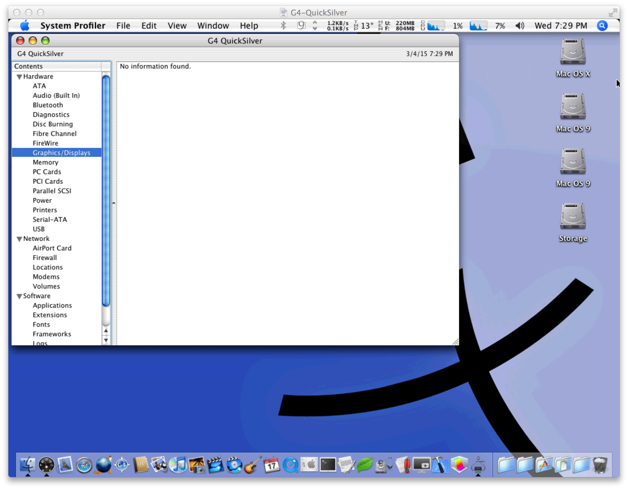

BTW, this is what happens with the card in my QuickSilver. Gonna try the MDD now.

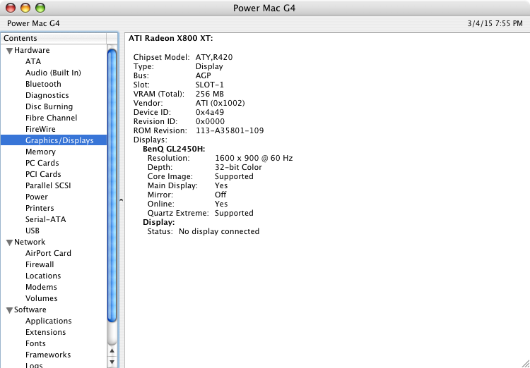

OH. MY. GOD.
It worked! ATI Multi Flasher in my MDD... I can't believe it! YEAH!!!
But holy cow, it runs hot!! WAY hotter than in my PC.
Have to sort out Leopard now 🙂

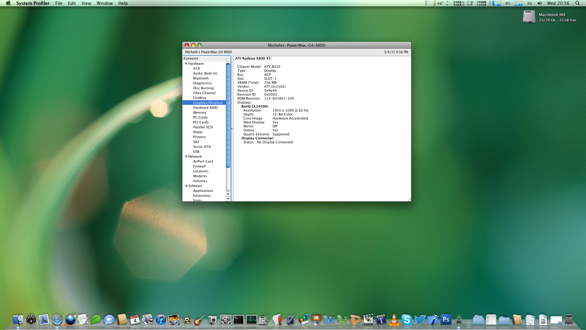

BTW, I'm actually the happiest man on the world today. I'm so glad I got this X800 working in my MDD. Performance is just INSANE. I'll be doing an OpenGL benchmark and Halo Time Demo soon.
Thank you!
