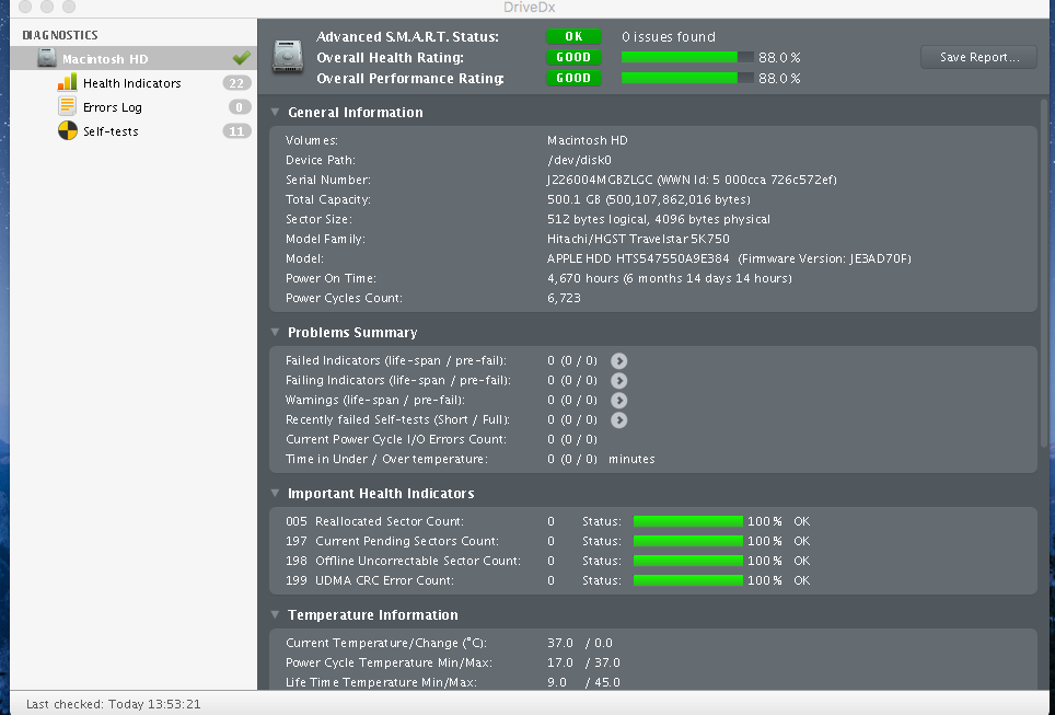

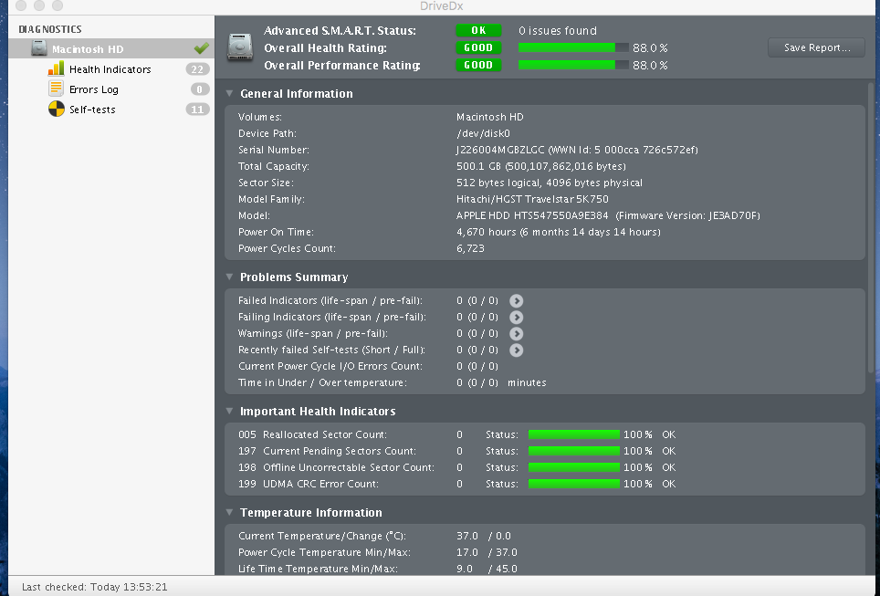

Do any of you use the DriveDX app? I might get some (offline) help this weekend. I just need to know what I am looking at. When I got to go to the apple store. I had a bracket replaced without a new cable that connects it to where it goes.
Do any of you use the DriveDX app? I might get some (offline) help this weekend. I just need to know what I am looking at. When I got to go to the apple store. I had a bracket replaced without a new cable that connects it to where it goes.View attachment 673639
