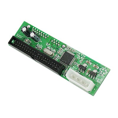

Here's a pic of the type of PATA-SATA adapter I'm using. I haven't seen any that I think would be a better fit.
I have an adapter that looks exactly like that and I hate it. Any computer I use it with has problems booting, and when they can (which will be random), they are SLOW. It could be that mine is faulty, but it came from China and was extremely cheap (and it shows).
One other annoyance I really have with it is that the molex power connector on it is extremely tight and the male end always get stuck. Every time. And it takes nearly the amount of force required to break the controller just to pull the molex out.
My two cents: I do NOT recommend that controller.
Do a search for a JMicron IDE to SATA adapter. I bought one for around $6 on eBay for my Cube and it works VERY well and is much smaller. No complaints whatsoever. You can get them in Master or Slave configurations.

Wanted to report that the ATA-SATA worked great! I needed to cut away part of the tray holding the drive in order for it to fit but I just secured that side with a zip tie since I'd cut out the area where it screws down to the metal chassis holding the logicboard. I screwed up and bought slave rather than master adapters but they worked fine. I did two eMacs but one had been damaged when it was shipped to me so I gave up on that one. I installed 10.4 on the other with no problems and it seems to be running great. I used a spare hitachi 7200 RPM 1 TB drive.
