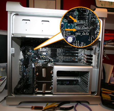

That's the label used on the logic board itself. 😱
Also, search the forum, as this is the label used in threads, and a few members have even uploaded images, and the label can be read. Easier than opening your own, and having to locate them. 😉
The additional ports were available on the specific SATA Controller chip used (i.e. Marvel), and were likely installed for the eventual switch from IDE/PATA to SATA optical drives. The second part of this statement is a guess, but is logical at any rate, and it does make life a bit more convenient for Mac Pro owners. 🙂

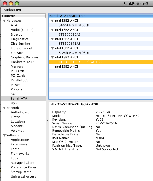

As far as I know the two additional SATA ports on the motherboard were never intended to be used with anything. So calling them ODD ports is incorrect. Unless you can provide documentation they are just SATA ports and nothing more.
As stated by nanofrog ODD_SATA is what Apple calls the ports and they are ready for use. Six SATA ports on the motherboard all Intel ESB2 AHCI as shown:
