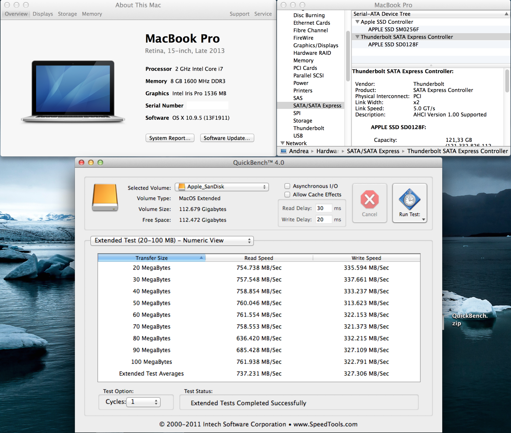

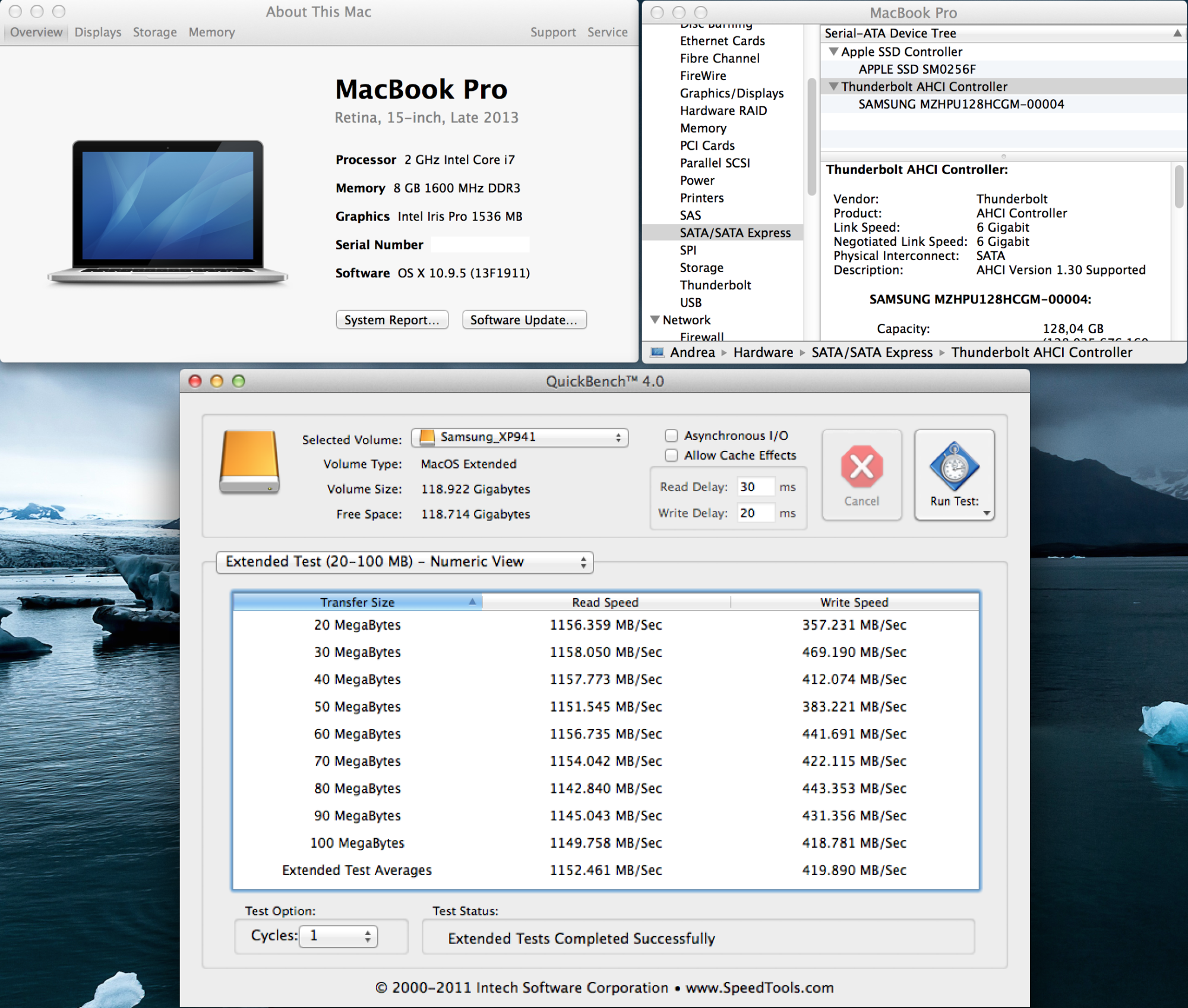

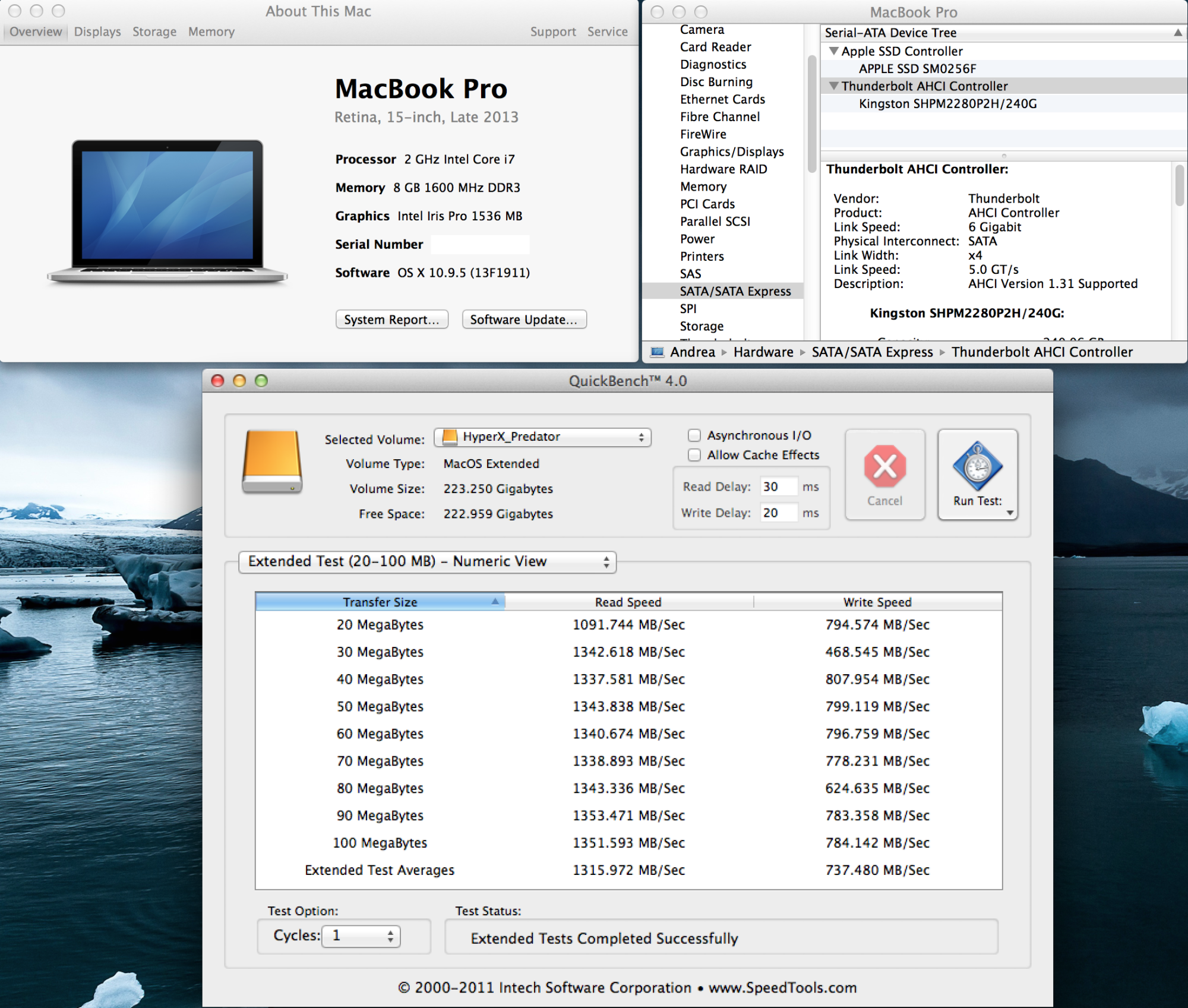

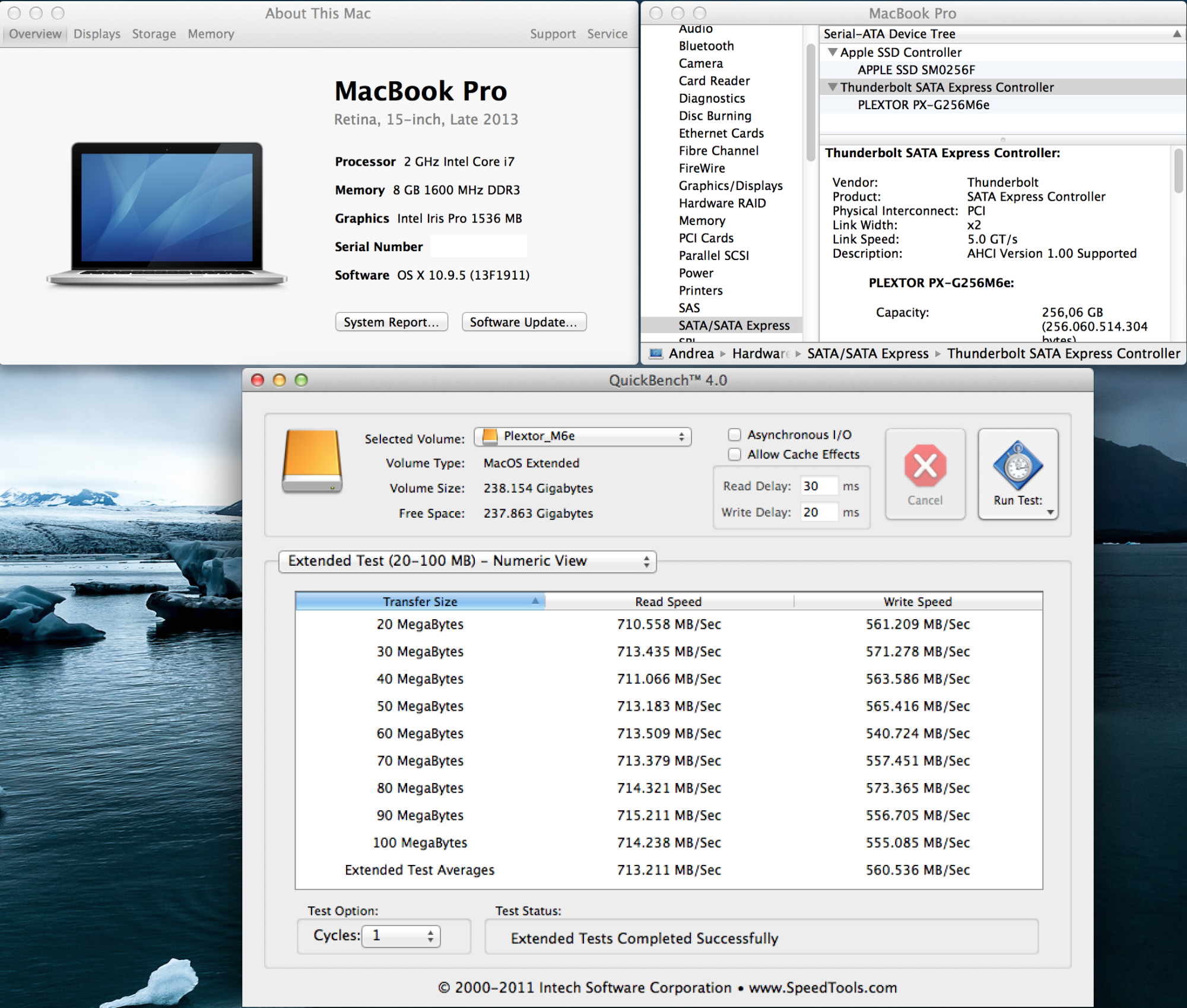

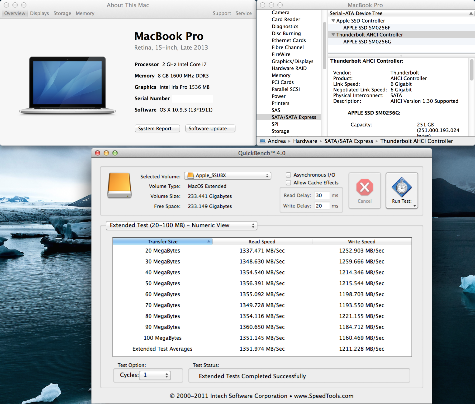

What about some numbers?
BladeMacOS XPCIeBootableUserBenchmark
Apple SSUBX 256GB2011 MacBook Pro10.6.82.0 ×4 (TB 1)yesAmethyst1click me
Apple SSUBX 1024GB2010 Mac Pro10.10.x2.0 ×4?Bare Featsclick me
Lite-On EP1 480GB2013 Mac Pro11.x2.0 ×4 (TB 2)?Lance Nanekclick me
Samsung SM951 512GB2009 Mac Pro10.5.82.0 ×4?MrCheetoclick me
Samsung SM951 512GB2010 Mac Pro10.10.x2.0 ×4yesBare Featsclick me
Samsung XP941 512GB2010 Mac Pro10.9.x2.0 ×4yesBare Featsclick me

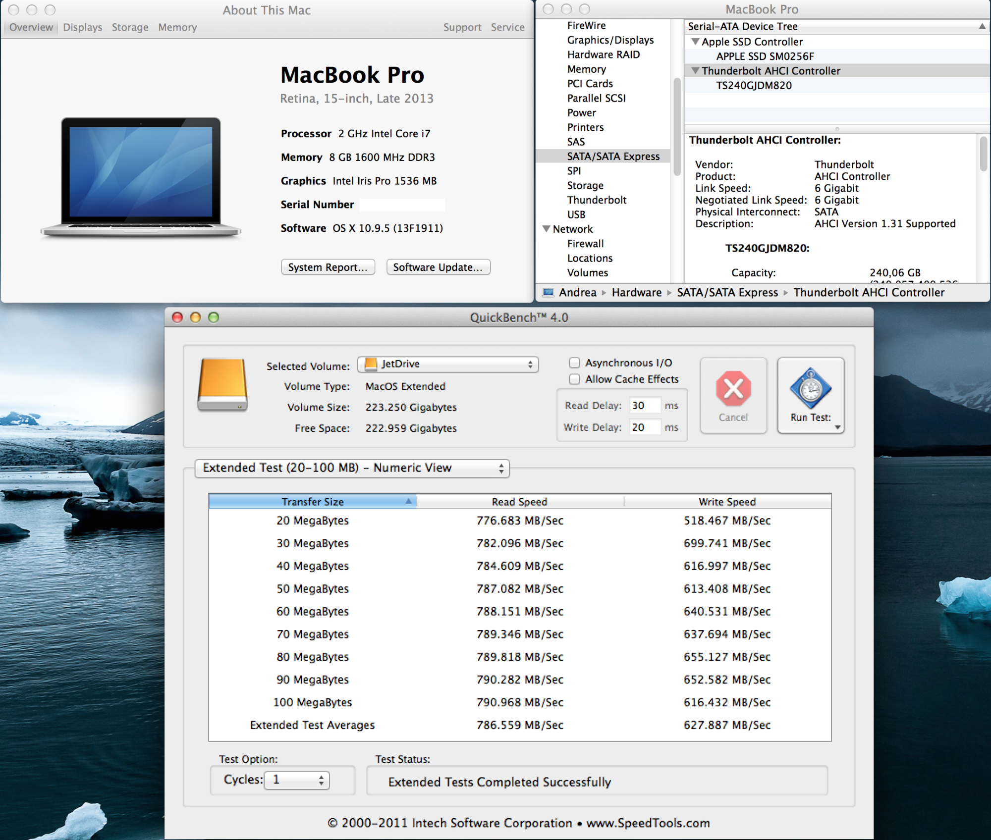

Let's see some AHCI PCIe SSD blades flexing their muscles in Early Intel Macs!
SSDMacOS XHost PCIe InterfaceUserBenchmark
Apple SSUBX 256GB2011 MacBook Pro10.6.82.0 ×4 via Thunderbolt 1Amethyst1click me
Samsung SM951 512GB2009 Mac Pro10.5.82.0 ×4MrCheetoclick me

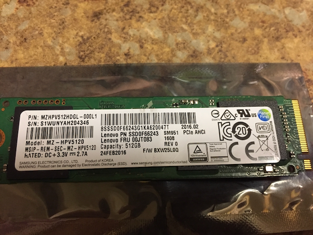

I have a (Lenovo MZHPV512MDGL-000L1) 512GB SM951 AHCI that I successfully used in my 2012 MP5,1 a few years ago (and another 'new' one that's never been initialised sitting on a shelf somewhere).
Main reason I switched to nvme was for greater capacity, but having native boot added really incentivized the transition ;)

    • Marvell's controllers are all named 88SSxxxx: first four letters omitted in the table.
  • I was also going to add benchmark results for an Apple/Toshiba SRIUP blade but it was DOA, so... here's results from my other blades because I can, all via Thunderbolt 2 so we're talking PCIe 2.0 ×4 or ×2 depending on the blade.
Apple SDNEP / SanDisk A110 128GB PCIe 2.0 ×2: two lanes and 128GB so it's slow, but System Profiler gets it right:
Apple SSUBX / Samsung SM951 256GB PCIe 3.0 ×4: we already have a winner, but note the link speed. System Profiler, get a clue.
Kingston HyperX Predator 240GB PCIe 2.0 ×4: a good second place, but System Profiler can't make up its mind.
Plextor M6e 256GB PCIe 2.0 ×2: faster than the SanDisk but same controller and two-lane limit. System Profiler gets it right again.
Samsung XP941 128GB PCIe 2.0 ×4: write speeds are low due to capacity but read speeds are a sign of things to come. System Profiler:
Samsung SM951 256GB PCIe 3.0 ×4: another winner (and it's not System Profiler).
Transcend JetDrive 820 240GB PCIe 3.0 ×2: two-lane limit hurts, but curiously it uses a Phison E8 NVMe controller, so they must have whipped up a custom firmware to make it talk AHCI. (What are you talking about, System Profiler?)
